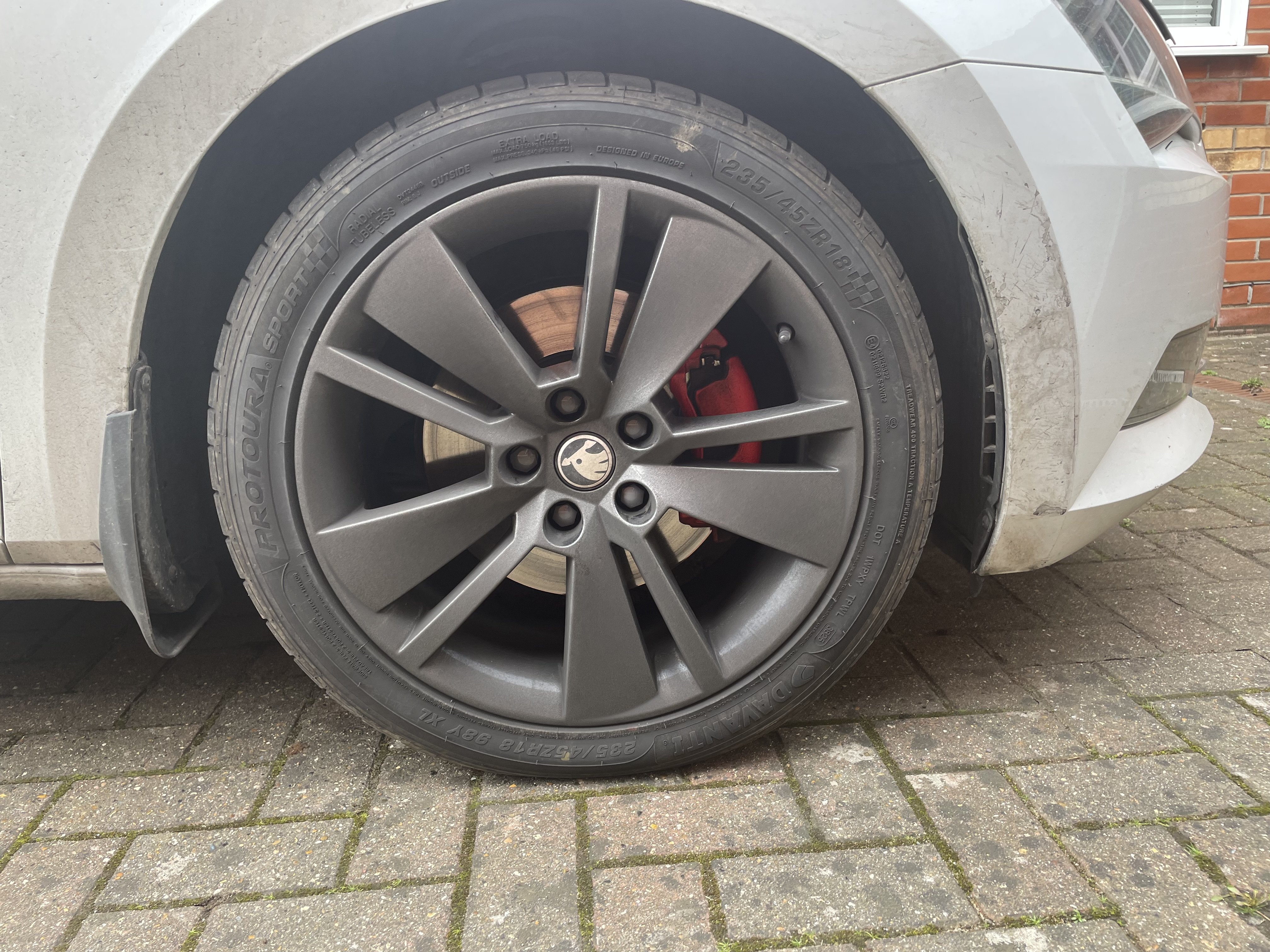

  9. Go for the dark wheels. You know it’s right choice…

  23. Fitted the wheel nut caps today and looks much smarter. I feel a bit lost without pending deliveries and parts to fit. Roll on payday to order the brakes. Also need to change the rear pads on my wife’s Kodiaq.
