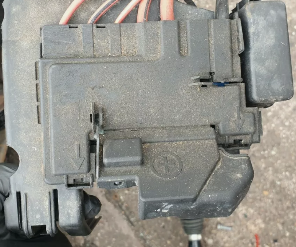

Battery fuse lid
Hi Guys, I went check my oil yesterday and noticed that the lid that covers the fuses on the battery has gone. I have searched eBay and can't find one. Does anyone know the correct name for it or part number. It looks like this below. Thanks
