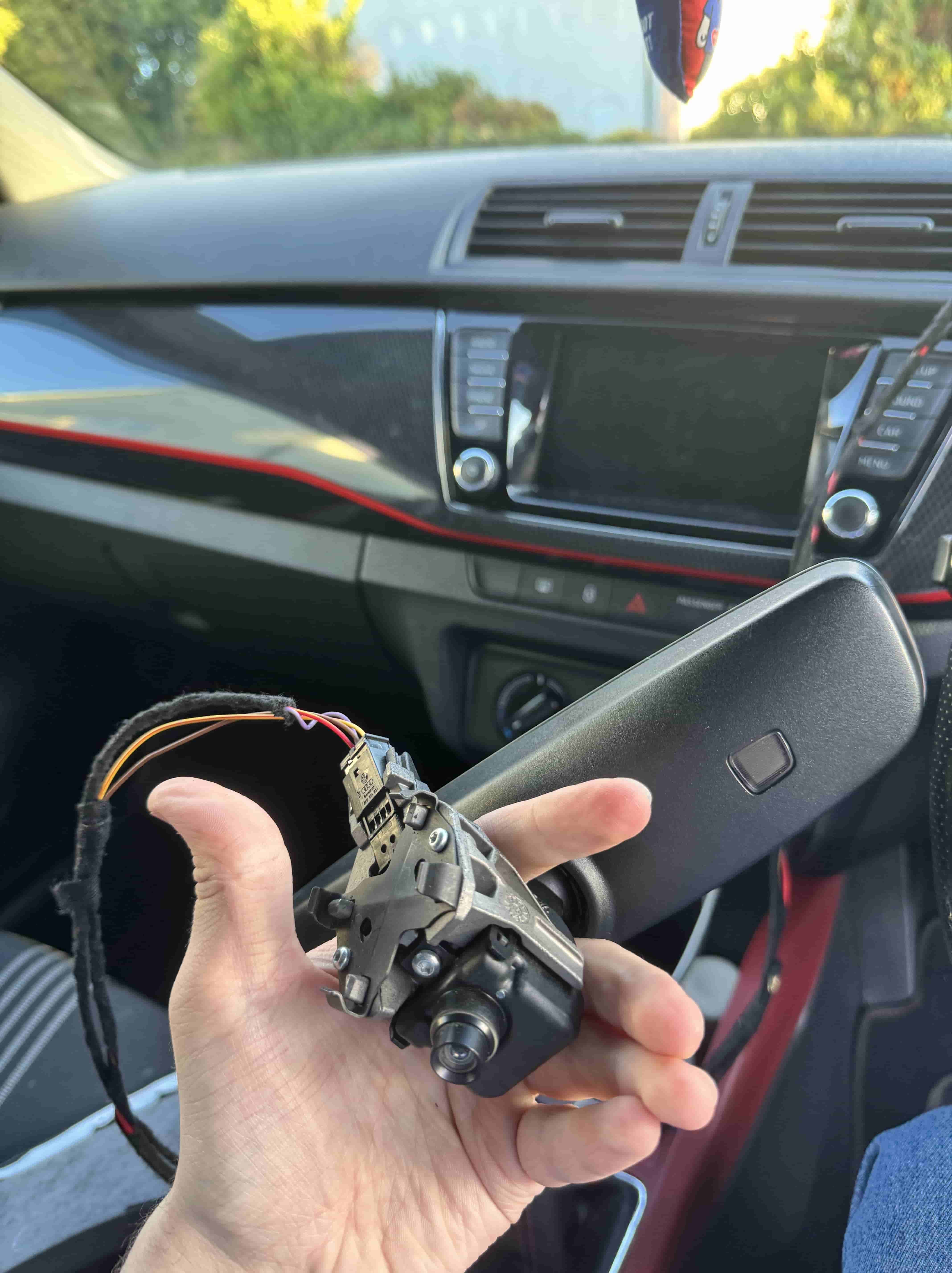

Ahhh im glad it worked for you! Maybe I got a dodgy harness. I also have a hi-lo behind the unit but just about managed to squeeze in the harness. I’m glad I fit the OEM camera though, as the built in washer is very handy in the winter months

I did actually try this camera once before, Was an easy install given the custom harness and wire (although, very little space behind the headunit for it to fit). But I found that for some reason it prevented my USB for apple carplay from working. Did this happen to you?

Oh sorry!! wish I saw the forum sooner 😅 The one I bought is no longer available but this is the exact same; https://a.aliexpress.com/_Ez7x342 It’s OEM for the windscreen washers, I didn’t care about that and just cut/snipped it to the length I needed! If you don’t have any way of coding, check out the VCDS Map on the forum, People willing to help put their location on so you can ask them if they’re local to you! ☺️ Your page says you’re from West cumbria though? im south cumbria, so if you need a hand give us a shout 👍

The camera I used was 6V0827566, and can be found here; https://a.aliexpress.com/_EGsVXXg it came with the wiring look, and by taking a guess this is an oem kit, i’ve tried other aliexpress rvc’s and the cameras were poor. This one’s really good. Yeh, Coding is necessary to tell the headunit the cameras there, do you have access to OBDEleven/ VAGcom etc?

The Y connector is - 1J0 955 873 D The connections you need are Female: 5J0 955 871 A Male: 5J0 955 871 B I usually buy my parts from LLLParts, They take a while to arrive but they’re cheap and brand new You’ll need 4 of each, But I bought extras just incase I lost/broke some! I tried Aliexpress parts first and just, don’t bother 🤣 The only thing I did use from Aliexpress was the hose itself, It was so much cheaper; I just trimmed it as required, You can tap into the washer line in the C-Pillar on the left hand side
