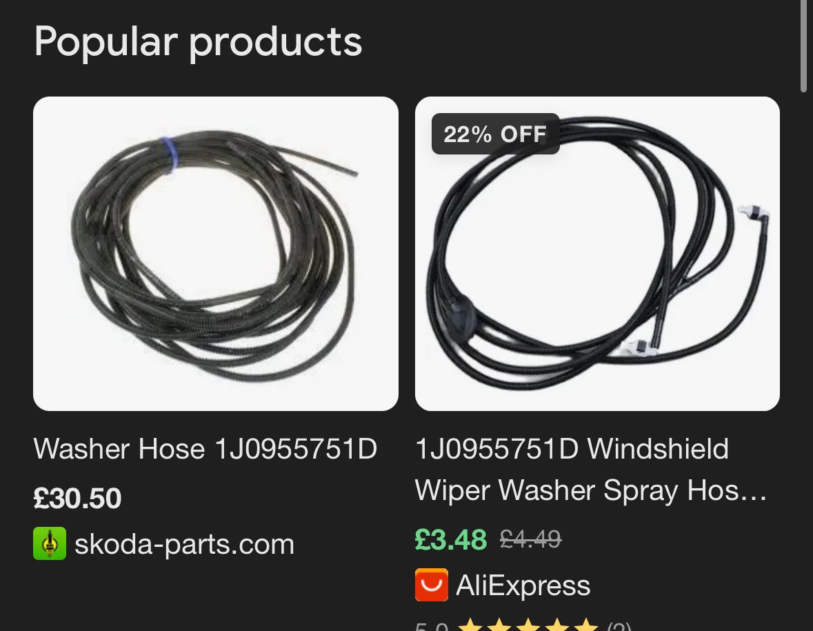

I definitely do need a Y connector for the washer jet,so recommendations would be appreciated.
The Y connector is - 1J0 955 873 D
The connections you need are
Female: 5J0 955 871 A
Male: 5J0 955 871 B
I usually buy my parts from LLLParts, They take a while to arrive but they’re cheap and brand new
You’ll need 4 of each, But I bought extras just incase I lost/broke some! I tried Aliexpress parts first and just, don’t bother 🤣
The only thing I did use from Aliexpress was the hose itself, It was so much cheaper;IMG_0722.jpeg

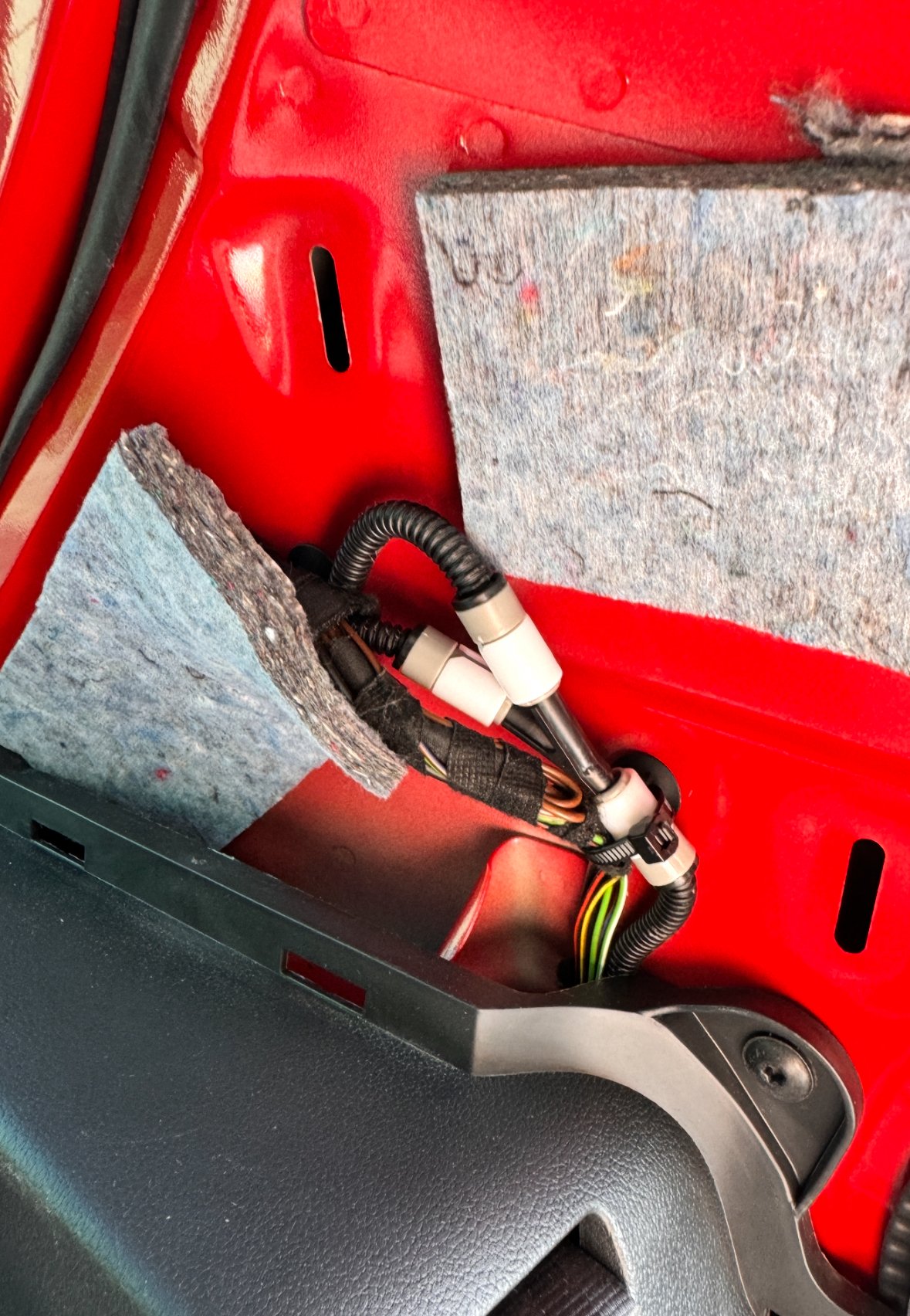

I just trimmed it as required, You can tap into the washer line in the C-Pillar on the left hand sideIMG_0724.jpeg

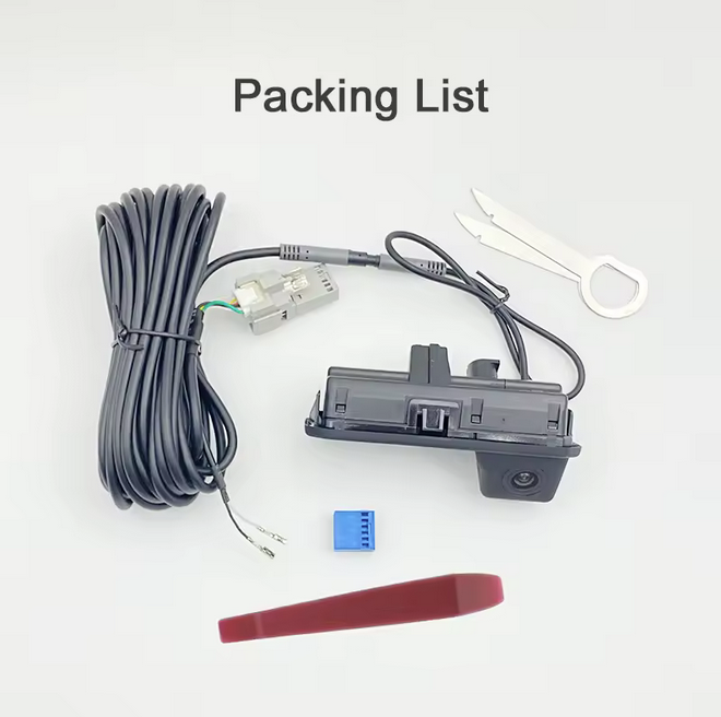

The camera I used was 6V0827566, and can be found here;
https://a.aliexpress.com/_EGsVXXg
it came with the wiring look, and by taking a guess this is an oem kit, i’ve tried other aliexpress rvc’s and the cameras were poor. This one’s really good.
Yeh, Coding is necessary to tell the headunit the cameras there, do you have access to OBDEleven/ VAGcom etc?
