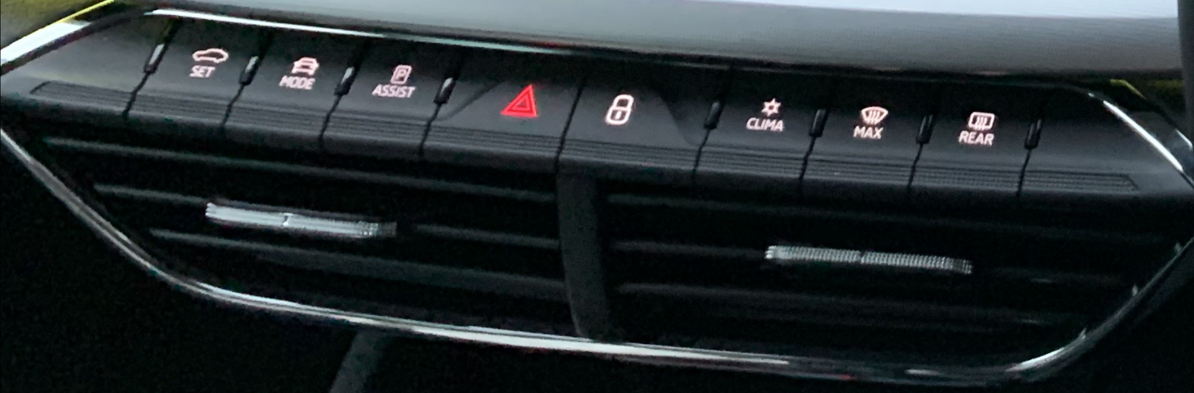

Isn’t there a physical button, centre console below screen on same row as air con physical buttons - second button from the left (UK Var)? Only reason I say this is I forgot that the button existed and searched through the virtual buttons only to realise there was in fact a physical button for driving modes. I grabbed the photo from the internet but, if memory serves me correctly, that’s roughly where the “Mode” button is on my Octavia Mk4 1.5 TSI SEL First Edition.
