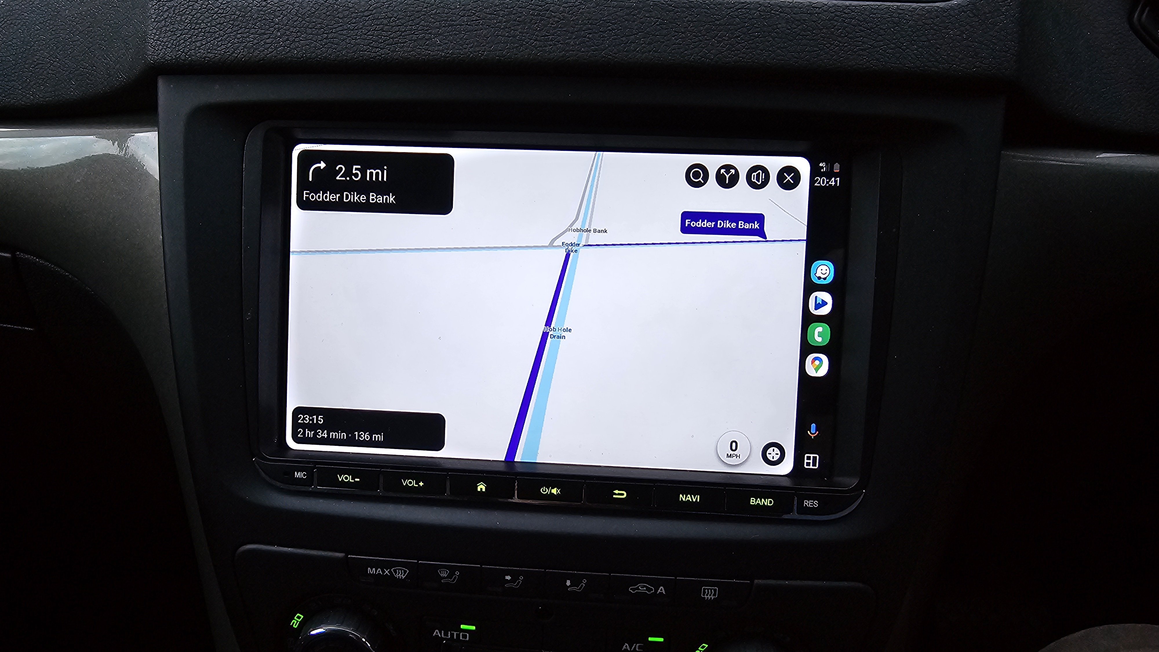

  15. This is what Waze looks like for me, I've never found it hard to use. Not had any slow response issues with my unit either, but as you see from my link and choice in my 1st response, I did pick one of the more expensive options.
