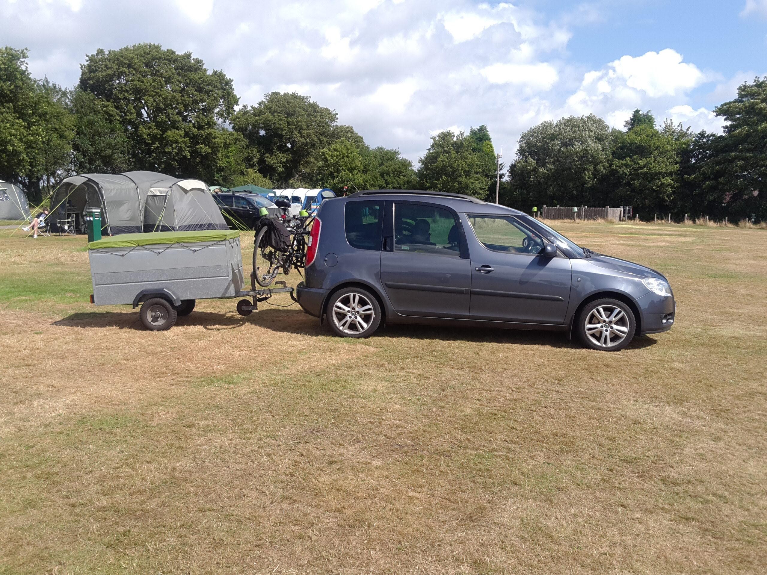

Towing with a Roomster
I used to have a Roomster and towed my full up camping trailer around the country no problem. It was the 1.9 TDI engine, so not a comparison with your 1.2 TSI. As you say it can't be any worse than a fully loaded car and you know that works. Watch the nose weight for towing, IIRC it's only 50kg on the Roomster.
