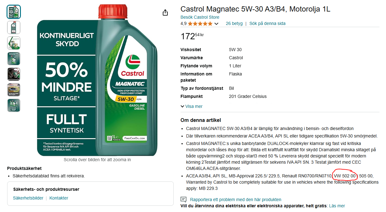

  13. @Kamal7 Your original oil, shows VW502. So for every year Oil + Oil Filter change then it is OK :
  14. You need Specification VW507, example: Castrol EDGE 5W-30 LL Engine Oil Mobil 1 ESP 5w-30 Advanced Fully Synthetic Engine Oil
