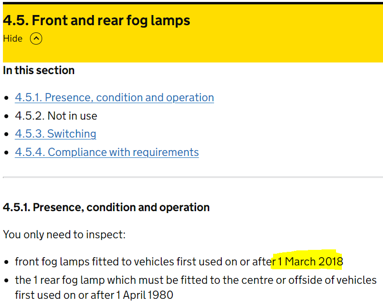

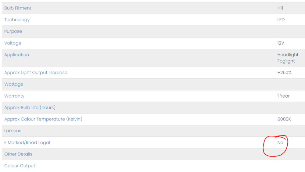

I'm pretty sure the front fog lights are H8, alas non are E-marked so are not road legal, even those from Philips etc. https://www.autobulbsdirect.co.uk/h8-h11-h16-philips-led-x-treme-ultinon-gen2-pair.html I'm not sure the front fogs are part of the MOT? Either way the chances of it being an issue I'd imagine are slim...

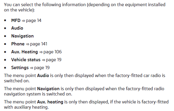

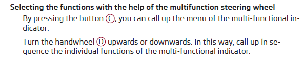

The 'individual functions' vary by specification and market, but roughly when selecting 'MFD' (Multi Function Display) you should be able to view some or all of the following: Driving time Current fuel consumption Average fuel consumption Range Distance driven Average speed Current speed Oil temperature Warning against excessive speeds
