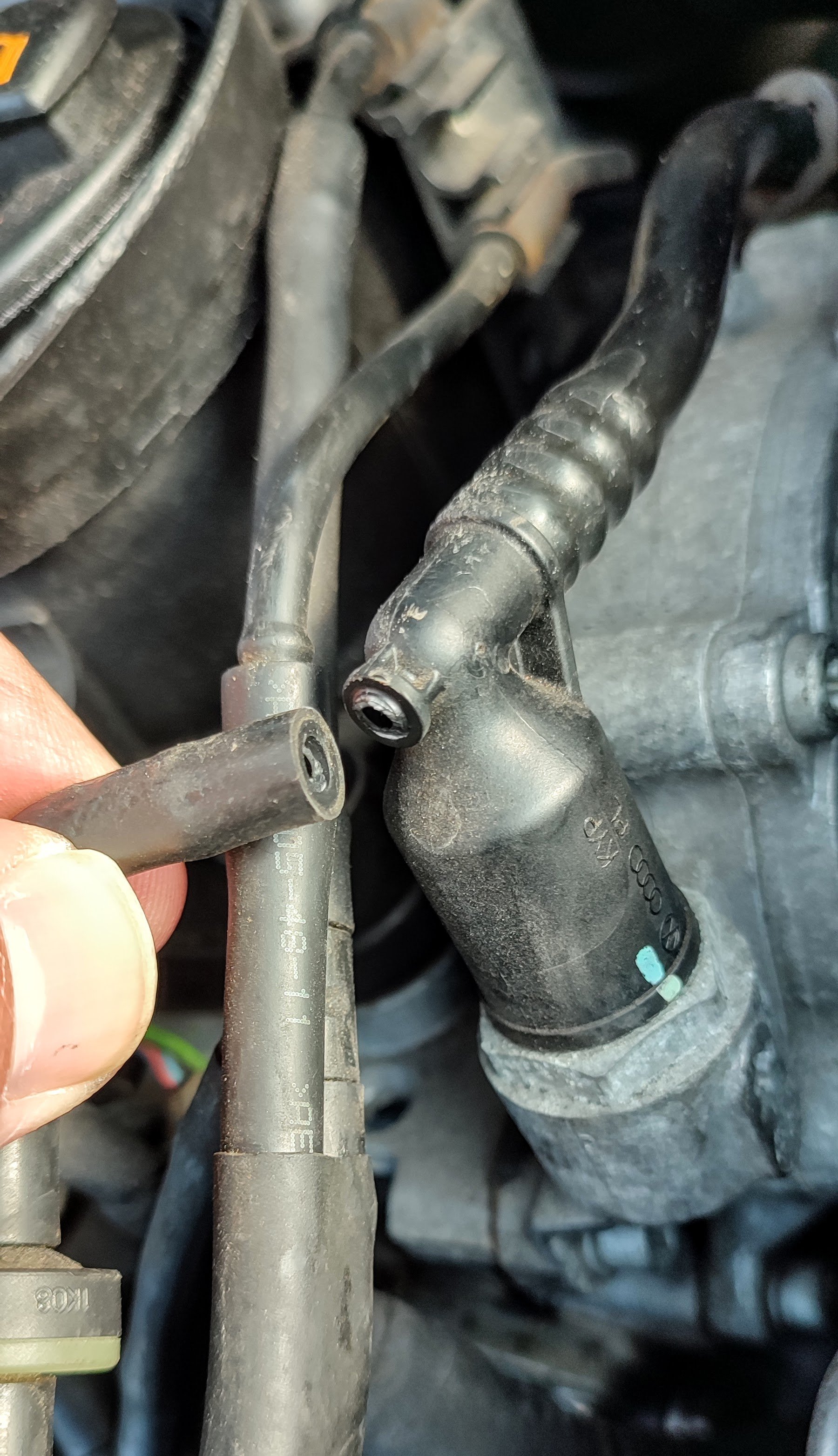

  5. @J.R. Master cylinder fixed thanks, traction is MUCH better so I wonder if it's been weeping for a while. It must have been snapped by a tech with a large gut whilst reaching down the back of the engine - annoying as the loss of vacuum causes limp mode at just about every gear change. In the short term I think I'm going to see if a fuel pipe T piece will fit, hopefully I can get Amazon to deliver so I don't have to risk life and limb on the fast roads.
  6. Pipes coming off the vacuum pump
  7. The garage fixing my master cylinder provided a Brucie Bonus today - after 50+ limp mode activations and crossing Rose Hill, Lickey at 20mph - I took a look under the bonnet and found this; PLEASE tell me this a cheap fix?
