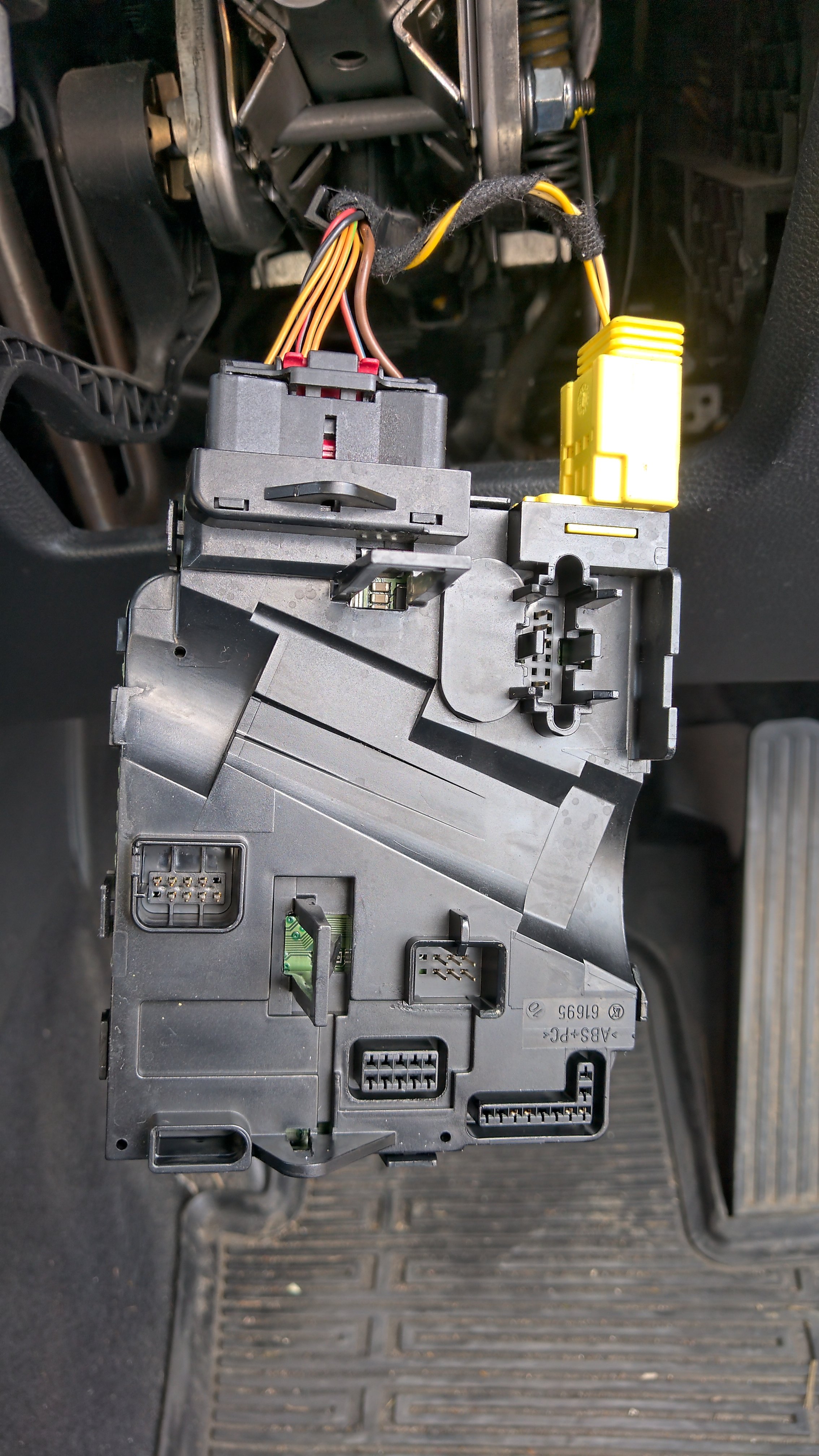

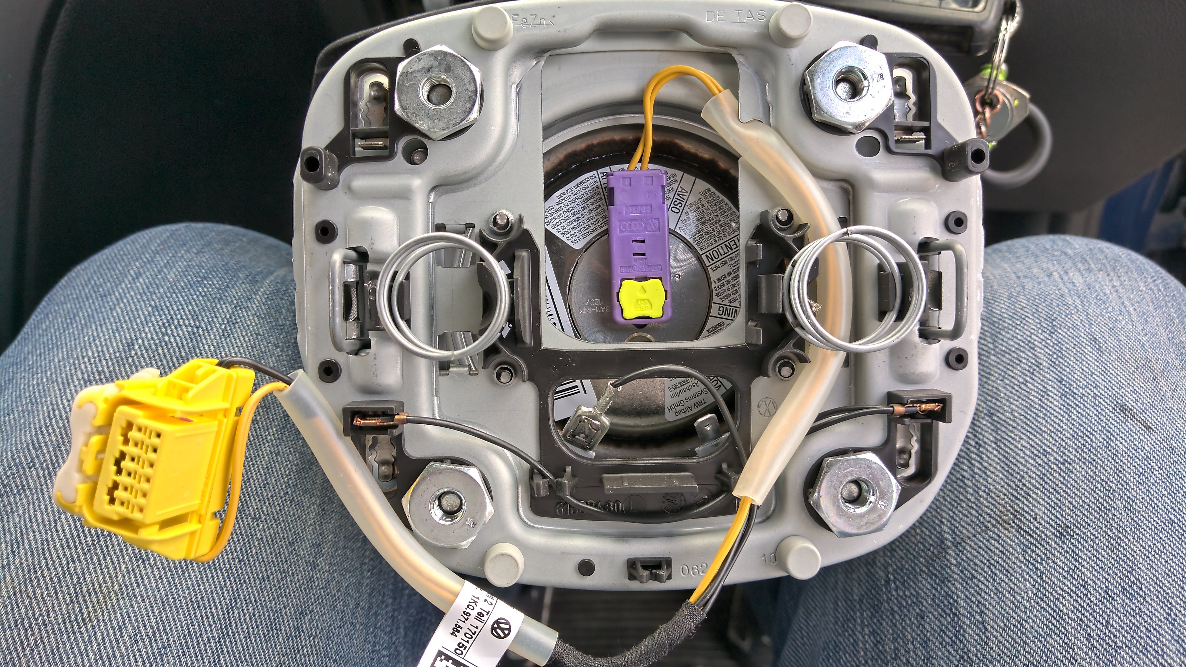

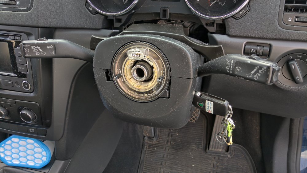

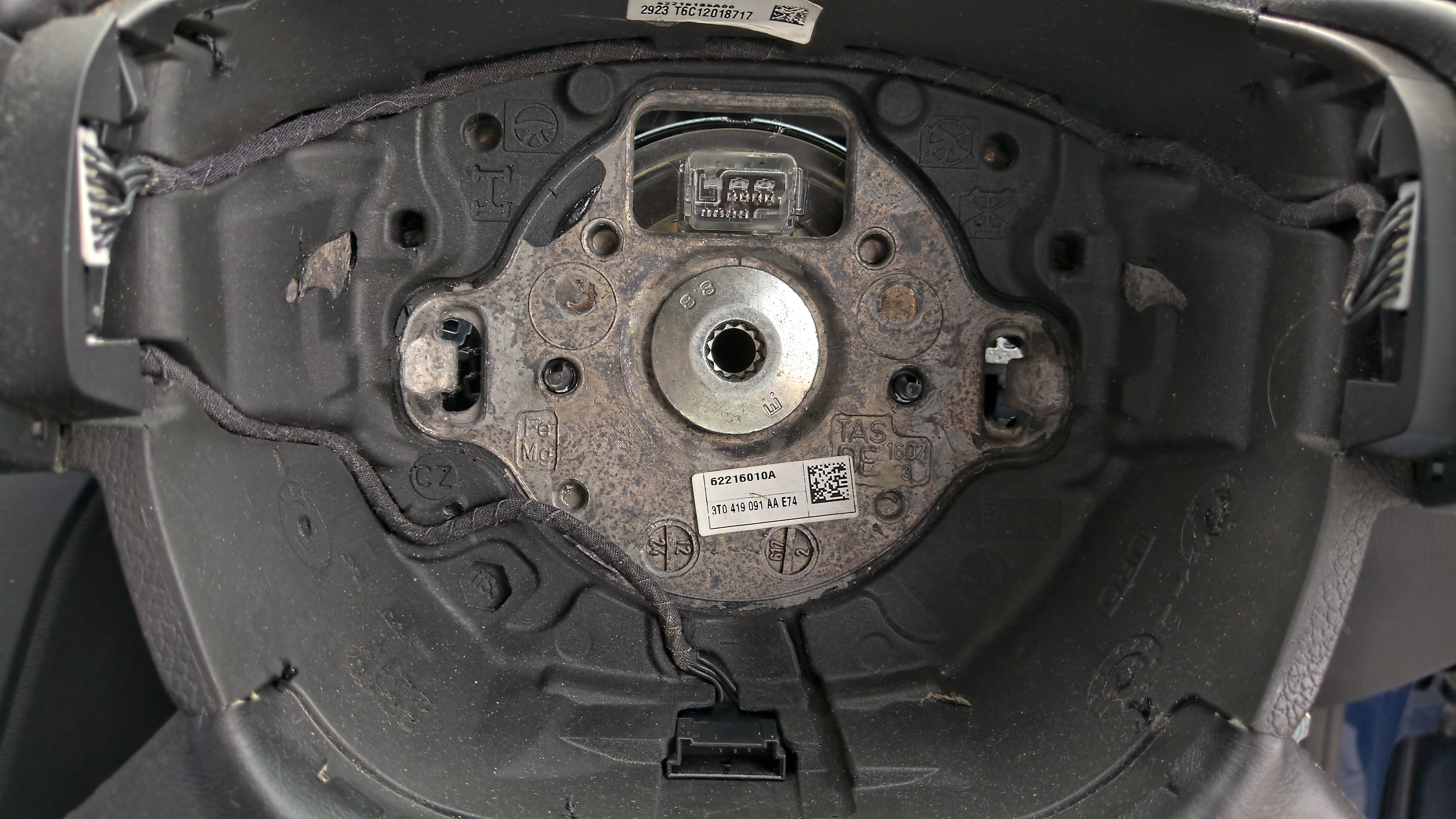

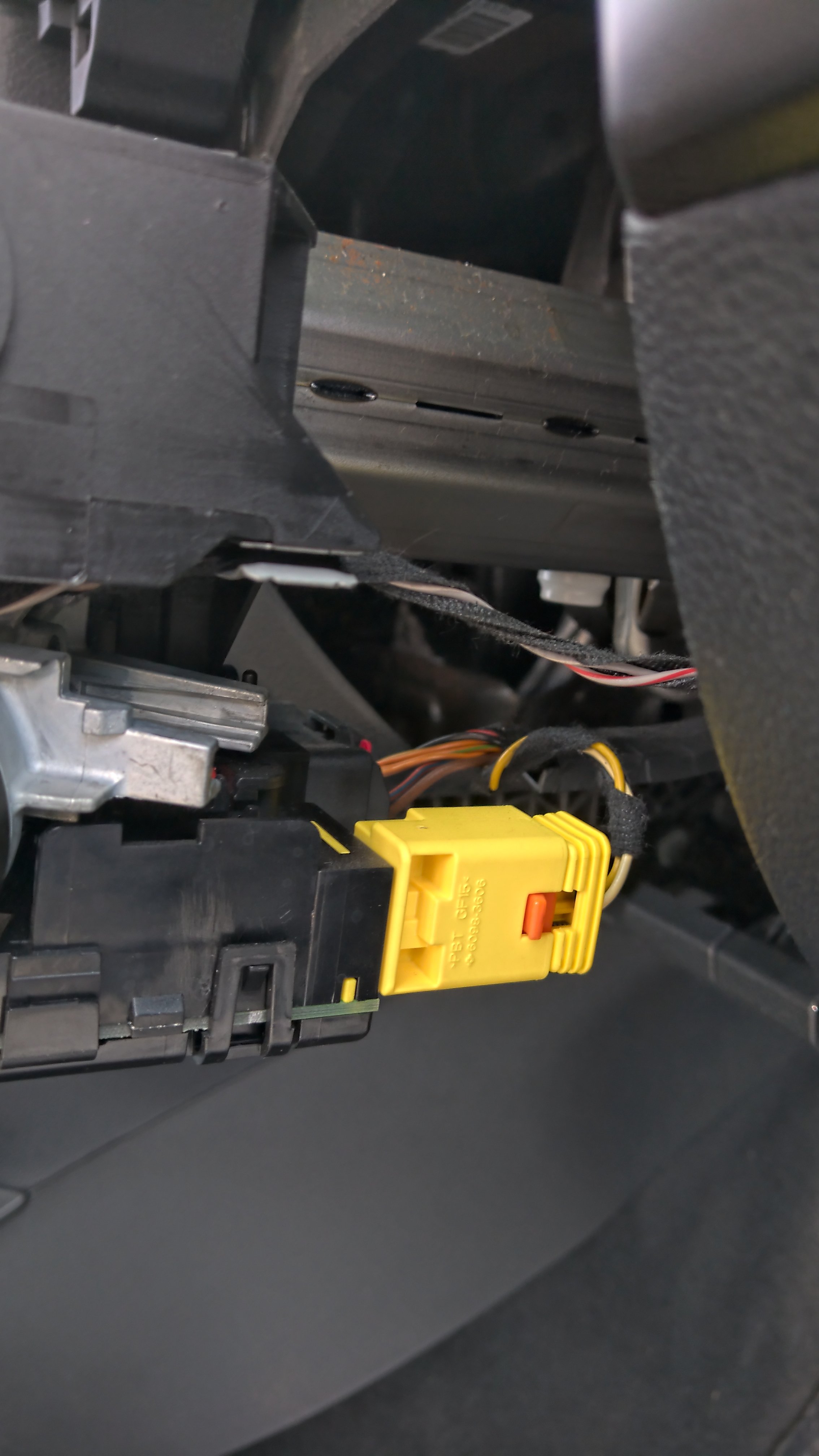

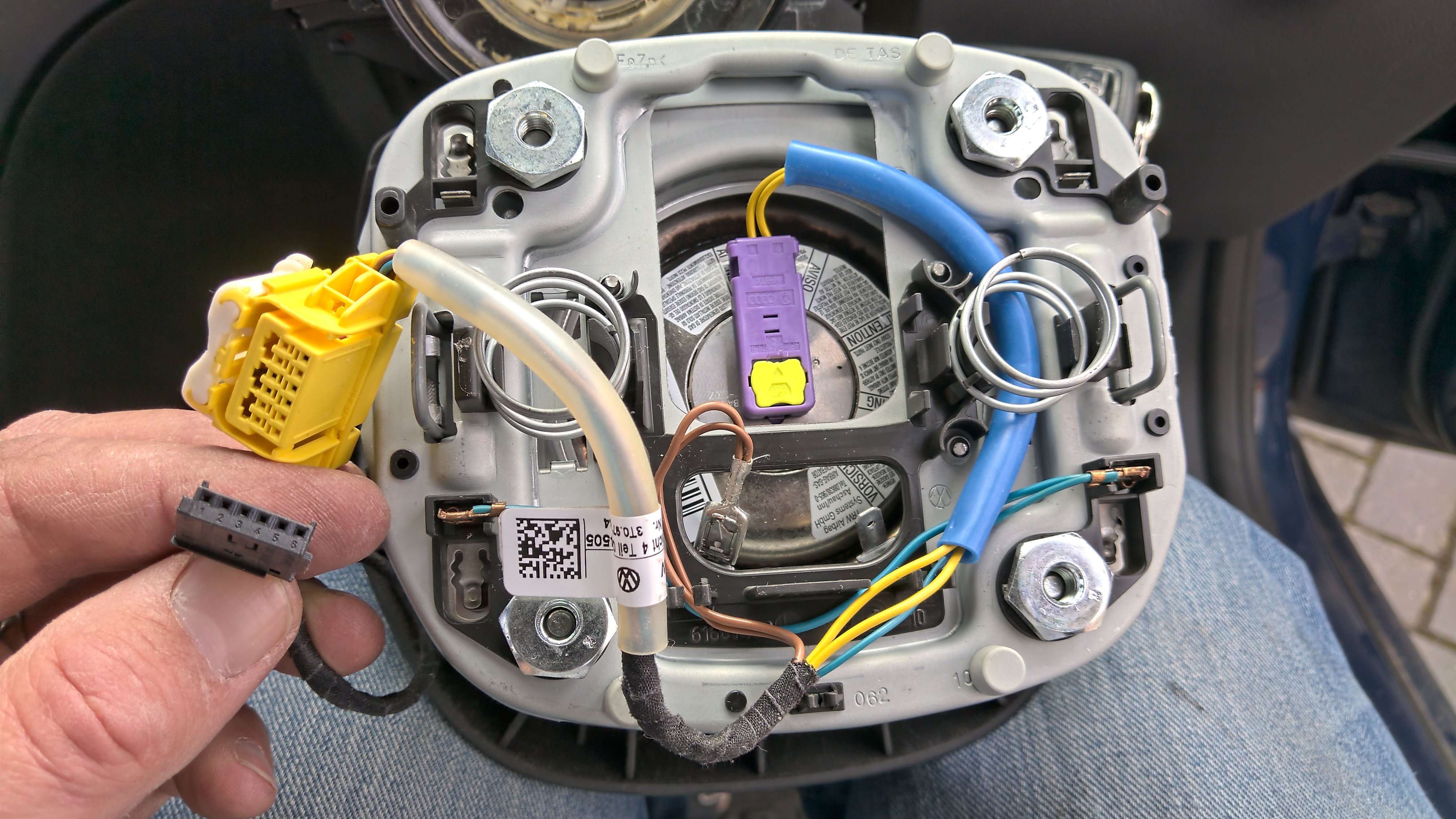

  22. The airbag loom needed to be changed. The rest is pretty self explanatory - took an hour which included 20 mins letting the airbag 'relax'

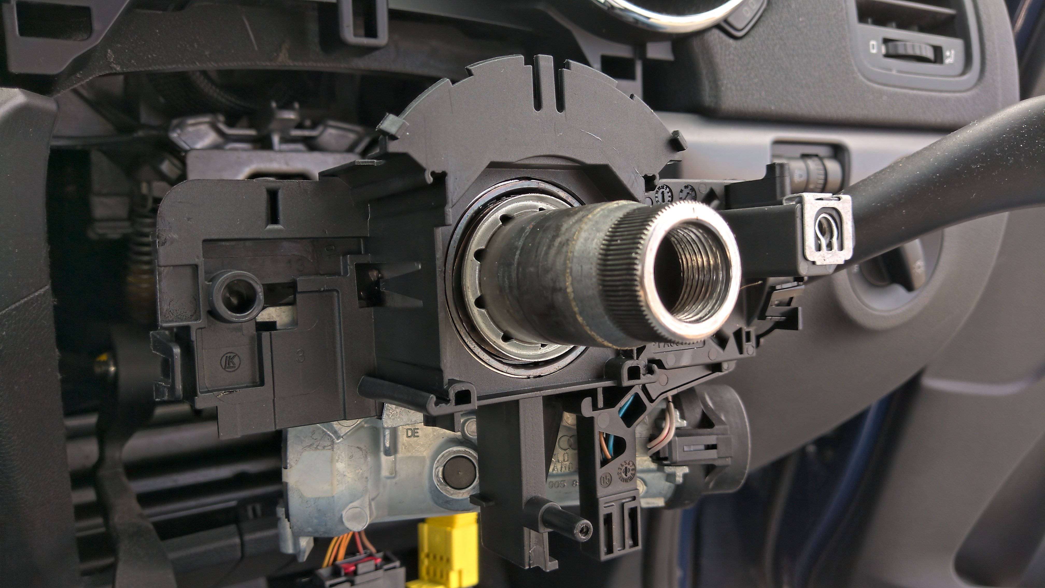

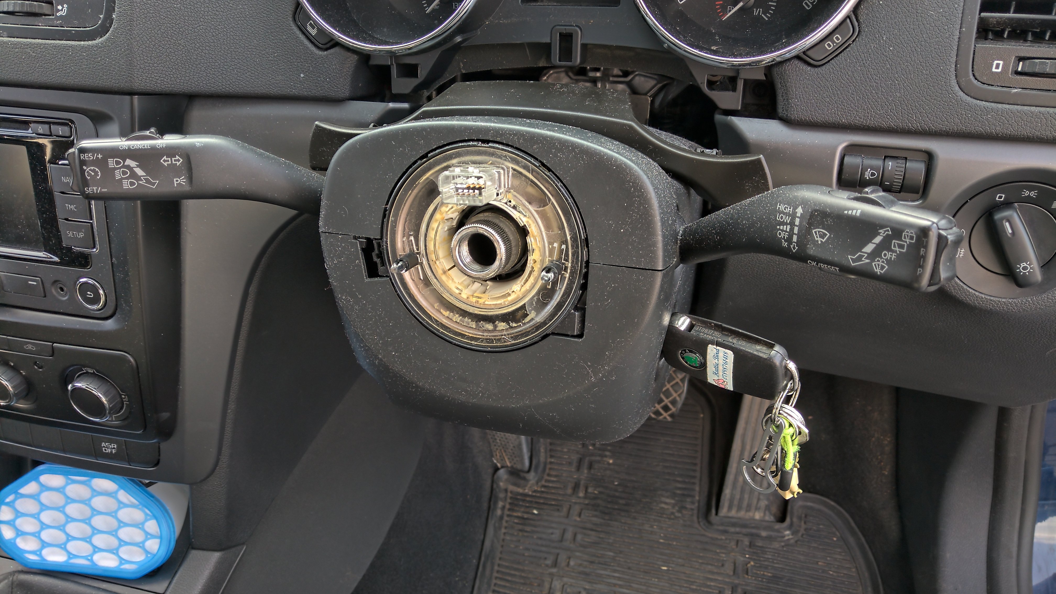

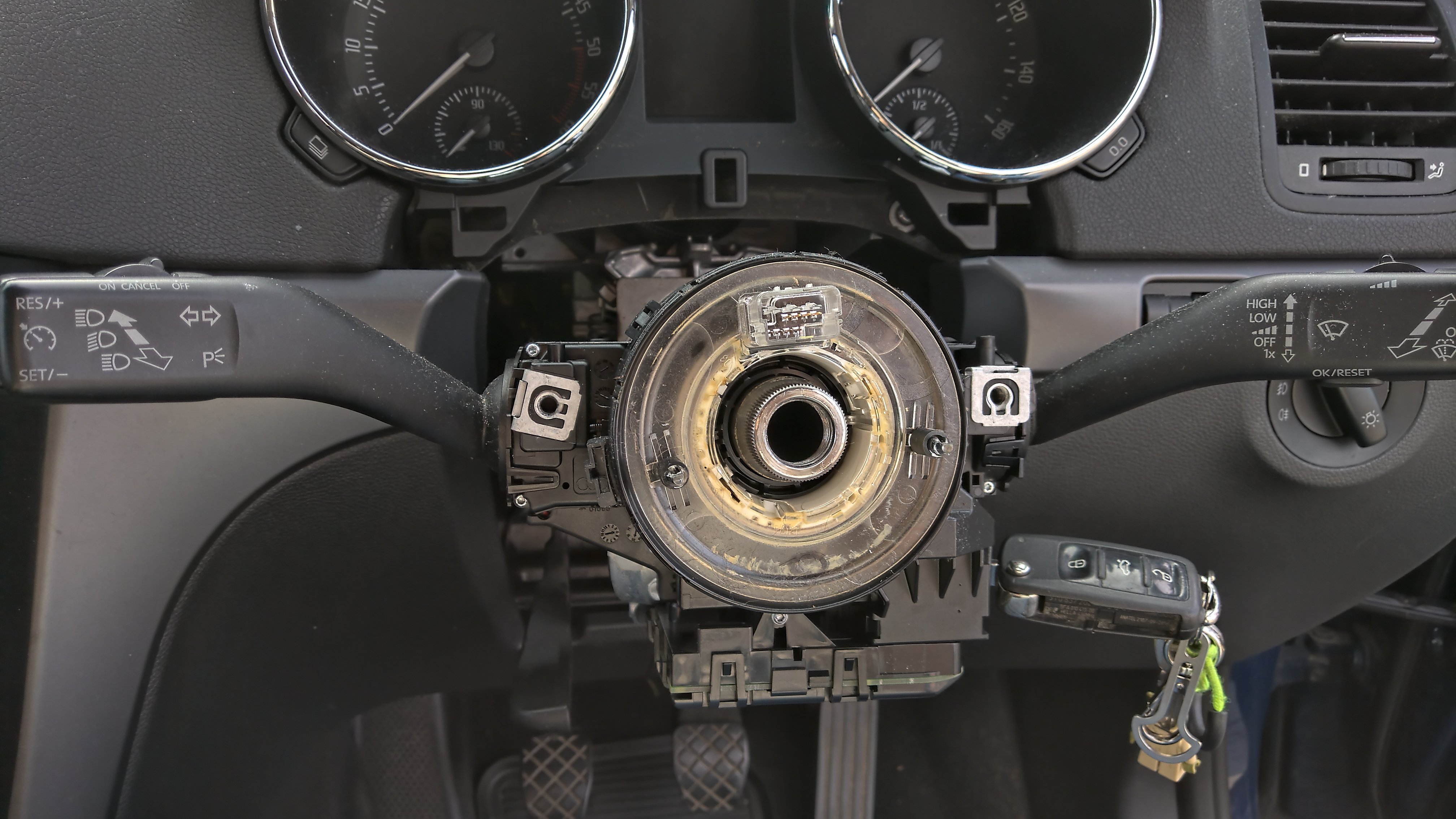

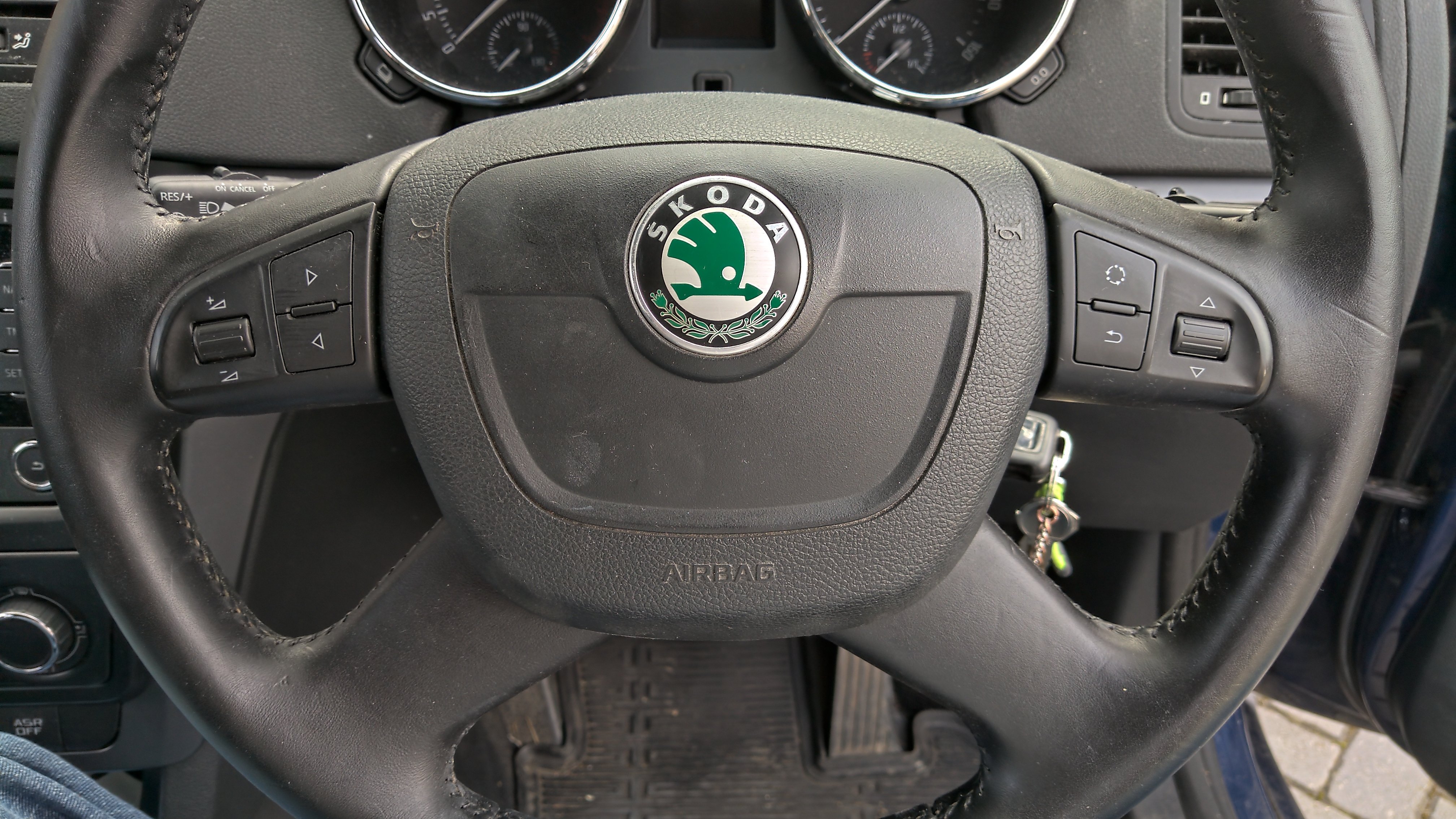

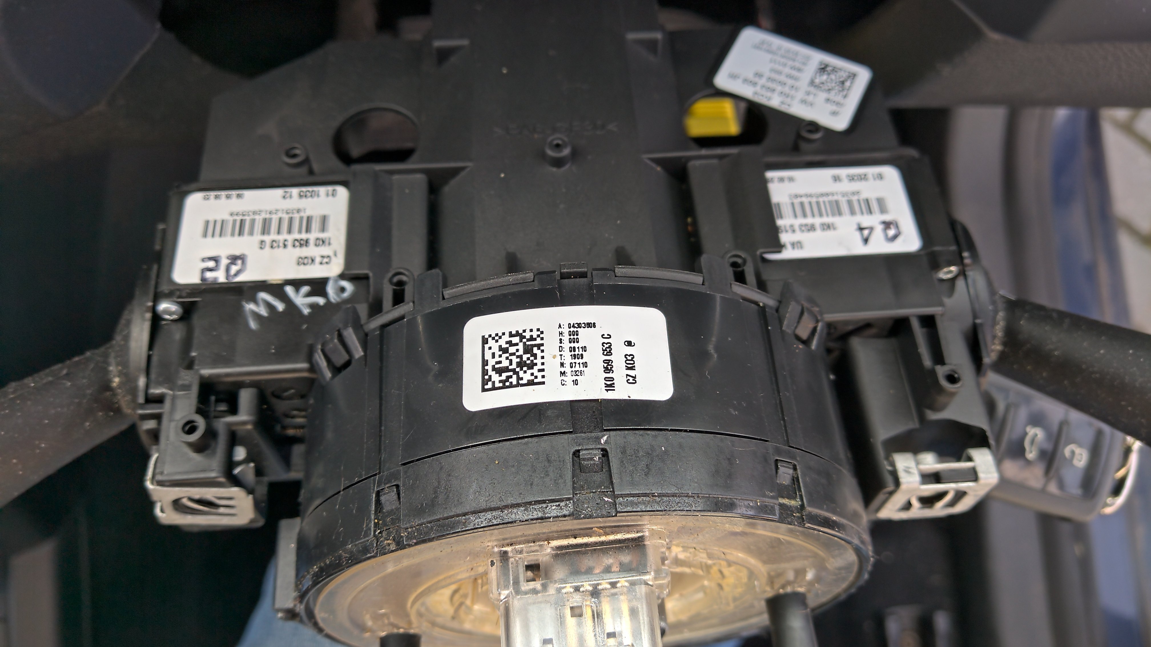

  23. I'm slowly getting our 2010 110hp Yeti S tdi in order, whilst replacing a failed cruise stalk today I took the opportunity to upgrade the steering controller (CQ is the old one, replaced with CF) and fit a MFSW. A little bit of VCDS coding and it's all working as it should, which is nice.

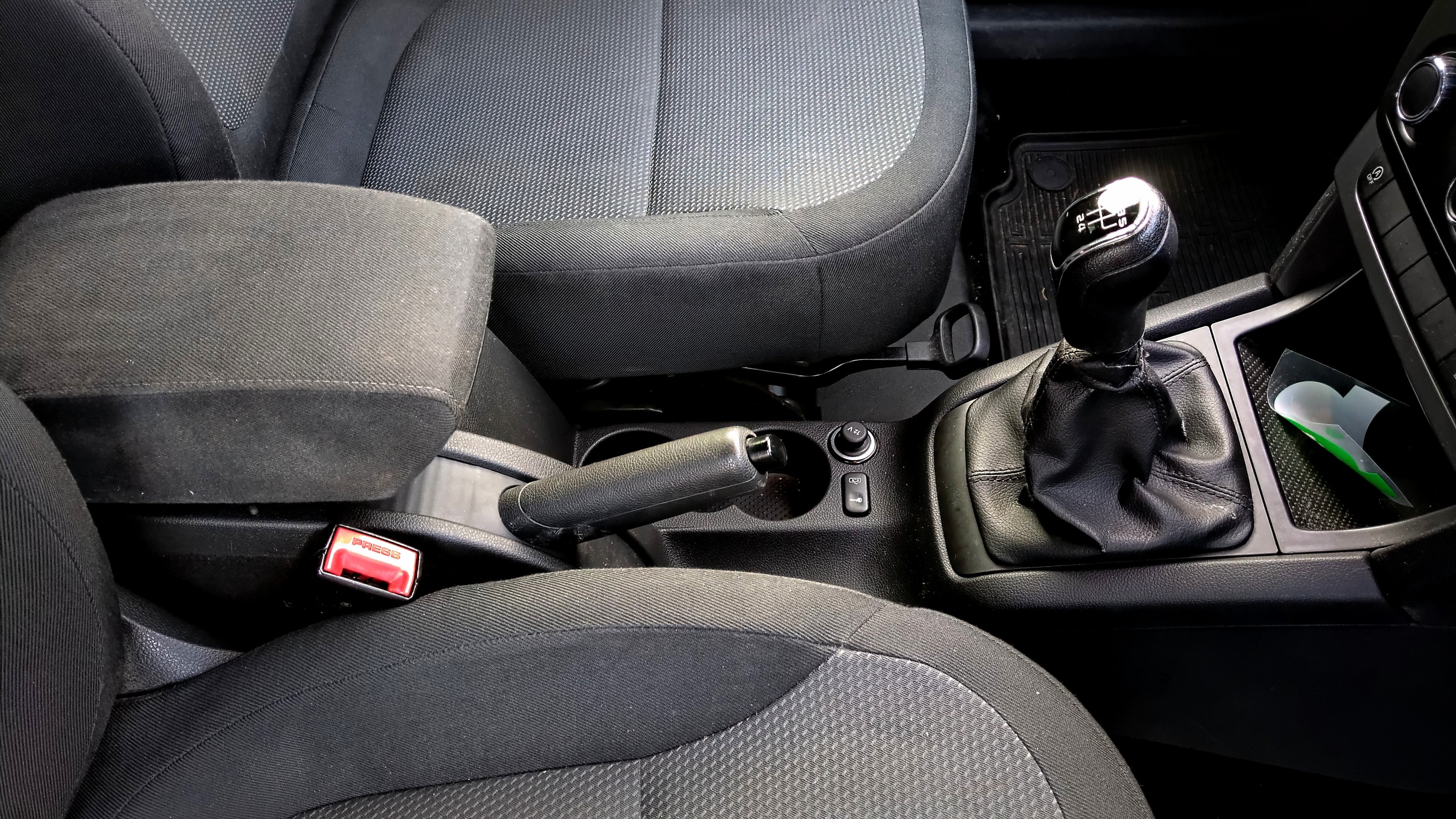

  24. A downside of my council house spec Yeti is the lack of an armrest, a failing I fixed today; £20 in used parts off eBay (God love people who misspell items and get no bids ), and an hour of my time which included chats to nosey neighbours.
