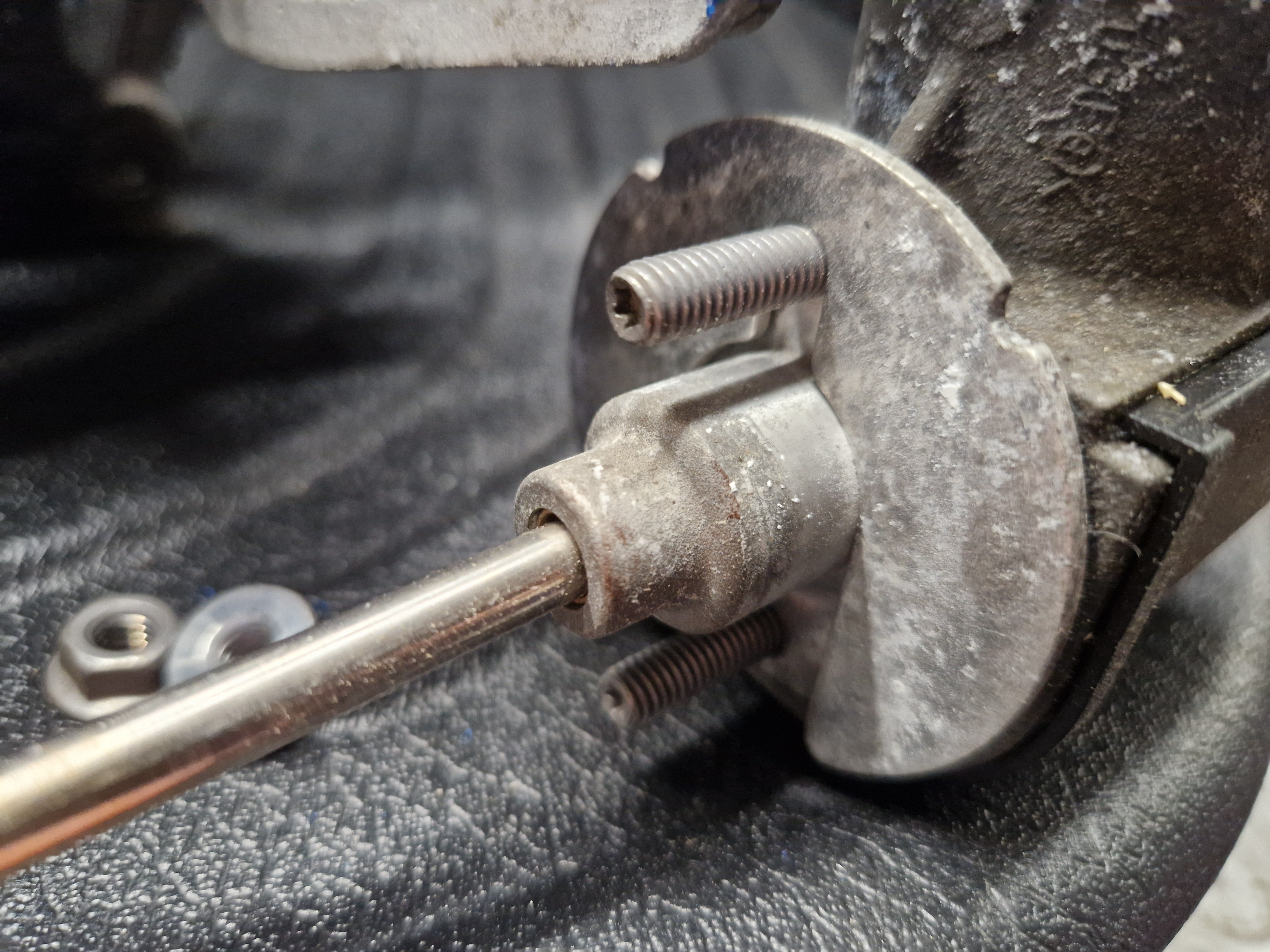

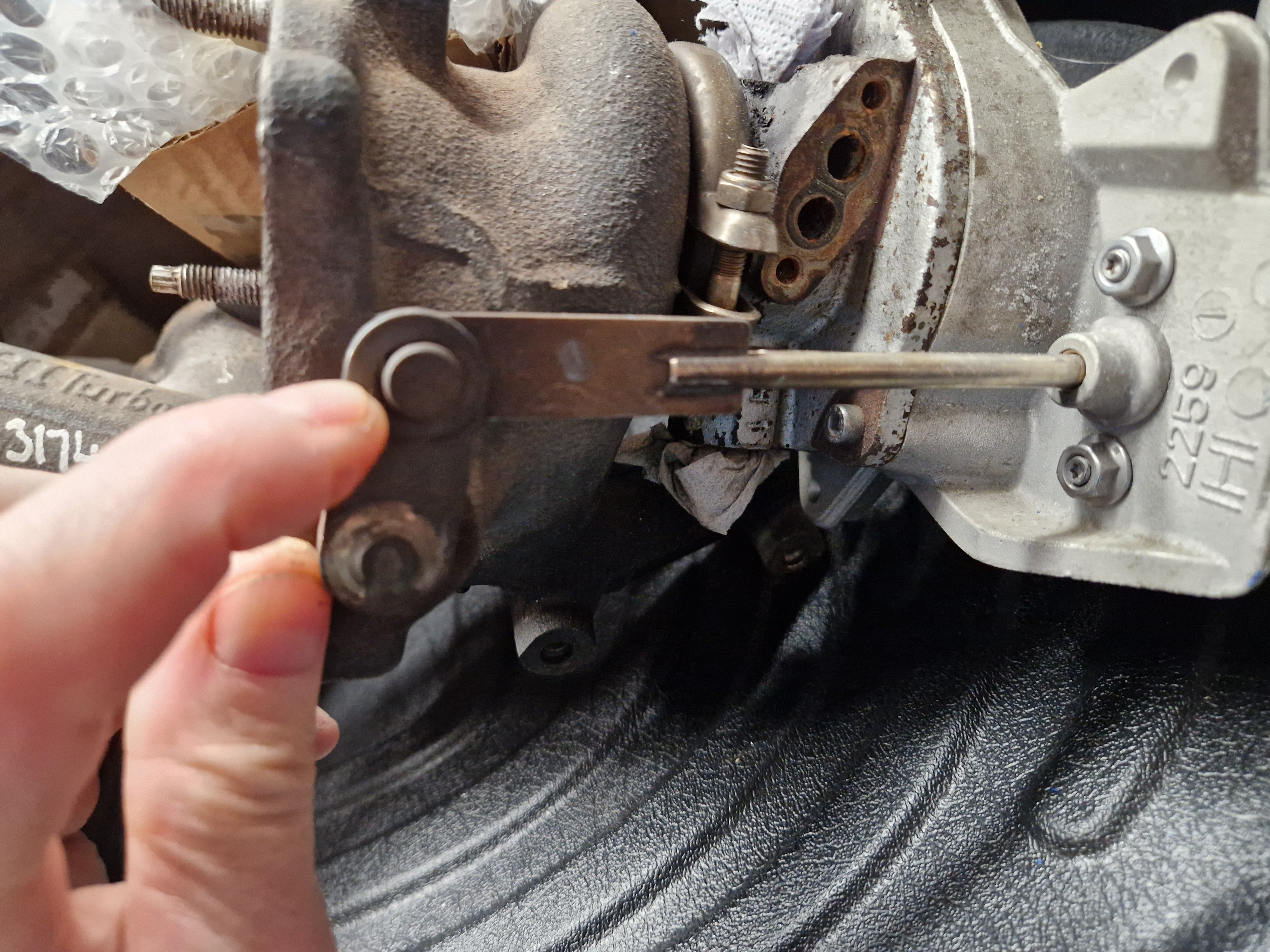

I bought a secondhand set of injectors from a low mileage car about a year ago and had them cleaned and tested at a local specialist. Fitted them and noticed no change at all. 😆 Walnut cleaning would probably be more useful, but fitting a younger, less worn-out turbo is the next plan. Also probably new water pump and thermostat housing at same time. Scheduled for August. Between now and then I'm keen to install some voltage monitoring kit in the cabin, looking at both alternator output voltage and battery terminal voltage. No longer trust the car's resident warning system!

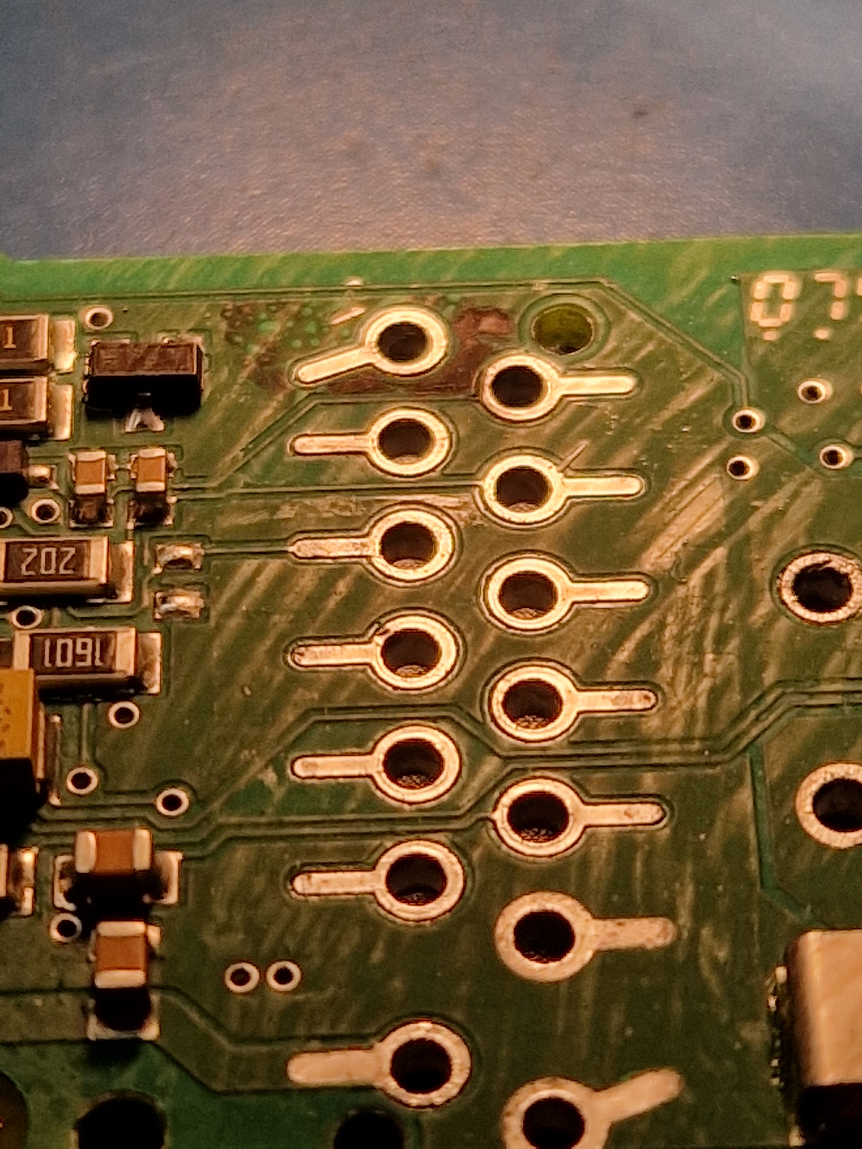

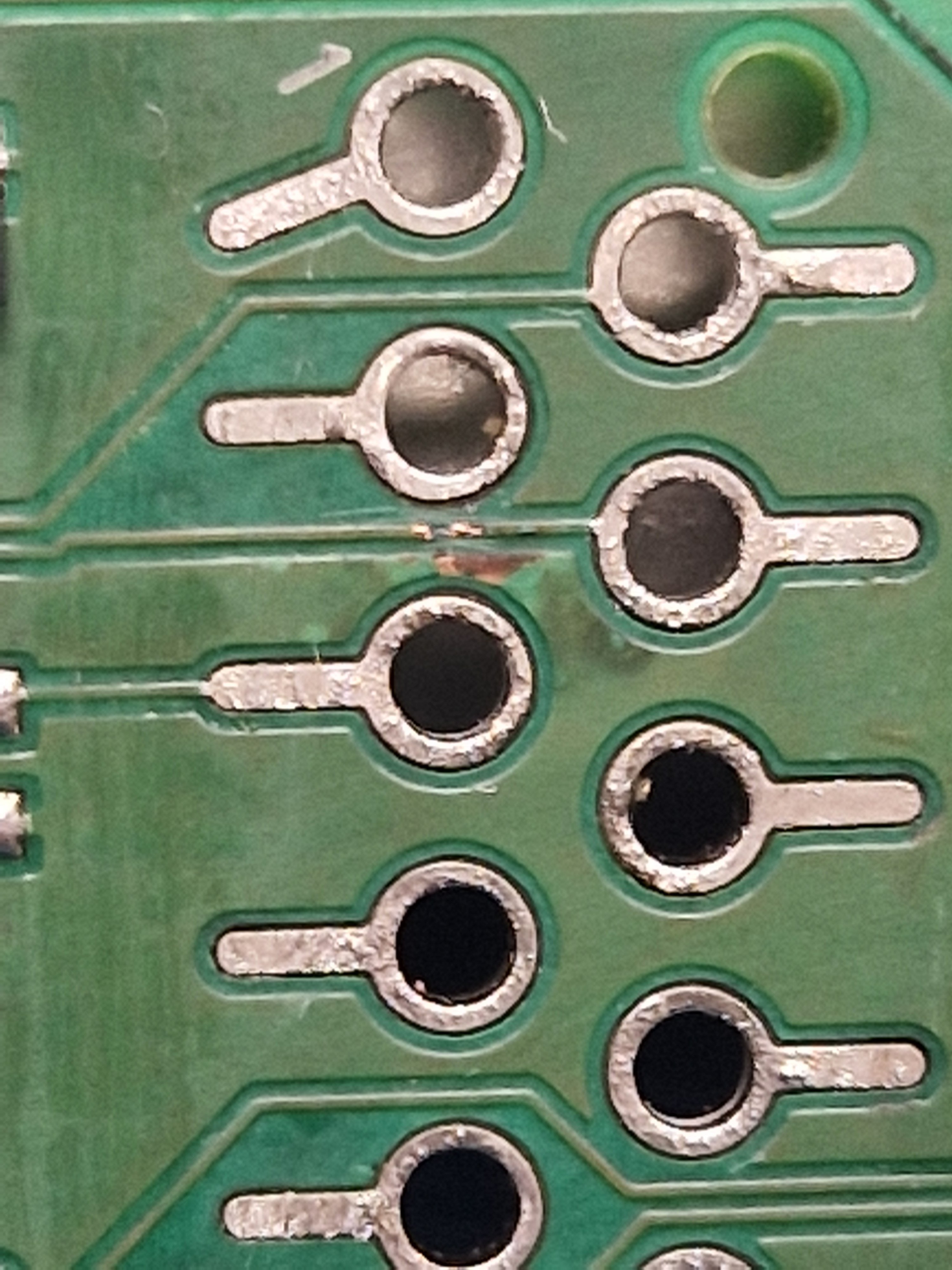

Look at the connector contacts on both sides. I mean the loom connector which plugs into the whole light cluster. You're looking for crusty corrosion, especially on the contacts of the brown earth wire both sides. Look at the male pins on the light cluster connectors too.
