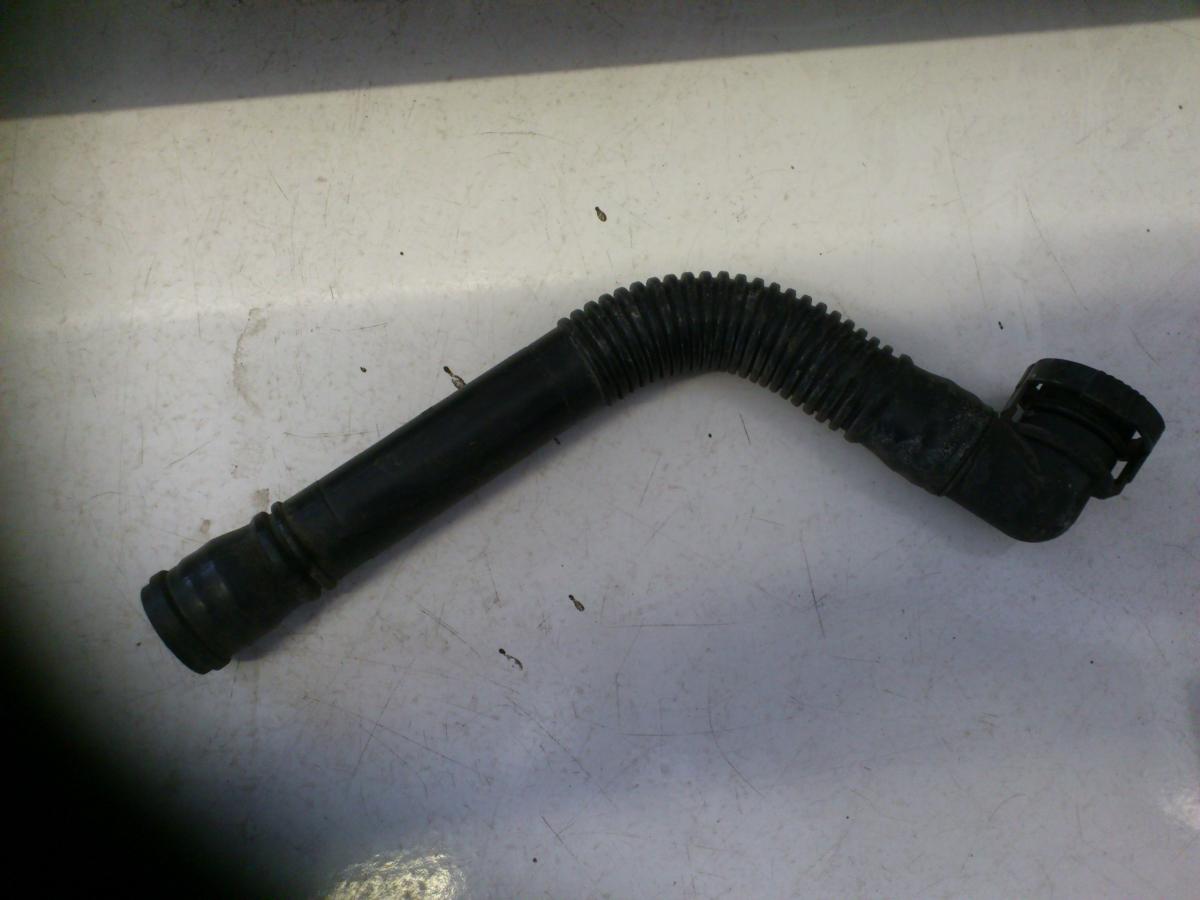

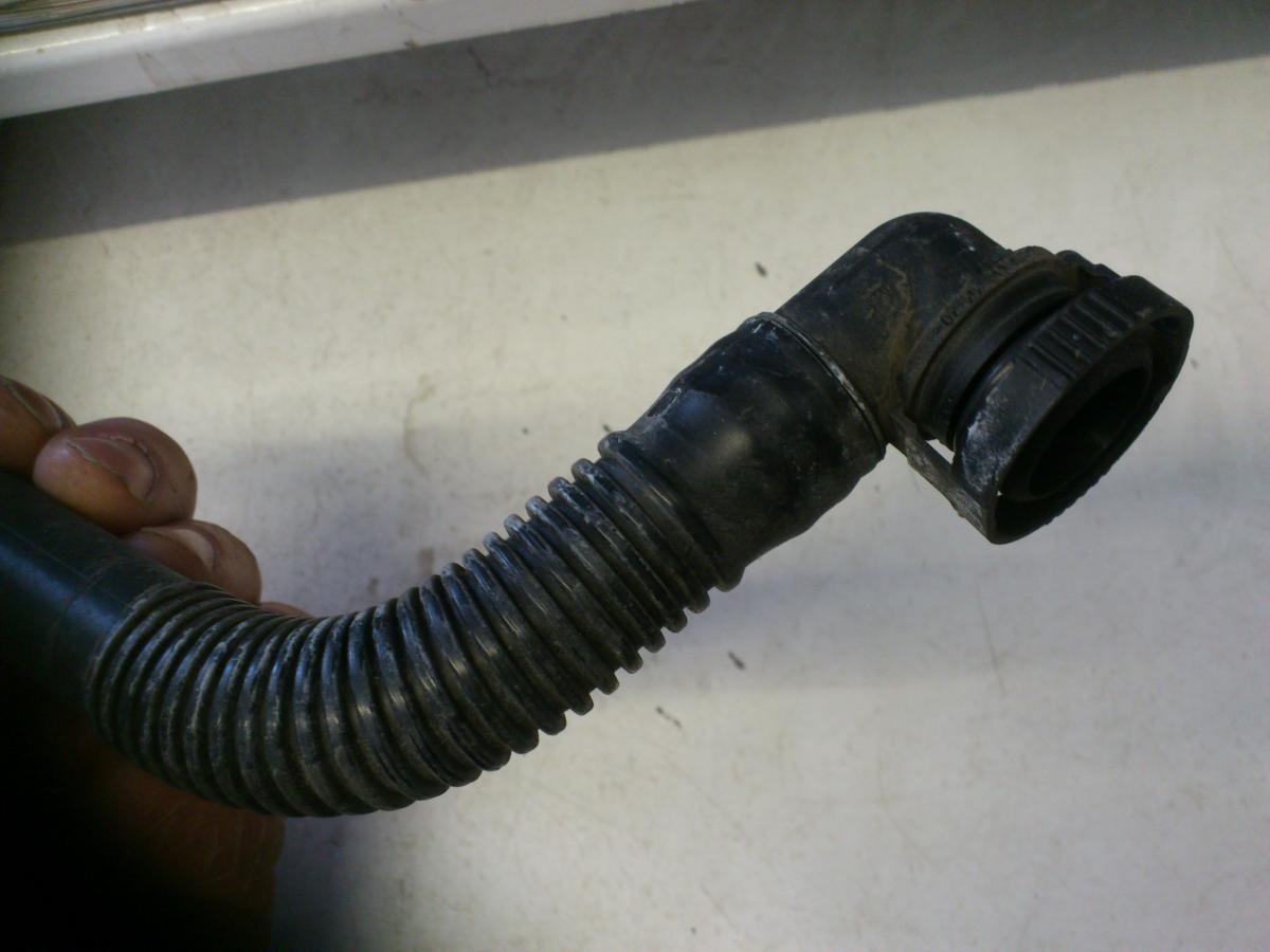

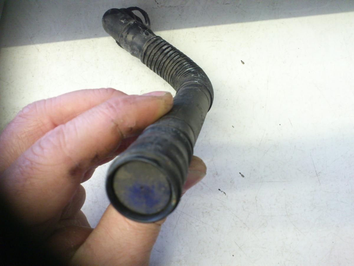

Guys i had a Mk5 Golf in today and was fixing the ABS module,upon removing the air filter housing i found the "drain" pipe from the bottom to have a plastic pipe fitted with a simple "one way vale" fitted. basically it was a plastic pipe with a rubber seal fitted that allows it to act as a 1 way valve,i took a pic but its at work so will add this tomorrow.
Some pics of the said valve/pipe.
