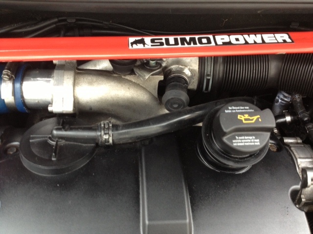

Just done the elephant mod today! Used a regulation walking stick rubber end (in black ) with a Id of 24mm giving a perfect fit on inlet manifold.
Used 1 meter of black hose with 19mm id for a perfect fit on crank case vent. Ran pipe down to sub frame.
5 min job . Not been out for a run yet so hope it makes some sort of improvement.
This is the pic of my 5 mins of hard labour lol
Haha nice job mate, exactly what I did. Even used the existing spring clip! Ultimate pikey mod. You may notice a bit of steam if you look underneath but it shouldn't come to much. In fact it may well slowly coat the bottom of the car in oil and keep it corrosion free! :rofl:
