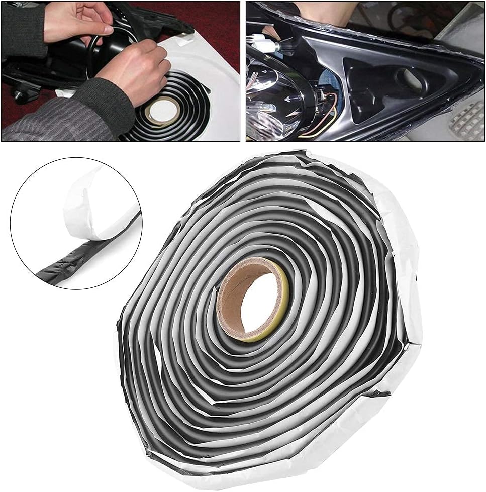

I used Black bathroom silicone sealant from wickes(wickes is a UK builders / DIY chain store) It's what I used as a quick fix 8 years ago when the old windscreen seal started letting water in, and it worked, so I just went for it again. I also only had 20mins before it got dark so had to be quick.
The key word is SILICONE, because there are plenty of sealants out there that just melt when they get wet.
18 minutes ago, D.FYLAKTOS said:
Original,
Didn't think that there was any sealant used from the factory, probably why so many Felicia's ended up with wet carpets. That combined with the 2 little holes under the windscreen seal.
Edited by R_U_AFA
A 1 euro silicone won't do the job as one with 15 euro, there are silicones that can be used in aquarium for example which means can stand to 100% water contact for about 15 years.
In the 1st sealant  (they call it "Macaroni" or "Cord" here) there are levels of quality too, learn it by bad experience.
Here in Greece some companies offer after market windscreens but some of them are from China and there are some kind of ''waves'' in the direct sun while driving.
In case of a crash or vandalism if you have insurance the replace is Free but the quality is an issue, some drivers made complains after installation, some don't.
