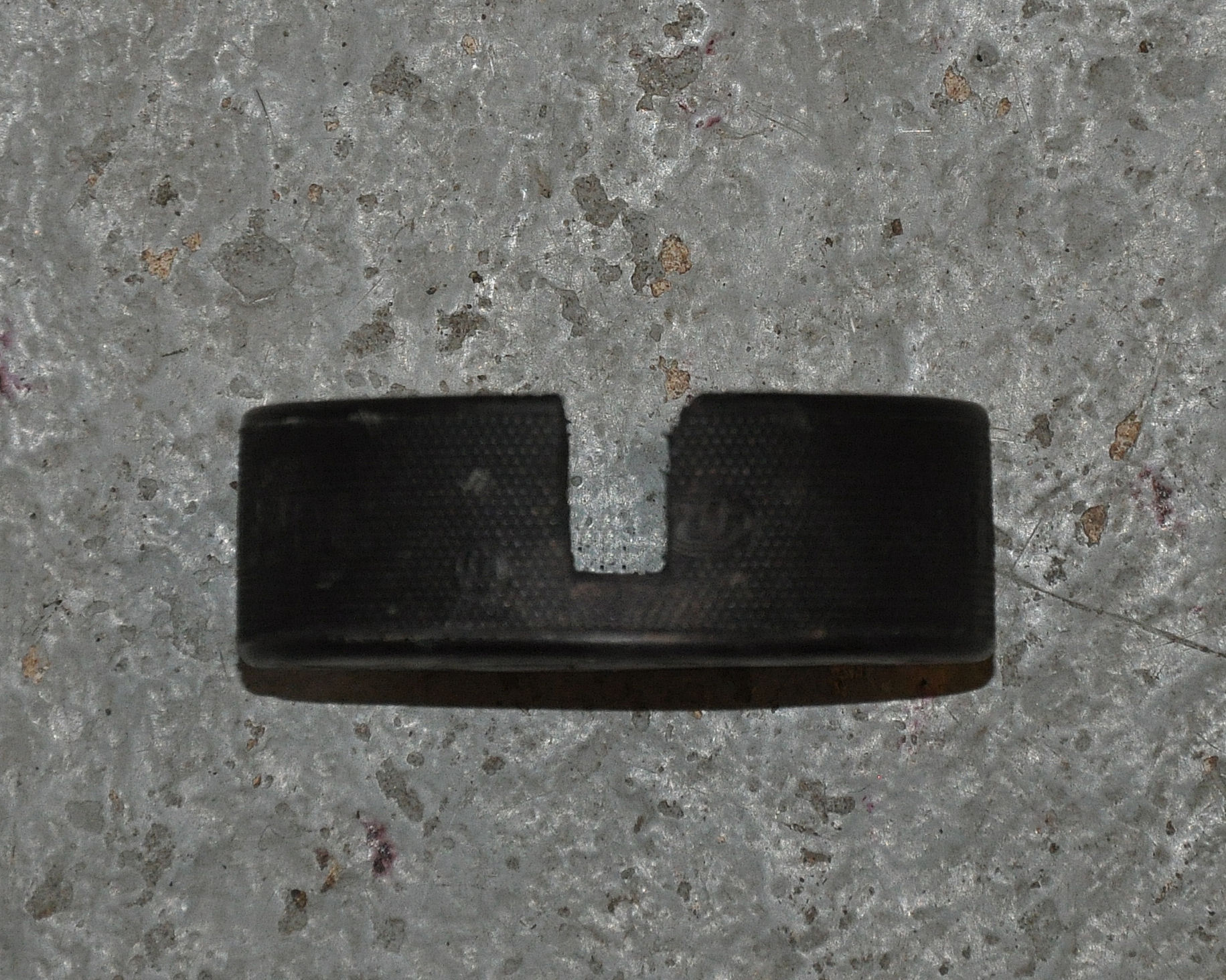

The car changes angle as it goes up and down though. E.g. from \ to - to / especially if one side has already been jacked up and put on a stand (not so extreme as those angles but that's the only characters I can use to represent it without doing paint :)), whereas the jack and rubber bit stay completely horizontal as the jack moves on its wheels as you say. So I guess this movement in the car twists it slightly within the rubber as a result of that. I suspect a U cut in the puck would work better than a V which will grab the paint more as the car pivots while going up and down.

I'd say yes, you definitely want the slot straight-sided rather than V-shaped - if you're only jacking at one point a la the toolkit jack, then the sill either side of the seam should be bearing the weight, not just the bottom edge of the seam. The flex of the rubber should take care of the rest - I've certainly not had any such issues using a rectangular flat-bottomed slot cut to the height and width of the seam.
Looks good - I've got one of the ice hockey pucks put haven't tried cutting a grrove in it.
How easy was it to cut? Did you just use a hack saw?

Maybe I need to cut deeper too. Any ideas on approx depth/ratio of puck needing the chop? I've gone about 3/4 down.
As long as the cut is just over the depth of the seam then that should be enough.
Here's a photo of mine and it looks like I decided to make a groove (instead of a 'V') to allow room for the rubber to expand (slightly) under the car's weight.
I don't follow why folks are cutting these so deep?
Wee shallow u-shaped channel, about 5mm deep by ~7mm wide. Use a bit of steel, i used 1 inch angle iron but a steel rule would do i suppose, clamped down to hold the puck from moving and to give you a straight edge to draw an electric soldering iron down (110w i used). Lots of passes taking a small amount each time keeps the air almost breathable!

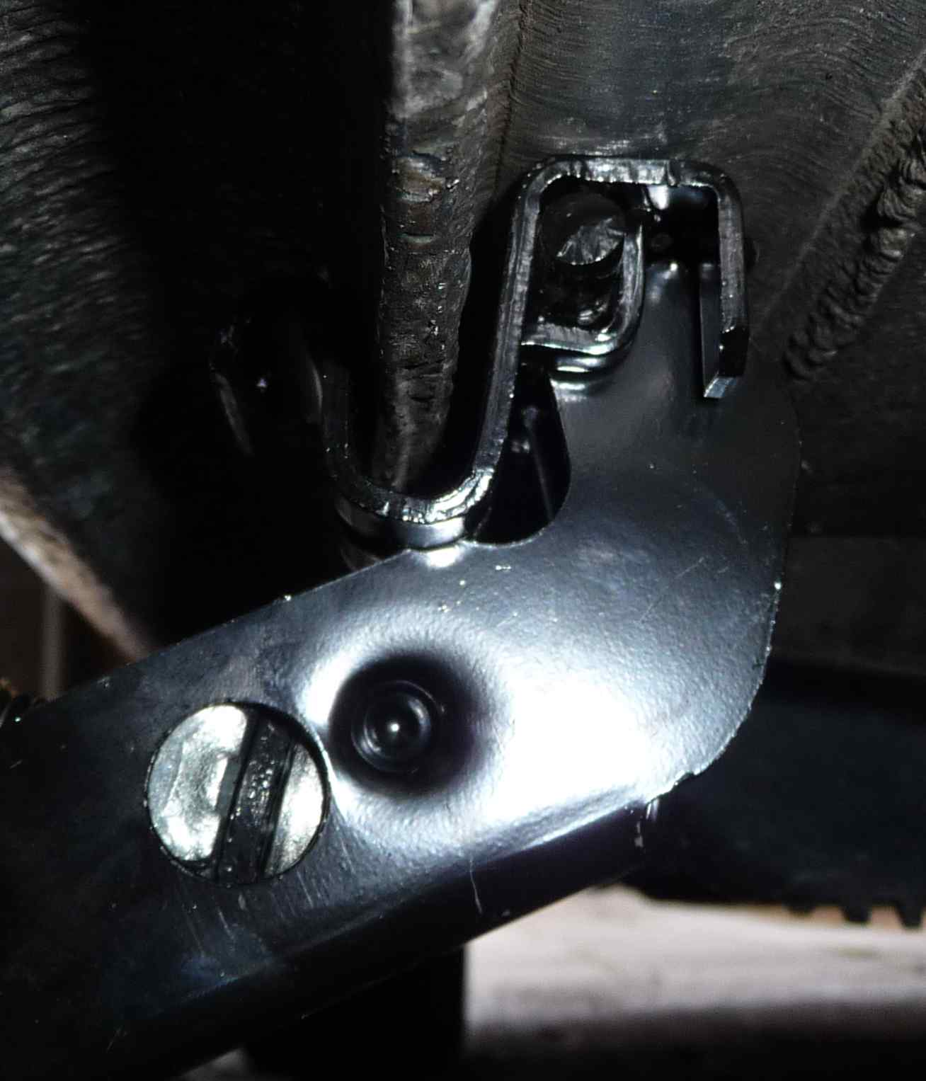

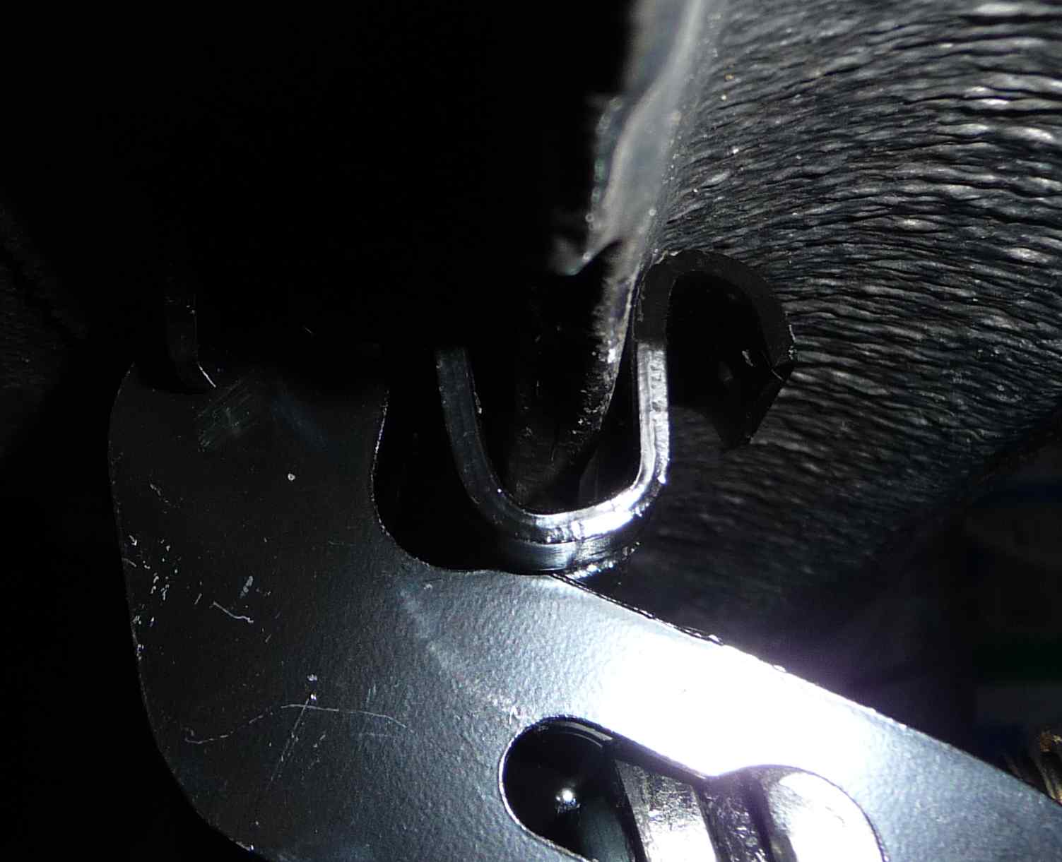

I'm a bit confused (my usual state :happy: ) .
The car jack only seems to lift the car using the inner sill. Although it covers the seam, it doesn't appear to push up on it, or the outer sill. The attached photos are a bit dark, but show the car jack in place, so I'm assuming (perhaps wrongly??) I should be lifting the car using only the sill, and not the seam. If I cut a slot in a hockey puck, unless I go all the way through (or near enough), I'd still be lifting the car by this seam, so is it OK to do that, or am I missing something?
Your pictures do show how the jack fits over the seam very well, it does as you say only lift the vehicle on the inside of the seam. I did have a puck cut for my first MKII but when I checked it on my new Combi the slot is not deep enough, looks like the seam is deeper.

I cut 2 pucks last week.
Method:
I found the centre line of the puck across the face and drew a line down it, then measured 1/4 inch left and right and right of the centre line.
Cut these lines down vertically using a hacksaw to required depth (I guessed by cutting them half way to begin with, and then continued to cut down and measure fitting on the jacking points).
Then using a sharpened 1/2 inch wood chisel cut across the puck in order to remove the cut out section - I had to do this in several steps and once it gets deep into the puck, it gets harder. to move. Hitting it (like you would when working with wood has no effect as the rubber absorbs the impact), so wiggling it left and right rapidly seemed to work)
Once you are all the way across, tidy it up by removing thin slices from the bottom of the puck.
Measure - and repeat above steps if necessary.
I have jacked the car up (both front and rear at the same time, in order to test) and there is no damage to the sill, using a U cut with squared off edges.
