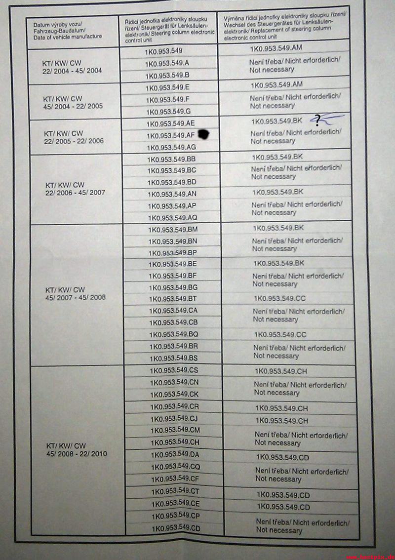

please see attach
K
If the car does not have the wire u have to manual fit one your self to a control box fitted by the wiper motor
please see PDF...you have conector and where to check for wire.
1K0054690A 3.pdf

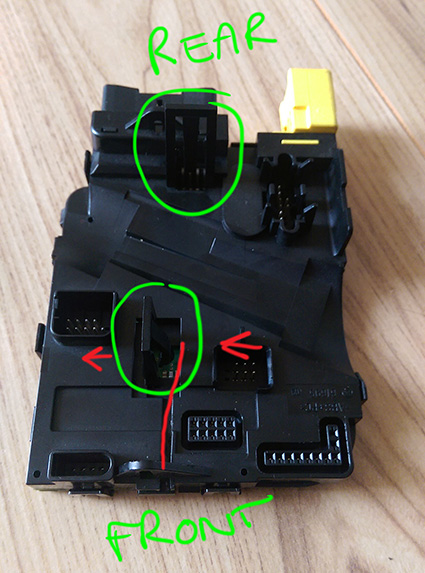

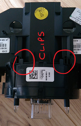

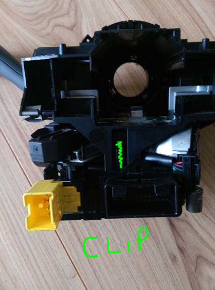

Guys how do you remove the clock spring to get the stalks out? I'm trying to replace my wiper stalk but I'm guessing the principle is is the same. I've got my steering wheel off but can't work out how to remove the clock spring.
Two little tabs on the top left and right rear, on my 2006 I had to remove the steering controller first which is the very bottom square as the electrical connector from the slip ring goes into it. There is a small silver screw (hex) on the lower front remove this.
Looking at the pics there is a clip at the rear to be pressed in (towards yourself) and then the controller off the car shows a groove that you have to insert something long and thin like allen keys in. If you insert the allen key slightly to your right and then move it to your left (like red arrows) it pushes in the clip. Then release the two clips shown in the last pic and remove slip ring making sure you don't turn it.
