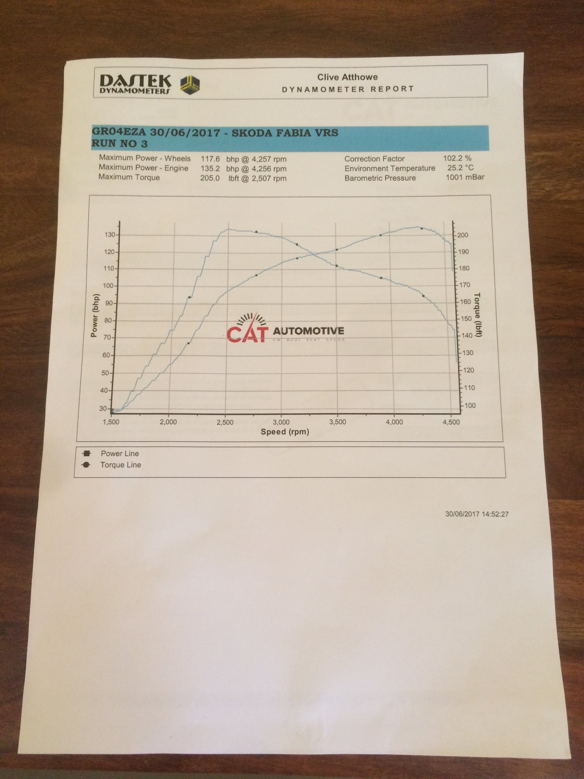

Just thought I'd add to this thread as I found myself doing some research recently suspecting a headgasket failure on a 2004 fabia vrs. Car had covered 115,000 miles.
First sign of an issue was the coolant light coming on. I let the car cool. When I removed the cap it was clear the tank had pressurised.
So I suspected head gasket had started to fail. After a week of coolant loss due to pressuring causing the tank to overflow I booked it in at an independent VAG specialist.
They did a chemical test and confirmed it was gasket at fault. Was due a cambelt anyway, so in some respects it was a good time to go.
So labour cost for for the job came in at £450 plus vat. They reckoned the head had distorted and needed to be milled. I was keen to have the valves re-lapped while the head was off; so the head was stripped sent for machining and rebuilt using all genuine parts £££much.
In doing this I read some **** on the internet about not skimming the heads on the PD engines as it'll be down on power etc. I was sceptical, but having never had any interest in ****ing about with Diesel engines, I'd not studied a PD engine in pieces. Therefore could not apply my understanding of engineering to the matter.
So I bit the bullet and paid the bill at Yelverton garage. Next step for interest more than anything was a dyno run at Clive Atthowe tuning. I'll attach a picture of the graph for those interested. It made 135 HP at the flywheel. The torque figure was down about 15 lb ft, but the guy who ran it said their dyno was inaccurate on torque figures and was usually down by 15.
So there you have my life findings on the subject of skimming a cylinder head on a PD130 engine as a matter of repair. No power loss to report.  Car runs well again, hopefully will get a few more miles out of it.

Runs No.1 and No.2?
That's an ASZ code rather than a BLT?
That mythical power loss is caused by not following the correct procedure for resetting all the unit injectors stroke after the head has been stripped for skimming and then reassembled, that and tiny variations in cam timing. Non-technical muppets putting the cart before the horse again I'm afraid.
Ah, good to know. Hopefully this clears things up for anyone who finds themselves in my position (where you wish you'd never read the Internet!).
Engine is ASZ.
