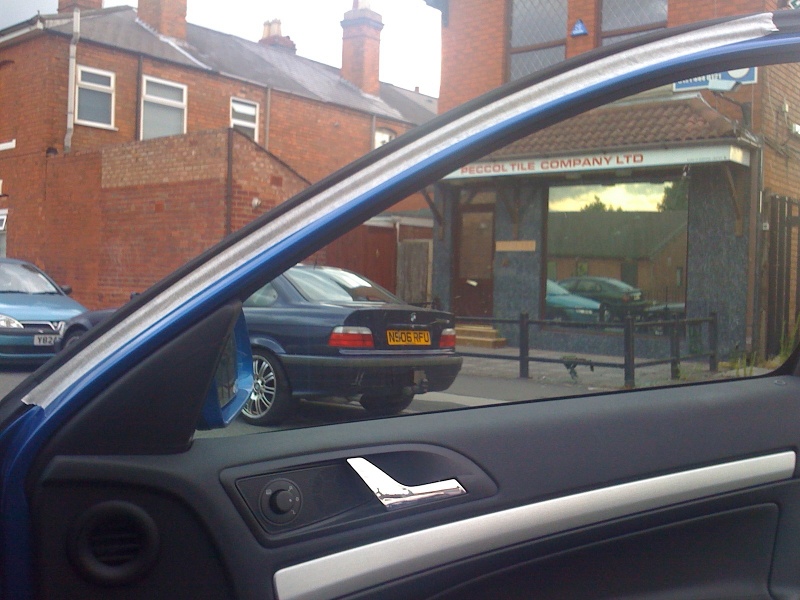

Anyway, here's my temporary fix for the howling...
Will change the tape every day or two til I get it sorted properly, will see if gmb's door adjustment works, and if so will get that done, if not, was thinking about adding sealant round the affected area to see if that helps...
