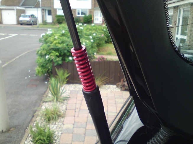

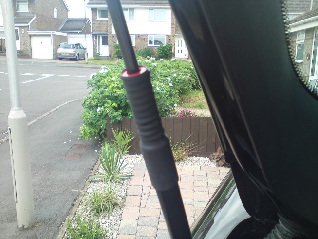

Heat shrink just arrived, I have attached a couple of pictures below........
Before:
After:
