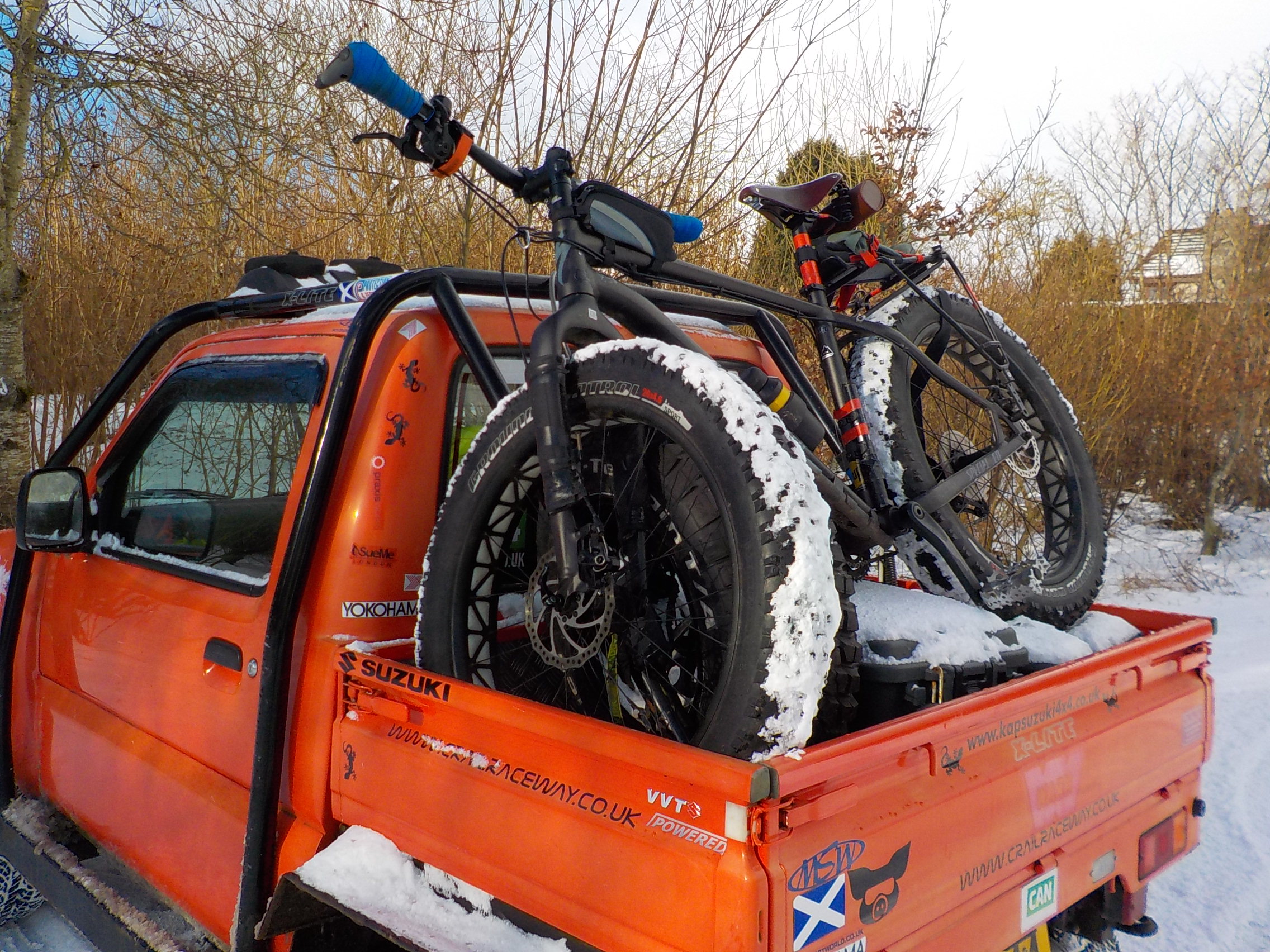

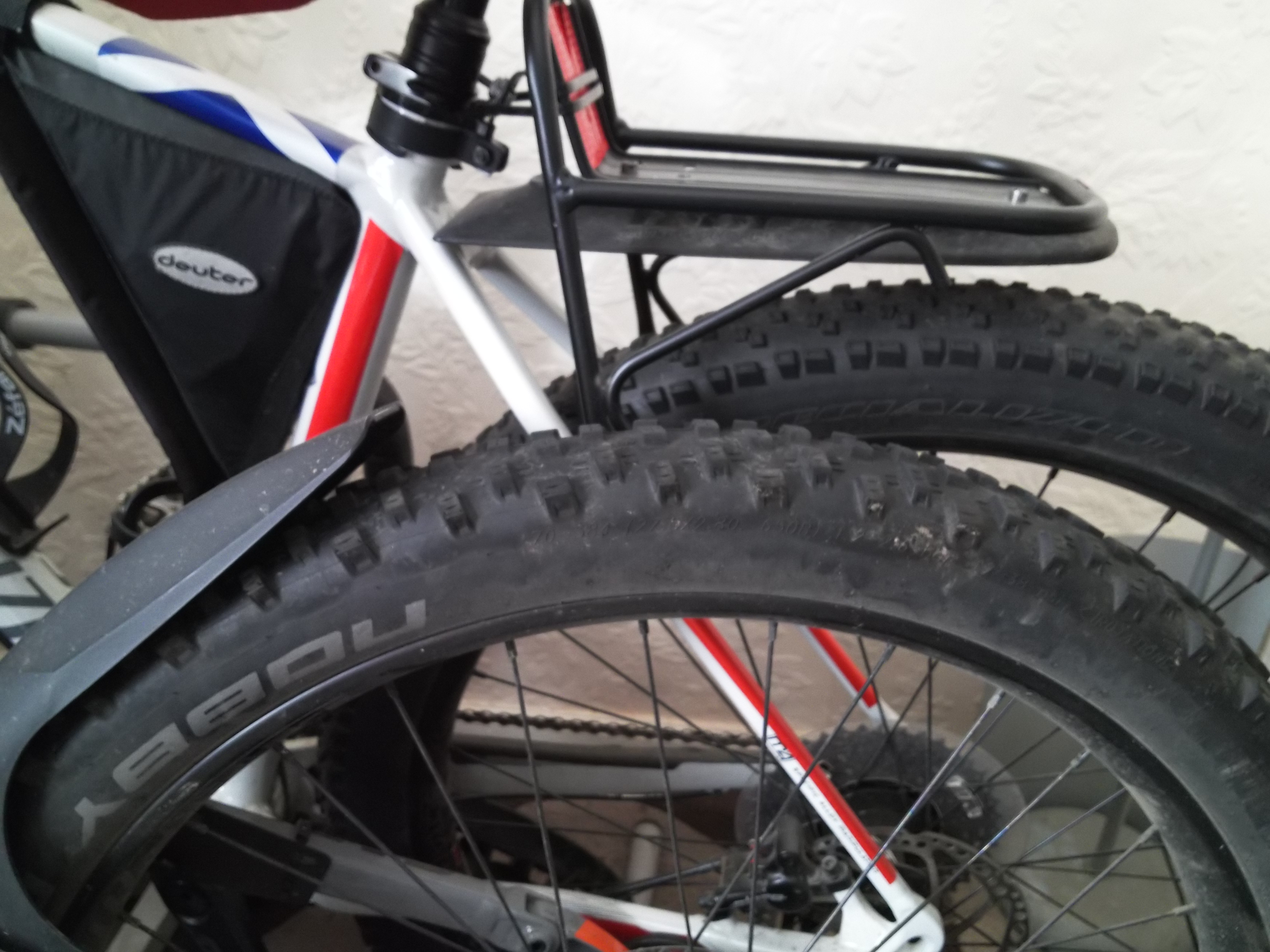

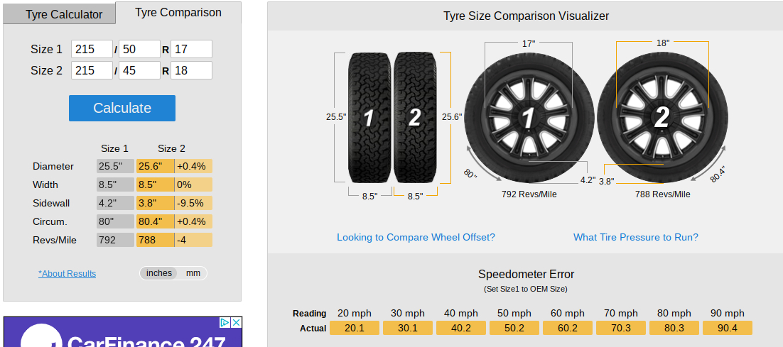

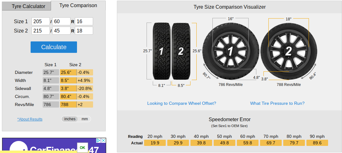

It will have been a man dressed as a woman with the same shoe size as a man or a woman.  Or a typo.
When it comes to bike tyres i have Plus Size tyres on 26" or 27.5 wheels and the circumference is the same and some tyres are the same width on the different rims.
Obviously a 20" BMX wheel and tyre are not going to ride over potholes in the same way.

7 hours ago, farty said:
But smaller wheels will drop more into potholes.
As said above, the smaller wheels have larger side wall and maintain the same rolling radius. It is the larger sidewall afforded by the smaller wheel that gives the greater cushion to the wheel and the car.

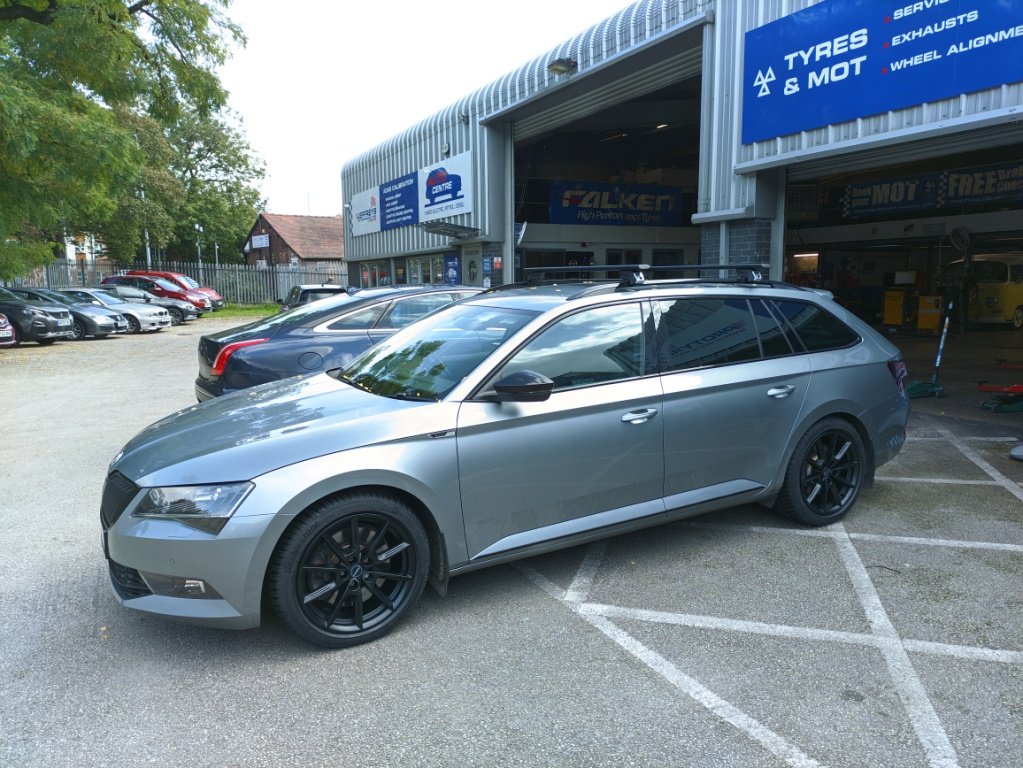

Falken Eurowinters x4 fitted 01/10/21 ,good drive,seem very good in wet and offroad,just waiting for snow now!!!
Well,seen a bit of snow both soft and frozen etc,got to say these seem as good as any I`ve had previously .Excellent.
