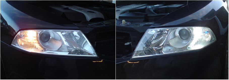

New Hids and Led Sidelights fitted

Oh and I fitted my 'Hauptmann' supplied LED's today, amazing difference, well happy. :thumbup:
Yeh, CANBUS friendly bought from HIDS4U around 2 years ago. One of the best mods I've ever done.

Not the actual bulbs but they looked like this

Popped mine in last night and well chuffed wth the result too :)
By the way I think it's hit and miss regarding HID kits being CANBUs friendly. I have a set that I bought about 3 years ago off ebay, cheapo set at around £50 in those days. It's a 35w set but said nothing about CANBUS but I wasn't bothered then as I was fitting them to a Mazda 6. When the Mazda died (RIP) I took the HID kit out and fitted it into my 07 vRS.
The result is mainly good. I have the auto lights option and roughly 50% of the time when the auto function calls for the lights to come on whilst the car is running e.g. if the light level drops or I exceed 90mph (which NEVER happens ;) of course) then the nearside light will fail to come on and I get bulb failure warning. This can be solved by turning the lights completely off, then back to auto and the lights then work. Under all other scenarios the lights are fine which is odd as the auto lights function will call for the lights when unlocking the car but the lights never fail under those circumstances.
I get round this by just running the lights always on (as if I had DRL function) as they switch themselves off with the coming home function so I never have to bother with them.
Anyway, next time I'm in Hinckley I'll get the coding done by Hauptmann so the light will always work on auto switching :thumbup:
