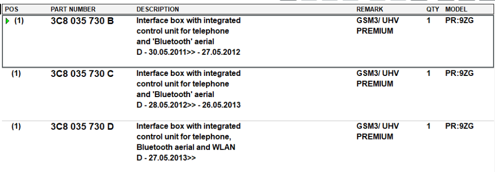

I have 3C8 035 730 version in my superb (Jan 2009).
Can I order either of these (5N0035730D and 3C8035730A)from ebay for to get the iphone to work.
Is there a difference between 5N0035730D and 3C8035730A.
Ive seen that there is no difference but if that is so why different part number.
Dave
There's no difference in the units apart from the numbers; the 3C8 belongs in a Passatt CC and the 5N0 is from a Golf or other VW / Skoda vehicle (so i believe)
As long as you have a White MFD, then you "Should" be able to go for either unit.
With regard to mcmug's post, i believe a firmware update is needed - i have the Audio and Phone logo's, but no where in the Media section of my Columbus to control it! - So i need an update too - but will get the dealer to do it me thinks.
Al.
