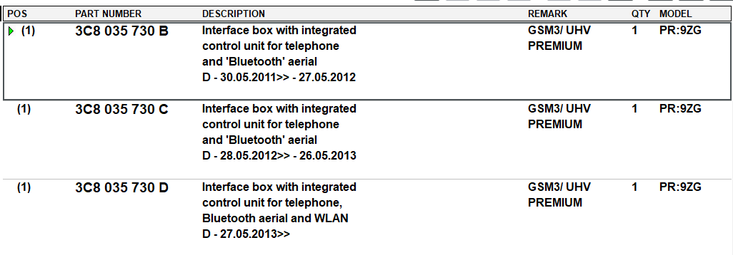

I am new to this but have had a look and couldn’t seem to find this info. I have a 2009 superb with a bolero unit currently no Bluetooth. I understand I need to get a 3c8 Bluetooth unit but how do I wire it in do I need to get a genuine loom if so does anyone know the part number please
Having removed my Bluetooth unit in the belief that it has died (it is a 3C8 035 730 B Novero made in Germany) can I replace it with a 'C' or 'D' as I find a few on eBay?
Can I take my removed original somewhere in E. Sussex to have it tested?
Cosmo J
Cosmo J
Here are the differences, the B part doesn't appear to show C as being an update (usually it will show if part was replaced and show new part number)
Make what you will of the following image.
