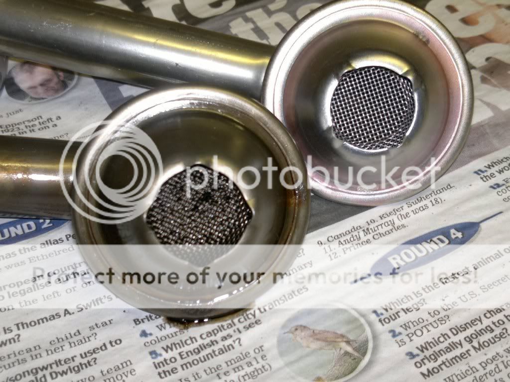

The pickup pipe was about 70% blocked, so well worth doing, and as someone else mentioned it should be a service item at about 50k I think.
Car is *definately* smoother, and seems to rev better now, so well it`s all good :thumbup:

Done mine today, a little bit of sludge in the corner of the sump & the pickup was partially blocked

False economy to clean this pipe and you may push crud up pipe and cause a blockage anyway. Not worth the risk. Replace every time at that price. :thumbup:

I did mine at the weekend and TBH didnt need doing. its done 101k on the same pickup pipe and only had oil change when the service indicated. Only had longlife oil in bar once on the 3rd service done by Skoda when the only did a 10k service so used Castrol Mag 10w40. I changed that when I looked at the service light for 0w30 again and had skoda reset the light back to longlife service.
There was hardly any blocked parts other than 2 bits of something in 2 of the holes.
I did otice tho that the sump had a lot of burned on oil ie the sump was very brown unlike Marks pic which seems pritty nice. Now the car is 100k+ I am going to go from servicing it every 18-20k(when ever the service ind comes up) to every 15-17k with Quantum III

I done this on mine last week, worth doing as mine was blocked up 115k on my vrs.
