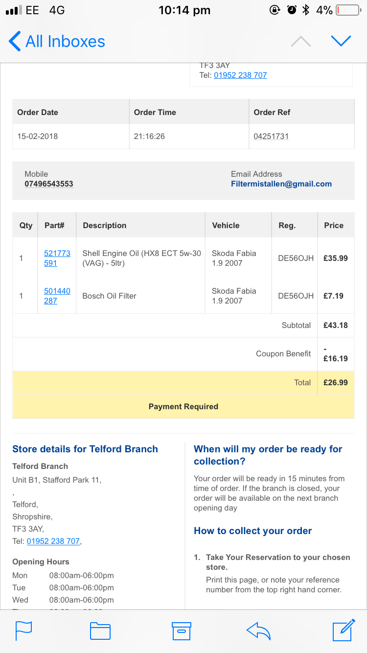

I have blt 2006 vrs Fabia recently went to euro car parts used promotional code got 5 litres of specified shell helix hx8 5w/30 with the car actually  specifies and Bosch oil filterI paid £28 for the LOT barging I do mine every 6,000k for the cost of the oil it’s nothing for the fact it’s givi g your engine best shot at lasting out longer takes 15-20 mins to do buy yourself new sump drain bold (£3) eBay for cortiena one. Warm car up whip filter out carefully undo drain plug get rid the black stuff careful put drain plug back in as it’s steel in to aluminium hand tighten it DONT OVER TIGHTEN it put your new filter in litrally clips in to housing lid put new seal on the lid screw back in torque it up to 25nm pour 3/4 of the 5liters straight in filler start engine for 30-45 seconds to allow oil to get around new filter knock it off again the let settle for a minute then slowly  fill to required level obviously don’t over fill it job done how I’ve always done mine this way no problems if your lucky good promotion on get oil and filter at a bargain price at worst cost you around £50-60 all in I refuse to pay someone £150 to do this simple task

Yeah, @Benjaminalski that was a dodgy recommendation for a PD 1.9, they need 505.01 oil, which what you bought doesn't appear to be.
If I were you I'd go back to ECP, tell them their rubbish look-up has caused you to put incorrect oil in your car and demand free replacement with a correctly rated one.

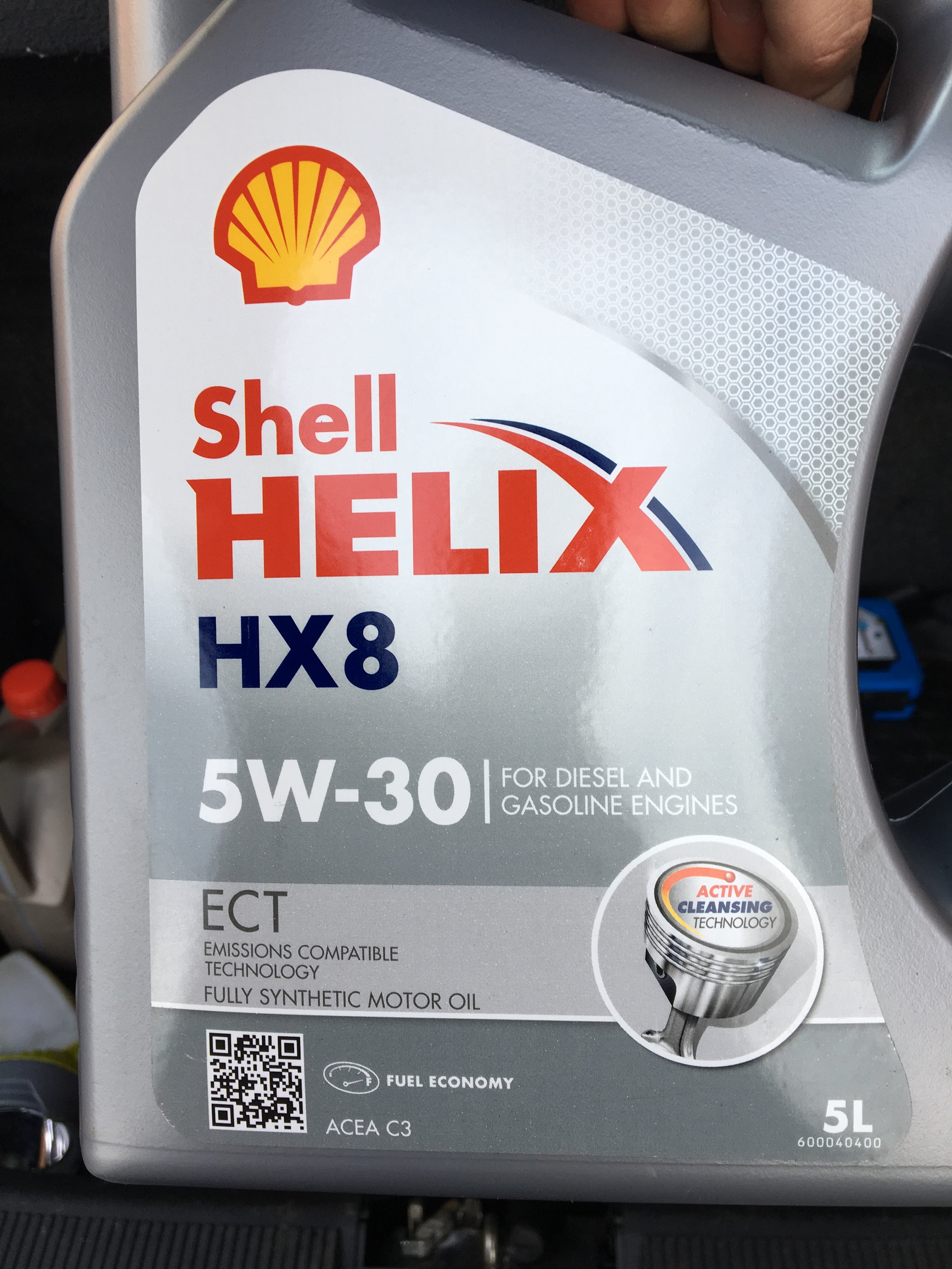

So is shell oil not good because when I lift my bonnet it’s plastered in shell stickers with Skoda on them in my eyes that’s says to me Skoda recommends to use that oil I use 5w/30 oil fully synthetic don’t see where I’m going wrong at all vag specified oil aswell last I checked shell oil was decent stuff I like to do mine every 6k well it’s gotta be better than tripple Q X lol runs ok so far do shell do a ecp oil out of interest thank you @Wino

Nothing wrong with Shell oils but the PD engines require oils that meet VW  spec 505.01. I believe that the one you've used only meets 502.00 and 505.00; check the container if you still have it.

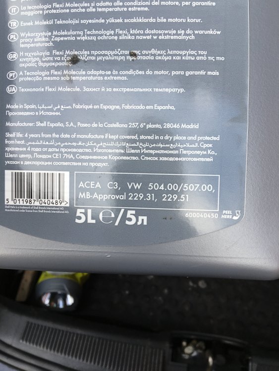

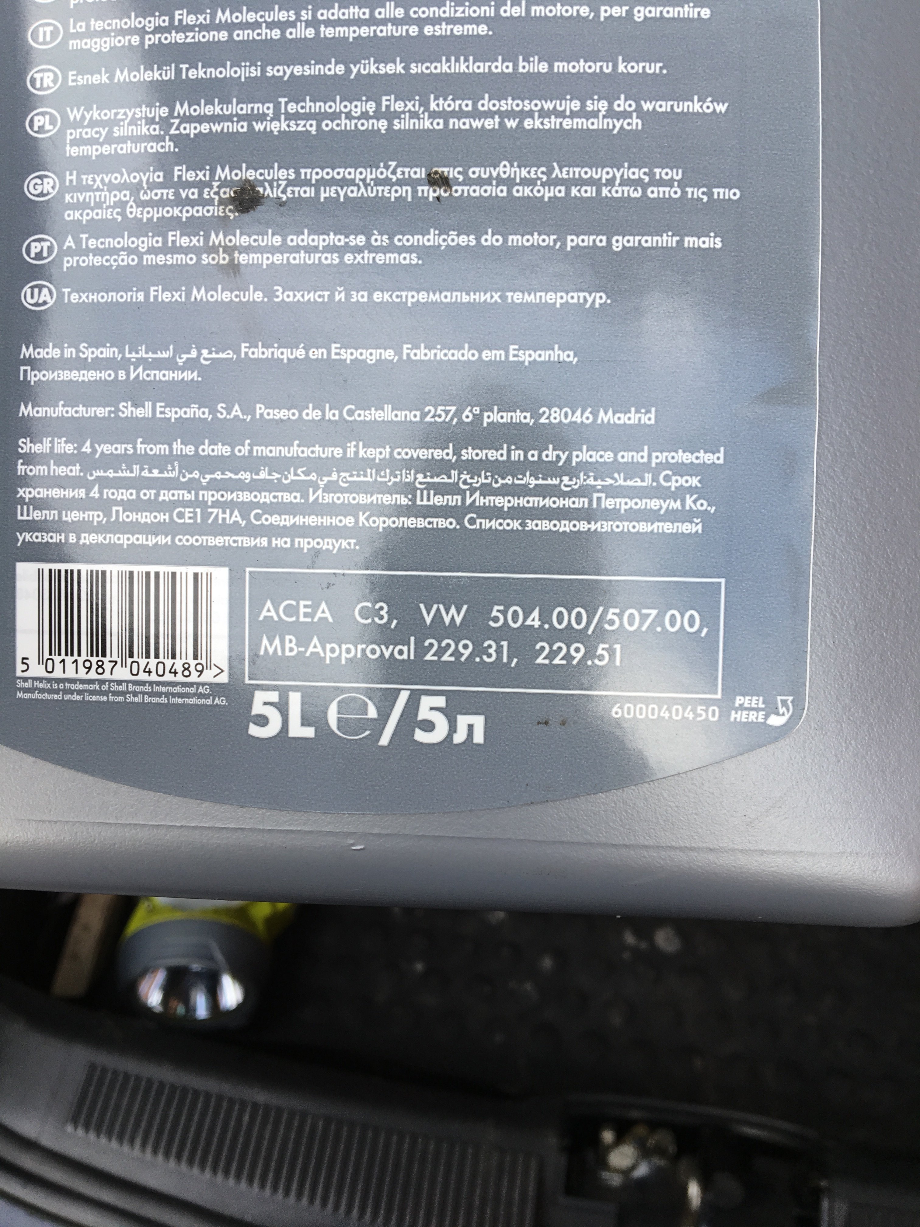

Oh, that should be OK.
507.00 is regarded by most as being as good as 505.01 in PD diesels. There has been a debate about it in a recent thread, but it's definitely better than the 505.00 that I thought the oil in your earlier posts was.

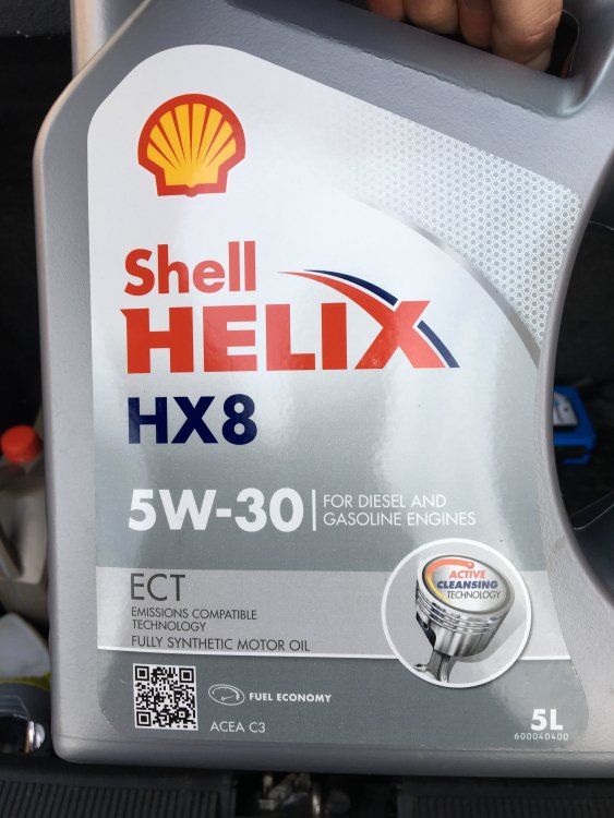

What does the front of that bottle say on it? Exact name?
@Wino ok that’s good and it’s says this could only find ect on euro car farts mate by shell

I don't have a similar car, but if I did I'd stick Quantum Platinum from ebay in it; very good value for money delivered to your door. https://www.ebay.co.uk/itm/Quantum-Platinum-5W-40-Fully-Synthetic-Engine-Oil-5-Litre-ACEA-C3-API-PD-Oil/192043732095?epid=1354064236&hash=item2cb6b2cc7f:g:PO4AAOSwnHZYQvdJ
In theory anything that meets or exceeds 505.01 spec will be OK, even from ASDA.
What you've used will be fine til the next change anyway, and arguably after that too. I think a lot of people use 507.00 grade oils because they assume that higher grade number = better; but in this context it's mainly more expensive; and a little thinner at operating temperature.
When I looked up Shell HX8 5W30 this morning I didn't include the 'ECT' bit, and that took me here, which explains my concern.
Apologies for the unnecessary alarm. :)
507.00 is just a later spec. as oil technology moved on the specs were updated, there's nothing wrong with 5W30, viscosity is irrelevant, it's all about the additives, SAE is an anachronistic viscosity standard designed for fat American V8's with slack manufacturing tolerances measured in inches.

Hx8 5w30 looks like the replacement for the Hx7 5w30, the latter being 505.01.
