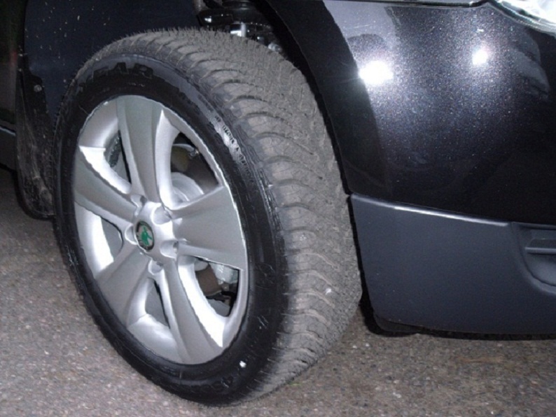

Our Goodyear 4Season tyres cost about £450 delivered from mytyres and £10 each to get them fitted.
That's the standard 17 inch Yeti tyre size for an SE or Elegance.
I know they are not as good as a full winter tyre, but don't feel we need a set of full winter tyres in the UK.
Our Yeti does 3500(ish) miles per year. With such little use I didn't want two sets of rims and tyres.
They handled snow and car park ice very well even though we have the 2WD version.
In warmer weather they have been fine. We did 400+ miles on a holiday weekend in +22c and I have no complaints at all.
The tyres are only a little noiser than the standard Dunlops. There is very little in it. Once I'd driven the car a bit I stopped noticing it.

My dealer changed my dunlops to Goodyear all season before i picked the yeti up, all i had to pay was the difference in cost of the tyres, at that time a total of wait for it £7.50 :giggle: in the end no extra to pay.
I have found that in the wet weather of late the goodyear all seasons do shift water very well, very little pull to the left or right when you hit a very large puddle, and the handling in dry warm weather is good as well will never go back to the dunlops. (hoping to find some mud soon to try it in but don't tell swmbo)
Also i like the look of them on the yeti

besides CT17 wakev is also running Goodyear Vector 4season and very happy with them so far as I understand. mbrock has the Nokian eNtyre and likewise happy with that set-up.
The Goodyear is full winter rated like the Quatrac 3, having the mountain and snowflake symbol. The Nokian however is more a cold wet weather specialist with a limited snow capability.
Quite sure in my own mind that either of these would be a better option to the standard Dunlop Sport 01 no matter what the weather.
