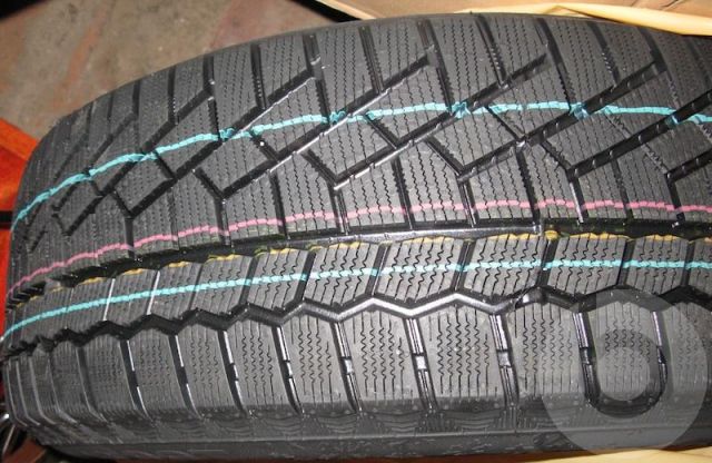

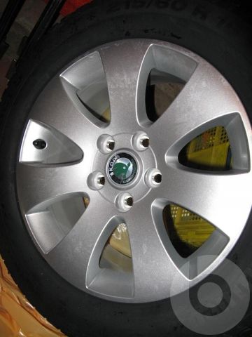

I got my new winter wheels on today, The only tool I used was a cup to take the free coffee my dealer offered
while they changed the wheels.
I was about to ask if you were being a bit premature, then saw your location. :D

Well you are not too wrong, here in Oslo they will not be needed for another month or two,
but I am off to a +4000 km trip to Nothern Norway, far north of the Artic Circle where I most
certanly will find snow on the roads.
