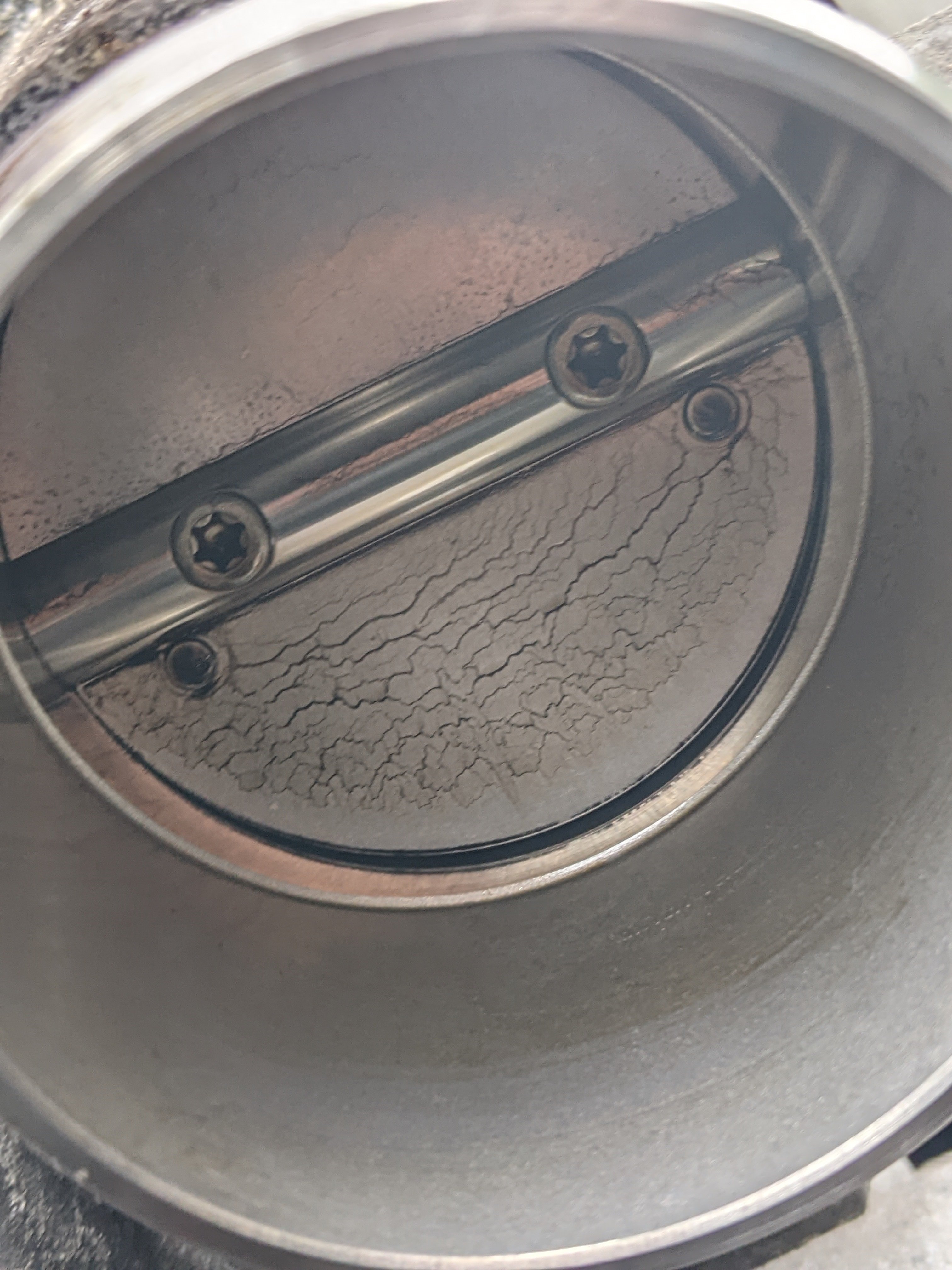

I've been a bit quiet of late so a small update is overdue.

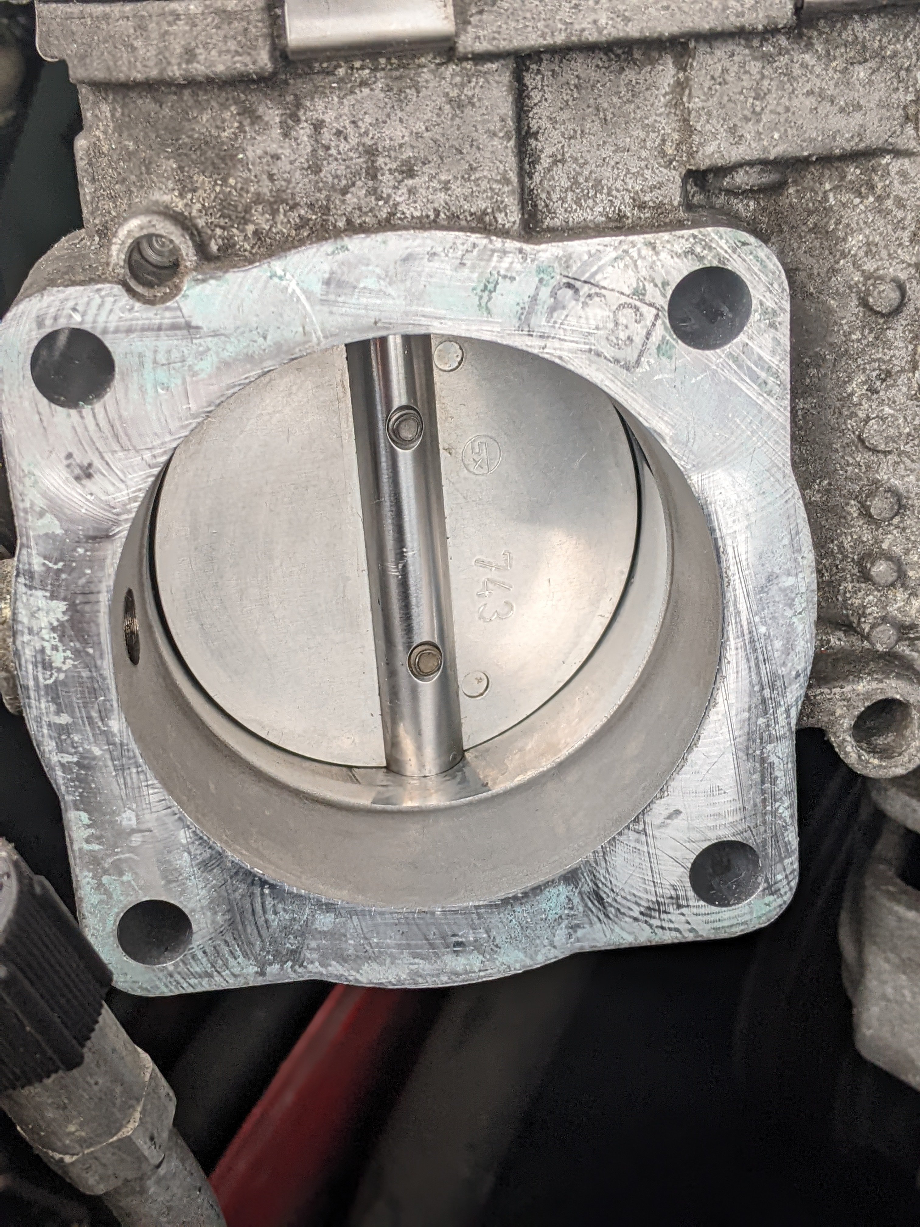

It was time to clean out the catch can again.  I've covered roughly 1200 miles since the last time I emptied it and as you can see, there was quite a lot in there again. It's quite a satisfying job when it's done as knowing all that goo wasn't going back into the engine.

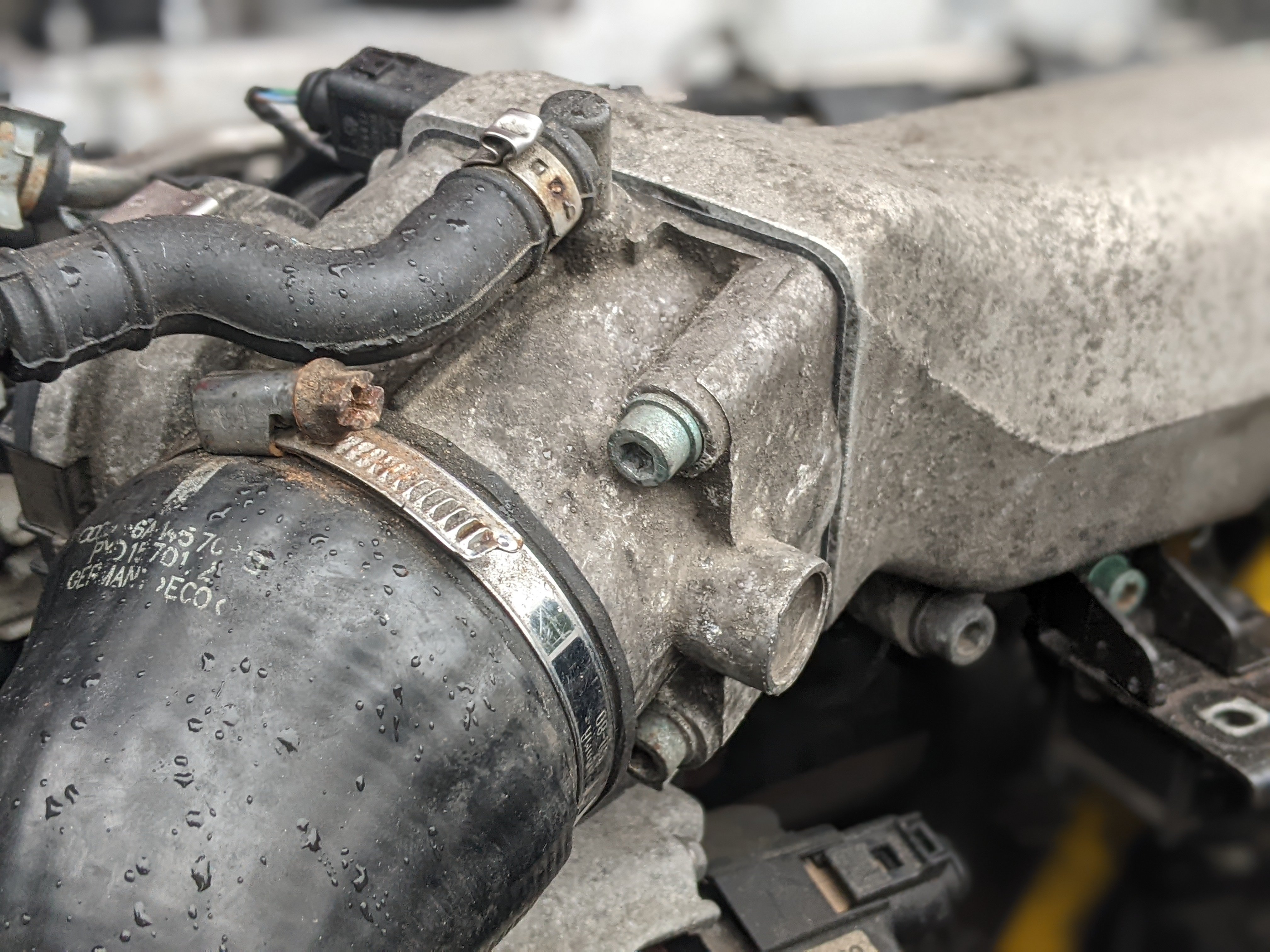

I also had an uncharacteristic problem yesterday.  The car took three attempts to start up in the morning.  It turned over, fired and then died.  Even when it did begin to run it was lumpy and felt like it was on three cylinders. Once it was up and running things were fine.
On the way home from work it did the same so I decided to clean the throttle body.  I already had a gasket in as it's on my list of jobs to do.  I knew that it had been done once already due to an earlier post by a previous owner.  I seem to recall it was somewhere between 70 and 80k so it was well overdue.

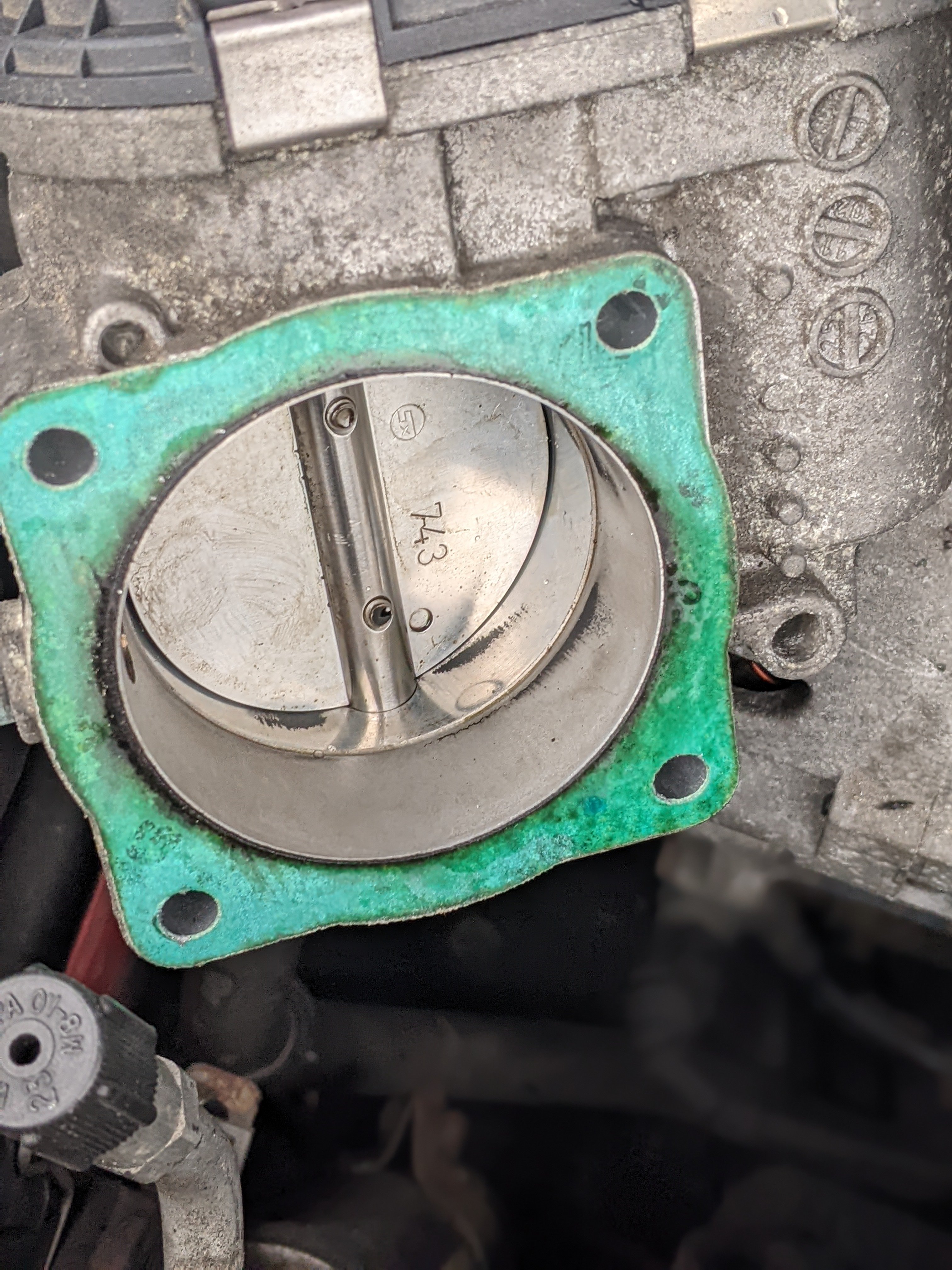

I took the hose off expecting to find things all gunked up but this is what I found.
There was a bit of build up but nothing too bad.  I did notice that the gasket wasn't visible with the throttle body in place and on removal it was a bit wet as you can see in the picture.
I cleaned things up anyway, removed the old gasket and put things back together.
I then left the car to sit for a couple of hours and fired it up.  It started first time and ran nice and smooth.  The real test will be in the morning so I'll let you know what happens.

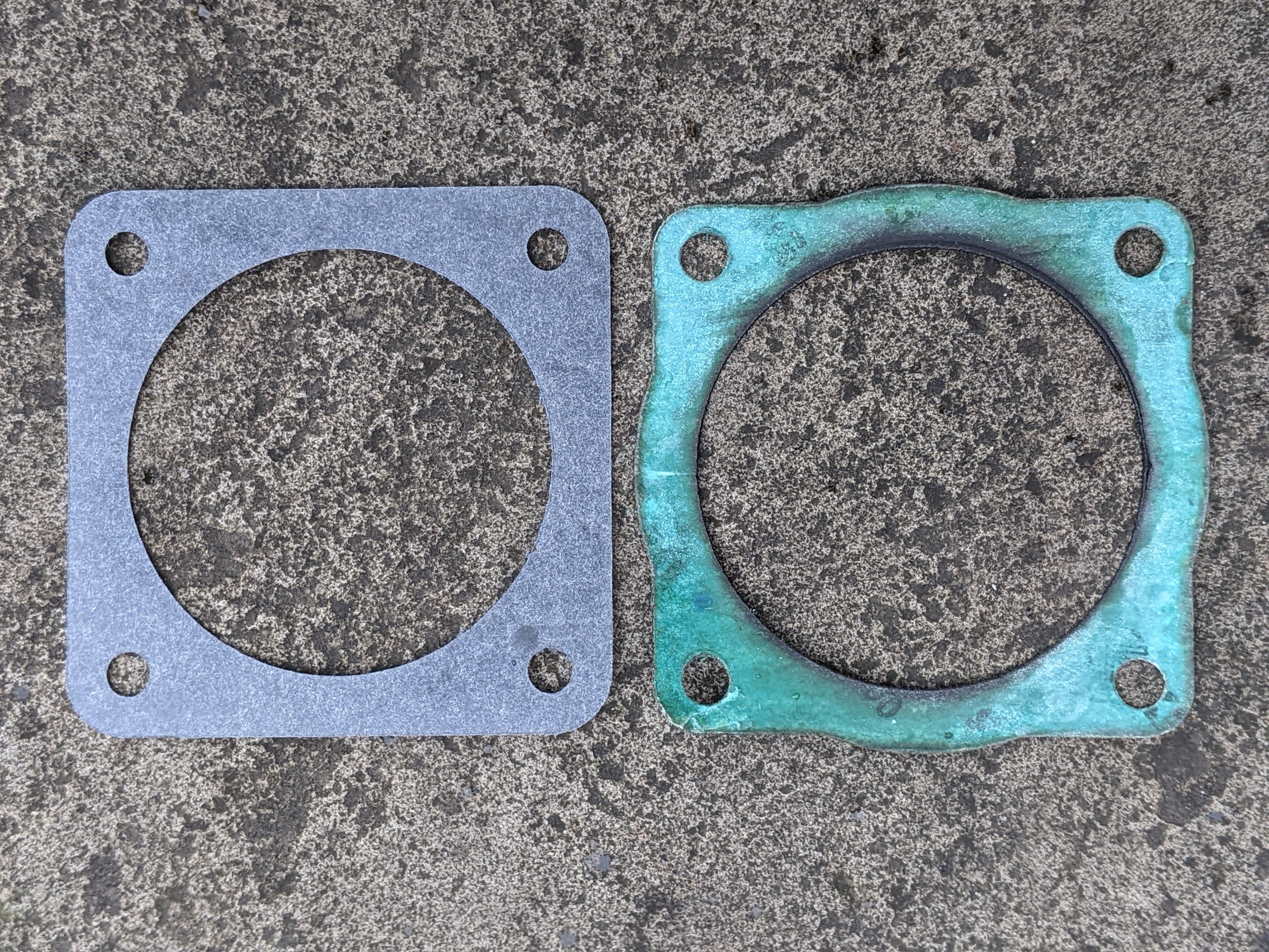

I've also attached a photo of the two gaskets for comparison as you can clearly see they are different shapes and that the new one is visible when the throttle body is in place.

Well, it's not sorted.  I've spent most of the day looking into this on the internet and it seems that there's a few possible solutions.  You're right in saying it could be the crank sensor as that's on my list.  So is the coolant sensor and a throttle body reset. I don't have access to VAG-Com so I'm hoping it isn't the throttle body.  I'll be onto my local Skoda dealer tomorrow for a couple of prices for the two sensors.  Some forums talk of a knackered MAF or fuel pump but I'll try to eliminate the less expensive stuff first.
I'm not too worried as it runs fine after the second attempt but reading a few posts on VAG forums suggests it could get worse and leave me stranded.  Luckily I have a van to use till this is sorted as I'm not keen on running cars that aren't spot on.
Update :
I took the car to my trusted garage this morning.  They did a scan which showed very little other than a slightly erratic reading from the coolant sensor.  It was on/off/on/off as the car was running and being scanned at the same time.
I popped down to my local VW parts department and luckily they had the sensor and O ring in stock.  I have fitted the sensor and the car started just fine but I'll have to wait till tomorrow to see if the problem has actually gone.
Fingers crossed.....
It looks like the new sensor has cured the problem.  After leaving the car overnight it started first time today, better than it ever has done to be honest.  I reckon the sensor must have been on its way out for a while as the difference in how it started and ran today was very noticeable.
It's amazing how such a simple component can affect the running of a car to the point where it won't start.

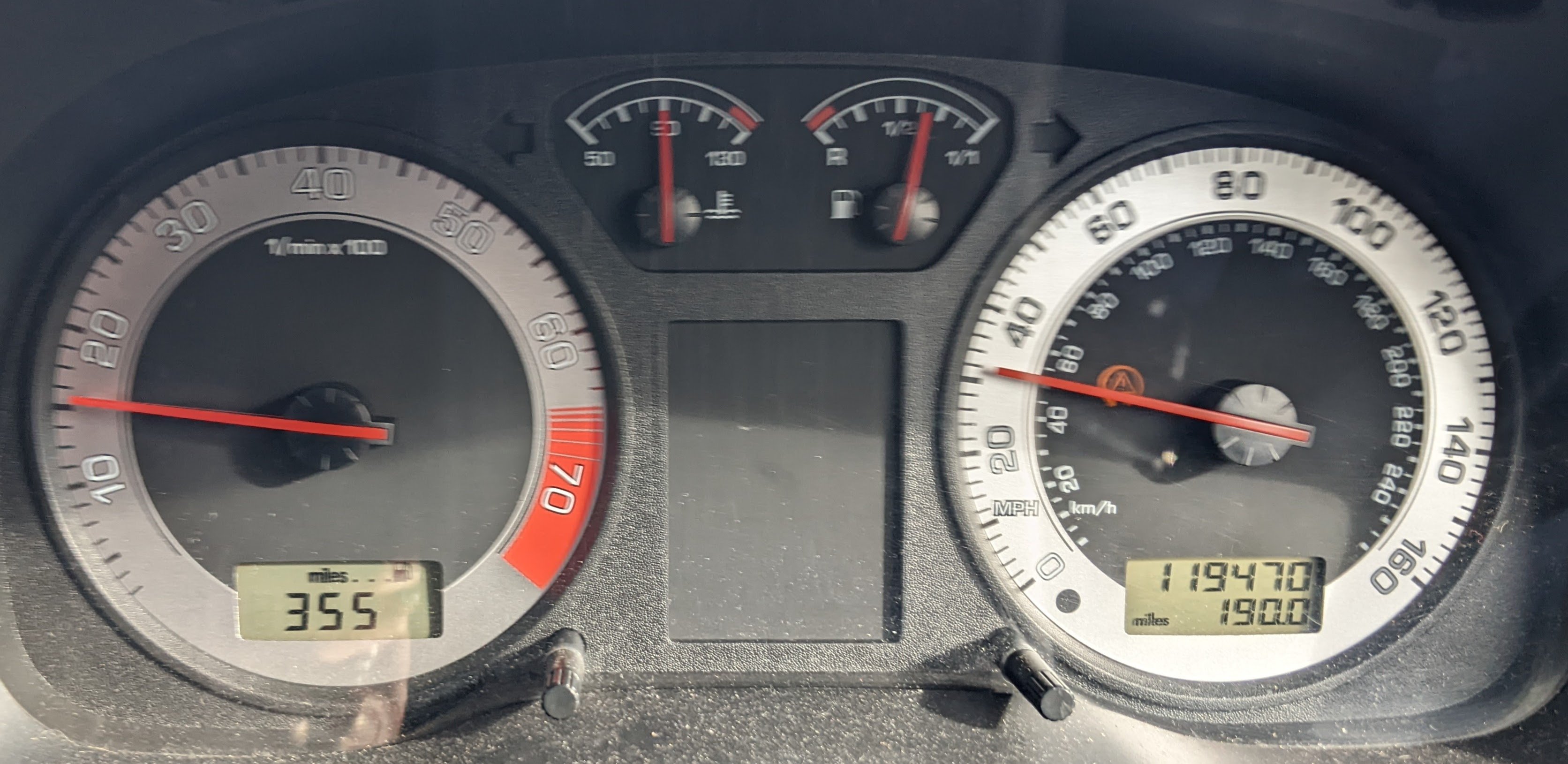

The car has been running fine since the sensor was changed so that's a bonus.

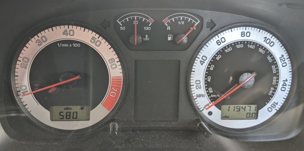

I've also noticed that the fuel economy has improved since, even on cold mornings.  My usual commute would give me just over 30mpg when the temp was around 5 degrees Celsius.  Since replacing the sensor with a genuine version, it is now around 34 to 36 mpg over the course of the working week.

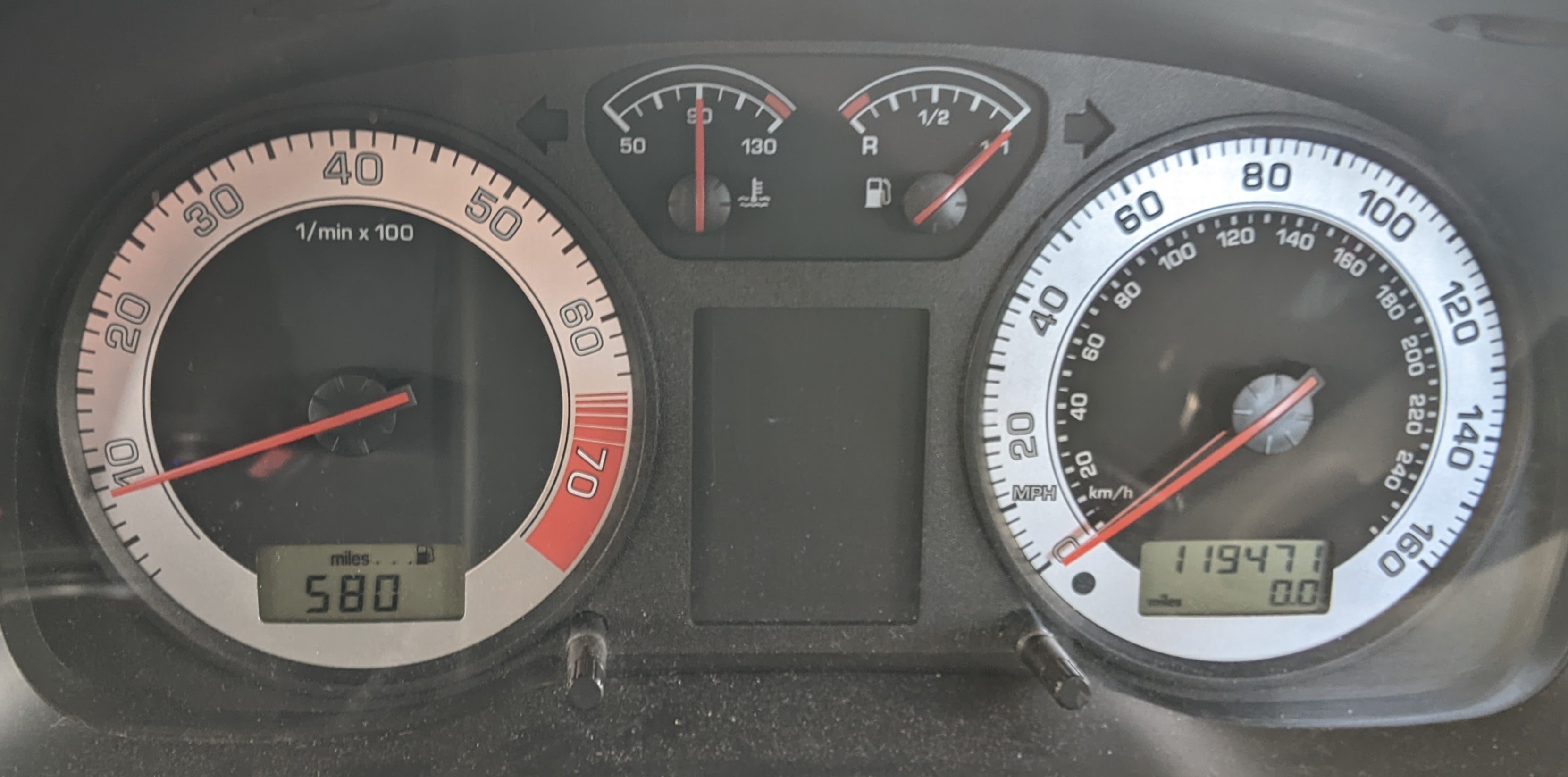

I did a slightly longer run today and was quite pleased to see the numbers on the trip computer were back to where I expected them to be.  I'd been dipping into the high twenties over a tank which was annoying, especially as I was trying to be careful.  Today's Fuelly fill up said the car had averaged 38.29mpg over 190 miles.  Admittedly the ambient temperature was 11 degrees but even so, that's much better.  The 190 miles had been a mixture of two long runs of 60 miles and the rest was stop-start traffic.
As you can see, there's a theoretical 545 miles from the tank according to the trip computer.  Don't worry about me driving and taking pictures either, the Mrs was the photographer.  I also turn the traction control off every time I drive the car as I find my right foot is safer than the on/off system the car uses by default.
Just after filling up, the computer thought I'd be able to get a whopping 580 miles out of a tank if I kept driving in the same manner as I had for the previous hour and a half.  The trip reading for the journey today was reading 47.8 just before I filled up.
I know nobody buys a Stage 2 vRS for the fuel economy but it's interesting to see what can be achieved if it's driven carefully.

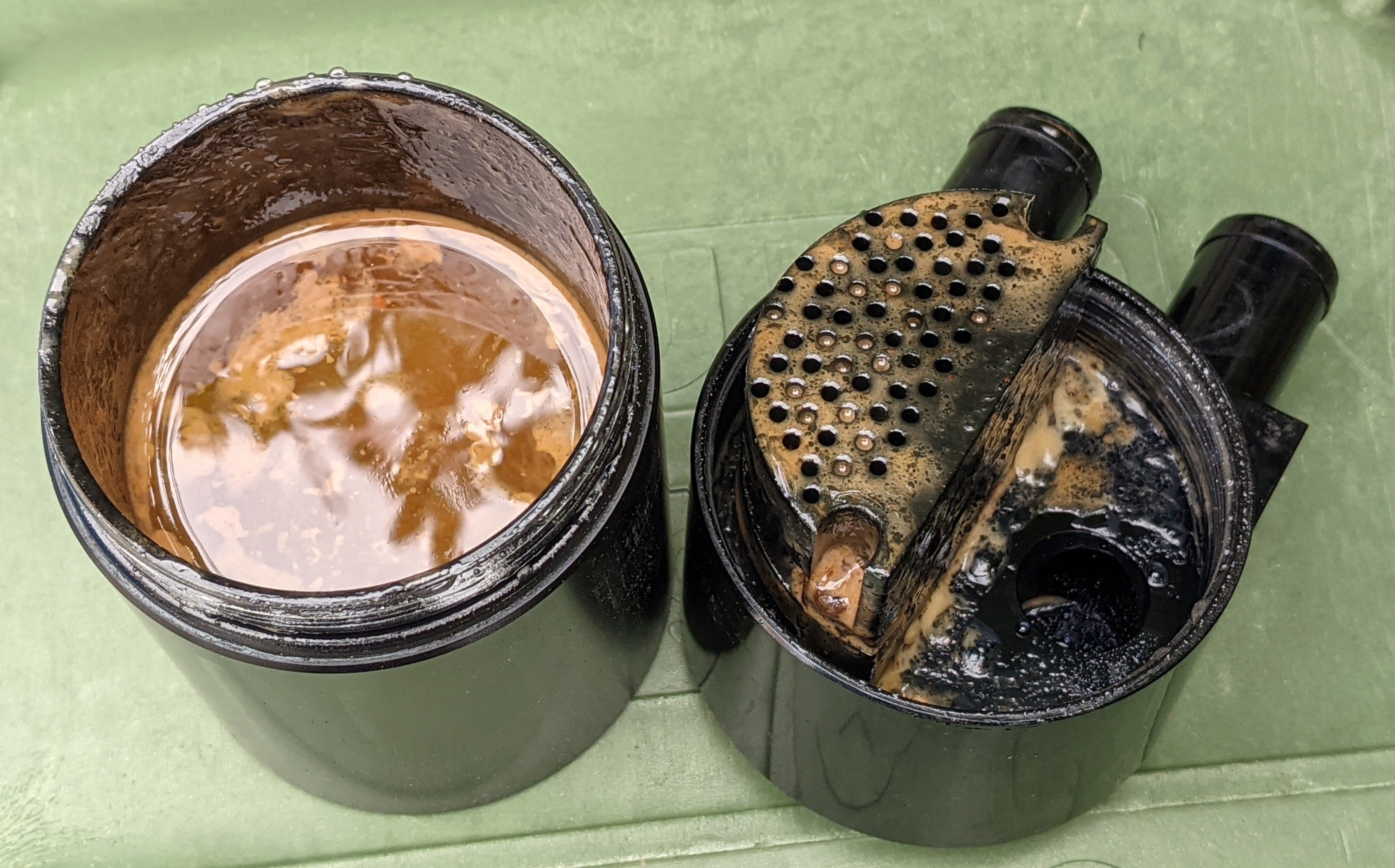

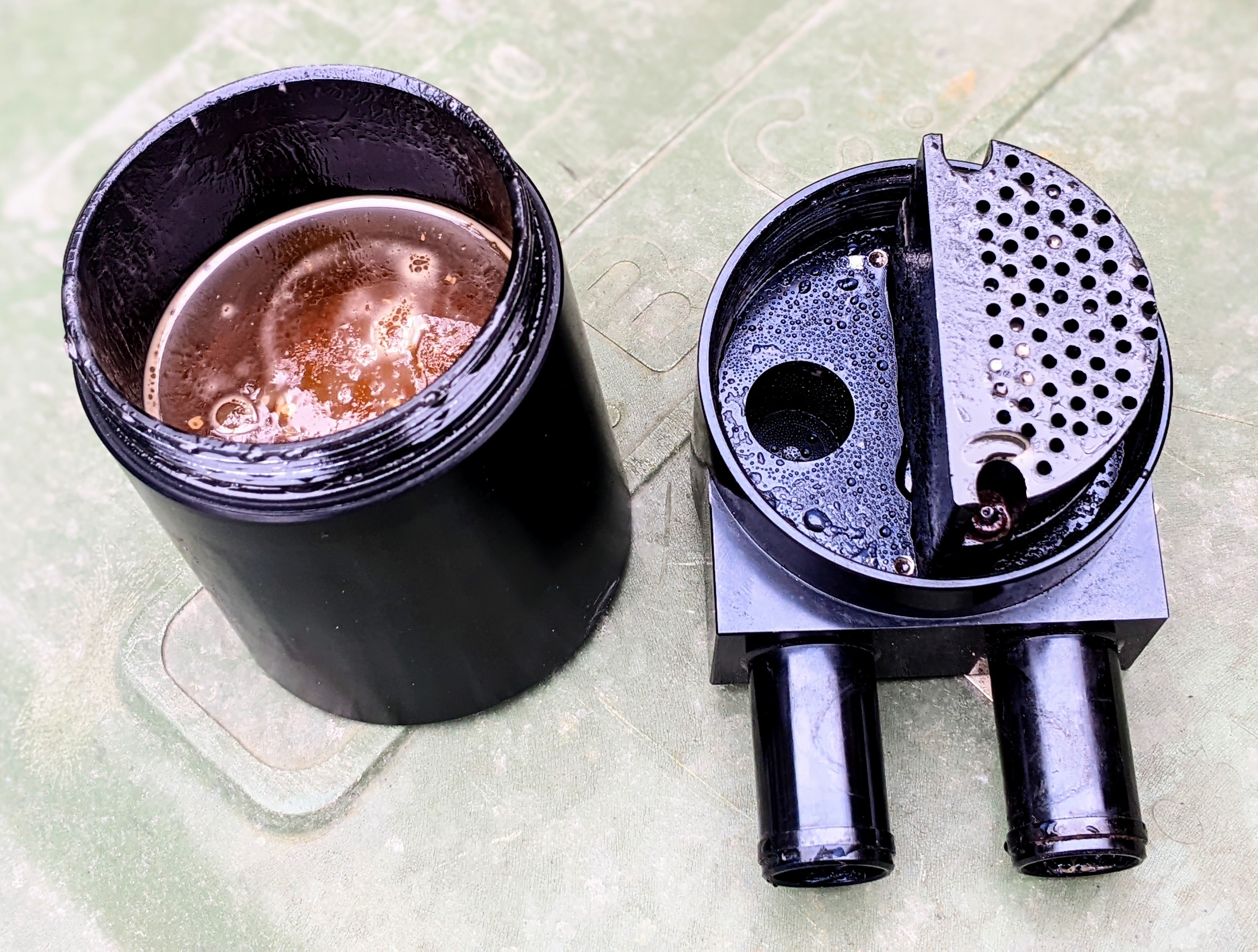

It was catch can time today.
The car has covered about 1000 miles since the last time I emptied the can and as you can see, it was ready for doing.  I'm surprised by how much stuff is in there but it's better to remove it than having all that going back into the system.
I have the same catch tank as yours bud, with all deletes, simplification etc and fill mine with a identical ammount of gloop with similar distance travelled.
Mine has just ticked over 117k overall.
That's good to know, as it always surprises me how much gunk ends up in there.

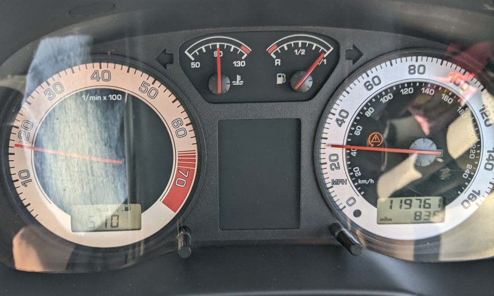

We did a trek over from Scarborough to Denby Dale yesterday.  I'd filled up with V Power at home before we set off and as always on a longer run I try to take it steady as there's no point in trying to rush in holiday traffic.  Anyway, here's yet another photo (taken by the Mrs) to show the trip computer as we were getting to the journey's end.  The car also said we'd averaged 49mpg as we rolled into Denby Dale.
Admittedly, I'm being a bit obsessive about this at times but it's good entertainment on a longer journey to see what MPG I can get.  There was the occasional use of the right foot to get into traffic or to relieve the boredom otherwise I might as well have taken the diesel van but on the whole the journey was calm and efficient.

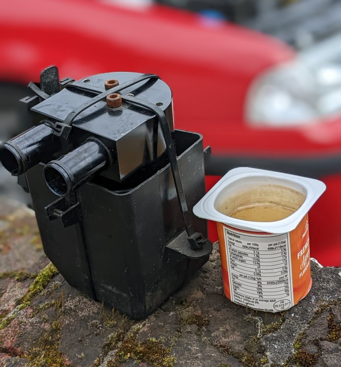

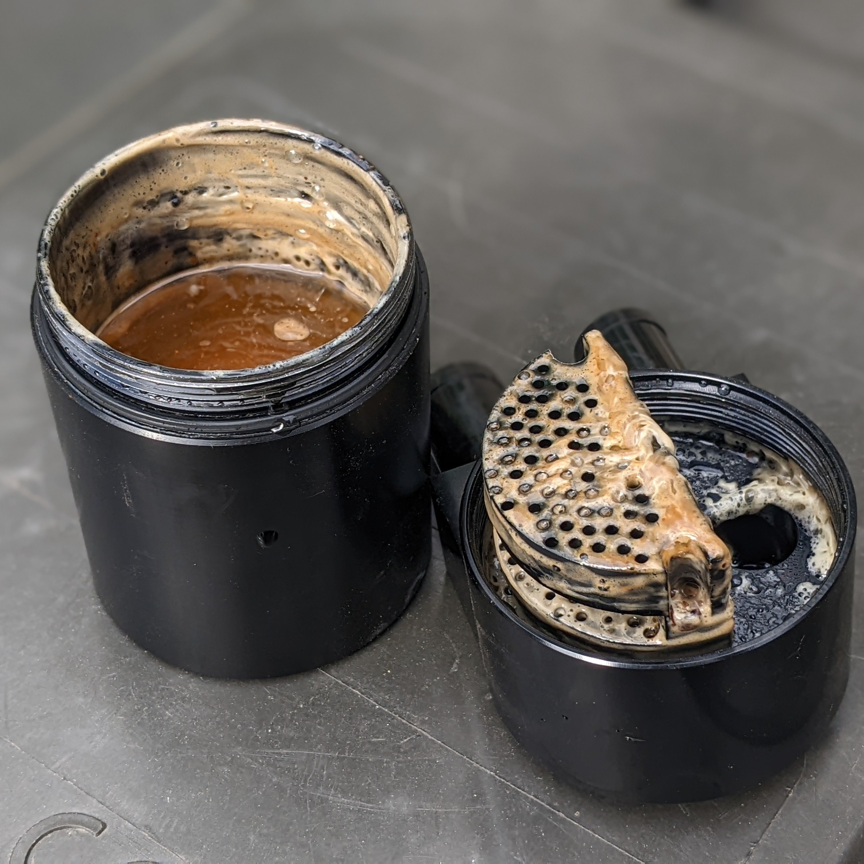

Catch can time.  Lots of gunk in there for some reason but as I have said before, at least it's not going back into the engine.

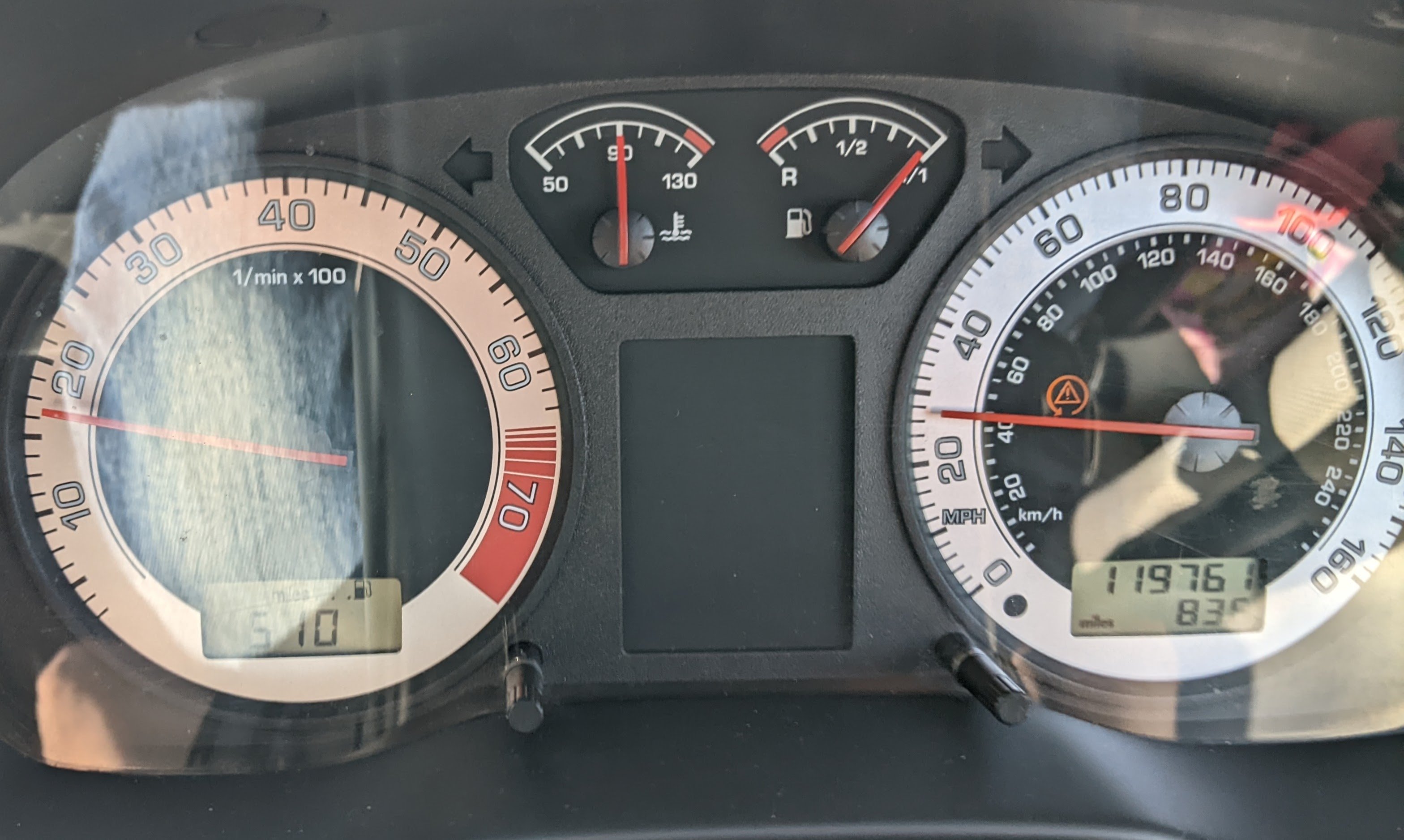

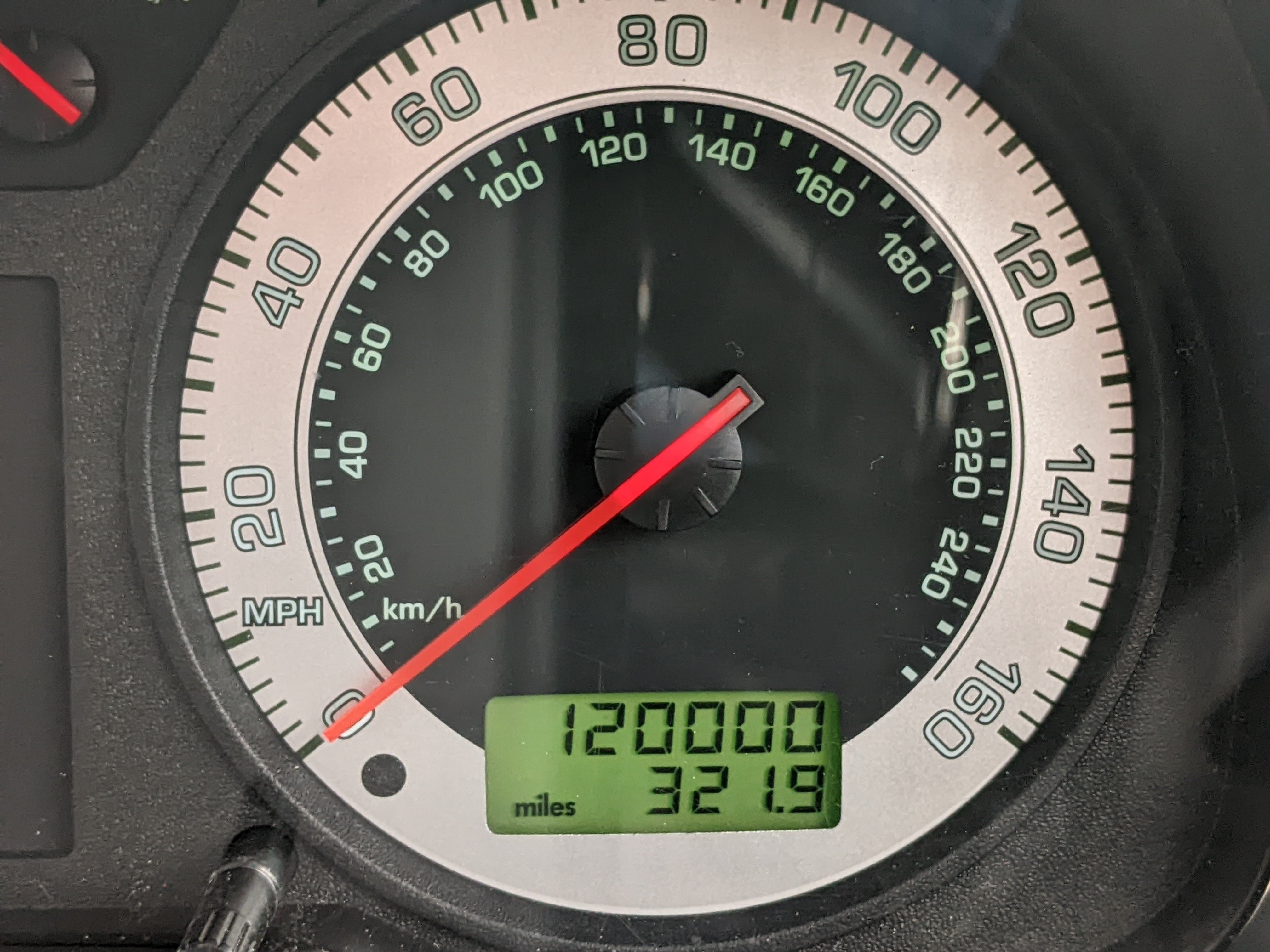

Also, the car tipped over the 120k mark at the weekend.  Sounds a lot but that's an average of about 6300 miles a year, which isn't a huge amount I guess.

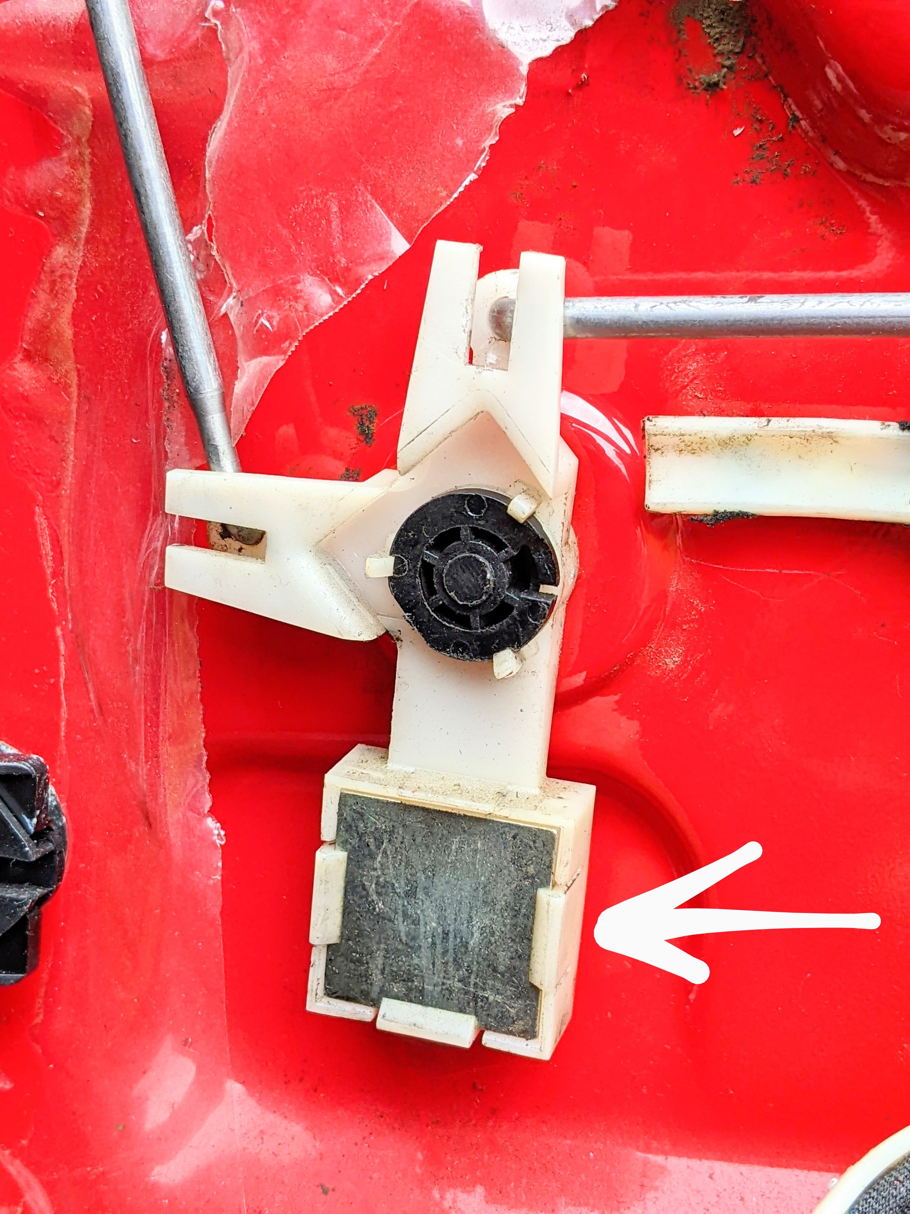

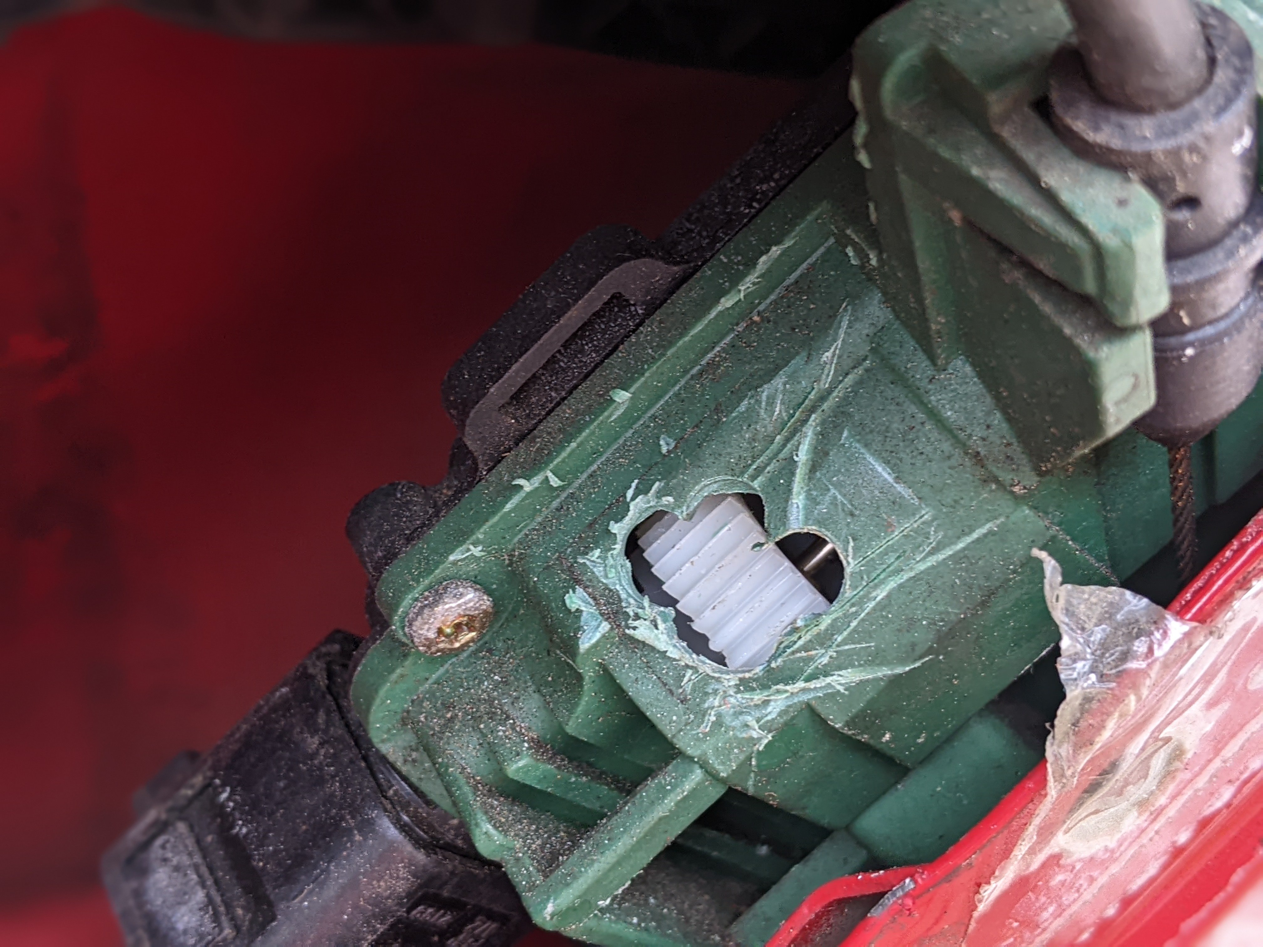

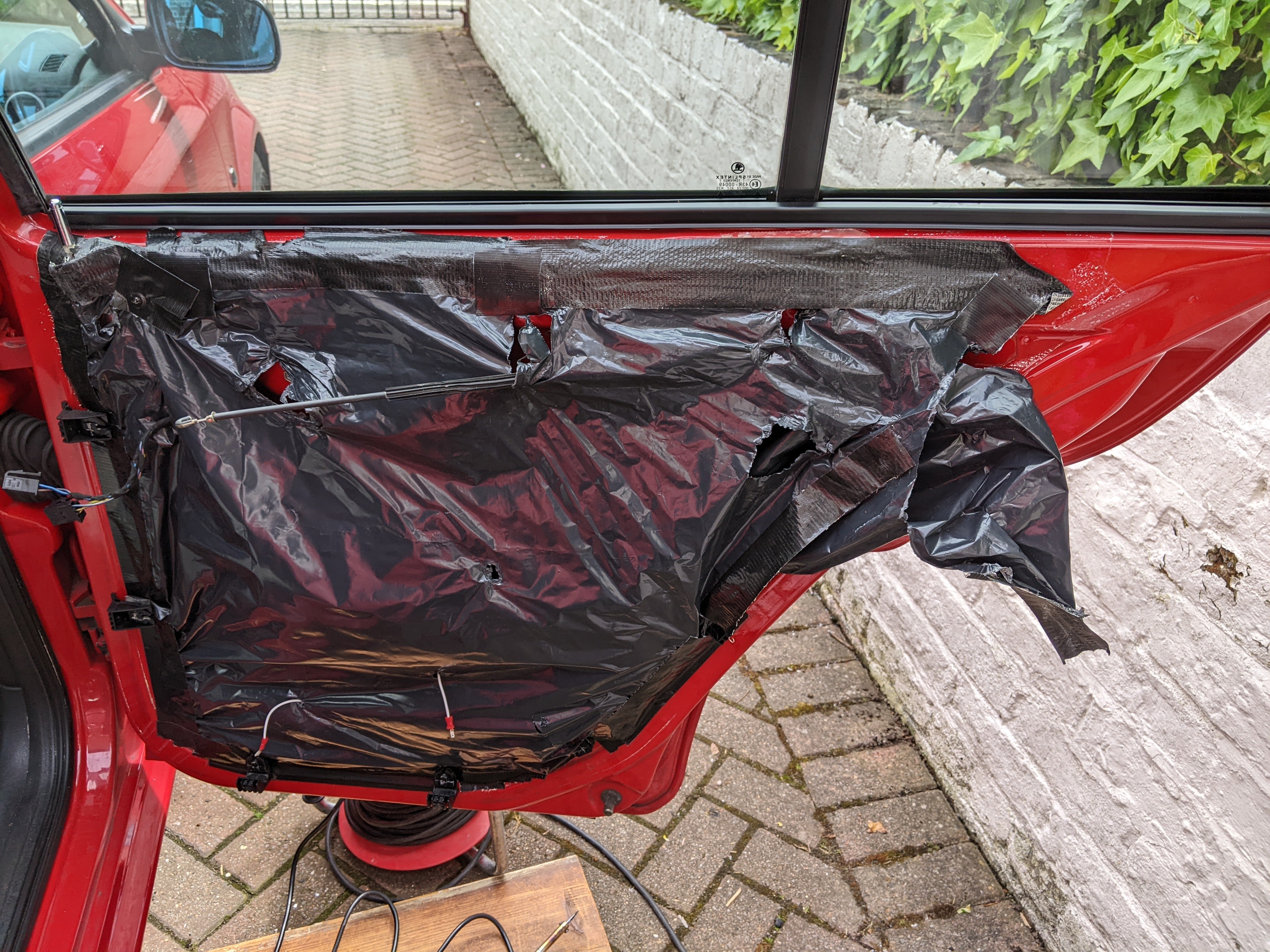

It was bound to happen at some point.  The rear offside door deadlocked itself during the week with no prior warning- maybe it was the shock of passing the 120k mark the other day.
Whatever, I had to get it sorted as the MOT will be coming up soon and a deadlocked door is an instant fail.  I looked around on the forum for guides and set about taking the door card off from the inside.
To be fair, it was fairly simple & nothing broke or snapped in the process of removing the card.  I was a bit surprised to see that the membrane behind the card was an old plastic bag.  Having said that it must have been doing a good job over the years as there haven't been any issues of water ingress.
I then tried to get into the lock mechanism with a blade but in the end it needed drilling.  Once I'd wound the lock far enough the door popped open.
All I need to do now is order a new lock from Ebay and fit it all back together.  I'll not be putting the door card on until the new lock is fitted, just in case.
Edited by skinnyman

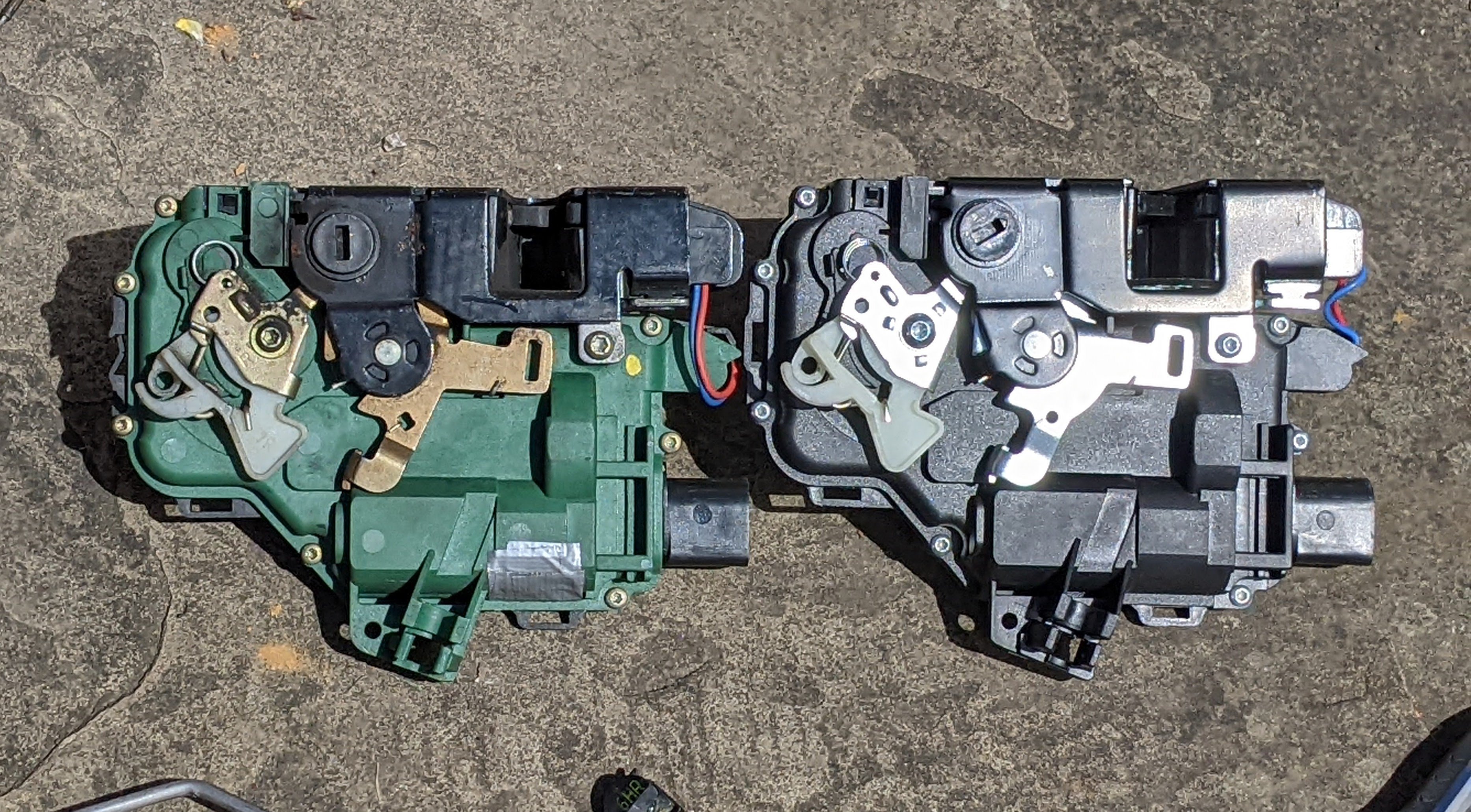

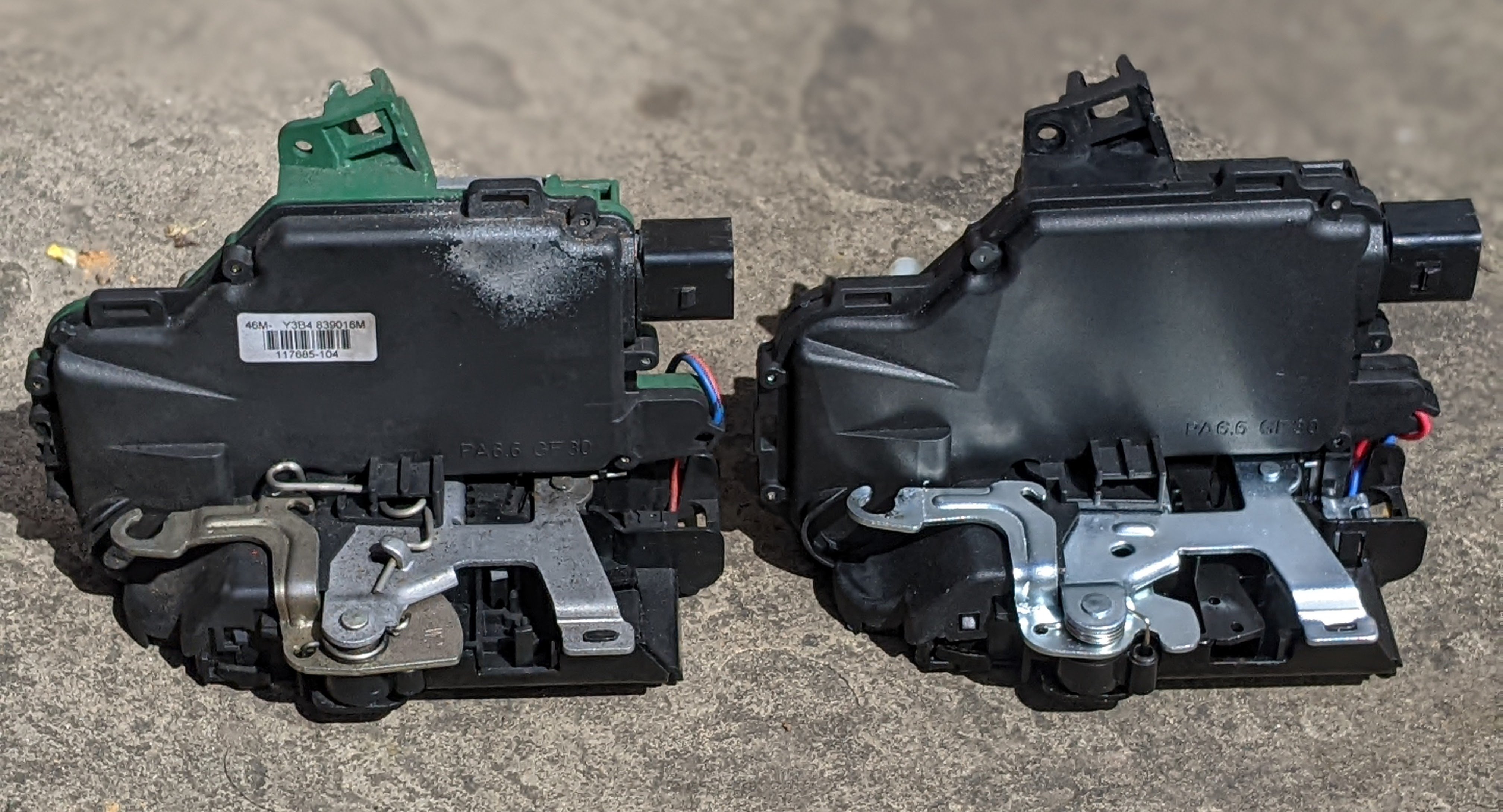

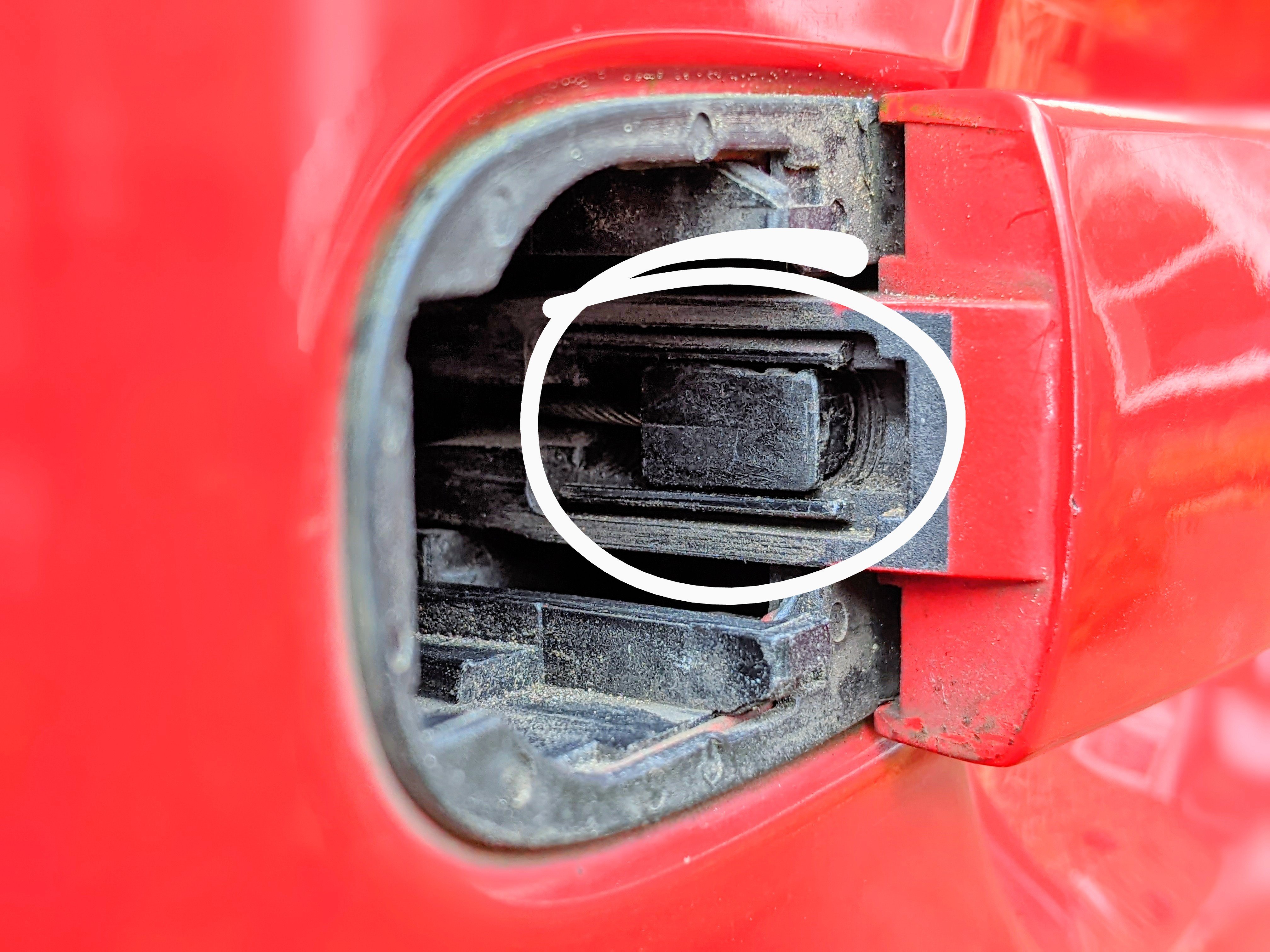

I might need a bit of advice on this one.
The new lock mechanism turned up during the week.  I had a bit of time today to swap the old for new as it only takes about 15 minutes at the most.  I checked the two mechanisms side by side first and all seemed well.  The replacement wasn't exactly the same, as you can see there's a spring not fitted to the replacement.  However, this doesn't seem to affect the working of the lock so I went ahead and fitted it.
I felt quite happy with things until I pressed the key fob to lock and then tried to reopen the door.  It was deadlocked.
You can imagine the language that followed so I'll spare you having to be exposed to that.
Anyway, no matter what I tried the door just wouldn't open.  I was just about to drill the new mechanism to wind it back manually and the car locked itself as it does when you haven't opened the driver's door after unlocking it.  I unlocked the car, tried the rear door and it opened.
Now the sensible thing to do would have been to stop and think, except I shut the door and locked the car to see if it had decided to work.  Deadlocked again.  So I repeated the unlocking without opening the driver's door a few times and on the fifth attempt the rear door opened.  This time I took the lock out and refitted the original as it was working just fine despite having holes drilled in it.
Half an hour before this, the original was working perfectly but on refitting it and locking the car, it now decided to deadlock itself!
I've tried using both locks manually whilst unplugged and both are deciding to deadlock for some reason.  Both work intermittently by using the old trick of banging the door in the right place.  Both old and new mechanisms are acting in the same way when plugged in and when not plugged in.  I'd understand if one was doing this but both mechanisms are acting the same way and it's driving me a bit crazy.  The door loom looks fine and in fairness it's been working perfectly all week.  I've stopped for now as I needed a break before I lose the plot.  The car is unlocked and the rear door opens at the moment.  It's on the drive behind the van so it's not going anywhere but I'd rather have it locked overnight.
Does anyone have a clue as to what's happening and what I could do next?
Edited by skinnyman
I've figured it out.
It took two cups of coffee, some flapjack and a bit of logical thinking.  If both mechanisms were doing the same thing, it must be me who's doing something wrong.
In the end I realised that the pin mechanism that goes up & down has to be as far over as possible to the left when unlocked.
Then I figured that the tab that fits to the handle needed some fine tuning. Too far in & the door wouldn't open. Too far out and it moved the pin mechanism out of position. Get it just right and it works!
Edited by skinnyman

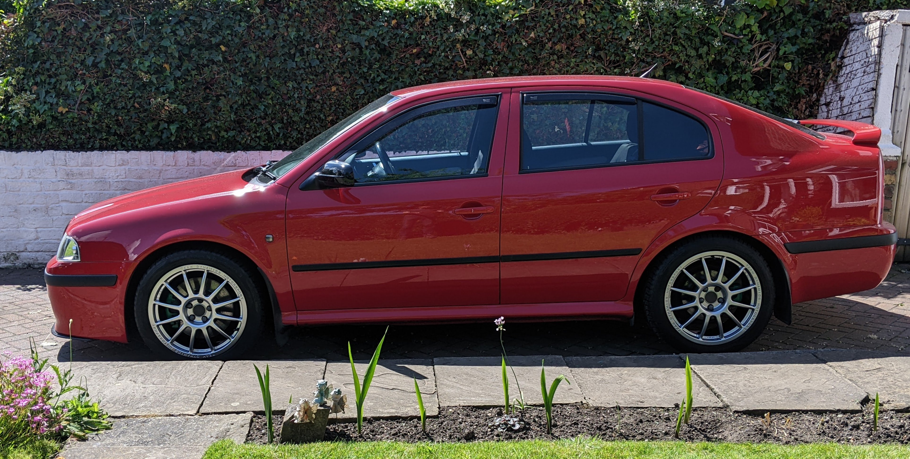

The tyres had been rubbing on the rear arch liner, it was minimal rubbing but still, it's not something I am too keen on.  I decided to put the old Pro Race 1.2 wheels back on until I can figure out what the next move is.
I can't decide if I really dislike them or if I've just got used to the 18" OZ wheels.
Personally I think they look too small, despite them being the same size as the 17" Spiders.  I prefer a wheel that's flat or dished and these are convex .  This particular shade of silver looks quite cheap and a bit bling and compared to the OZ wheels, they look quite fussy/frumpy.  There is one bonus, they have pretty much new RS3s all round so I've got about two years of driving left in them.
I think I know what I need to do to stop the rubbing.  I can either run the OZ wheels without 15mm spacers but that looks wrong with them tucked into the arches.  I just need some 12mm hubcentric spacers and the 3mm difference will stop the tyre making contact with the arch liner.  That's my theory anyway as I did some basic maths based on the two sets of wheels.  The ET on the OZ wheels is 45 and on the TD wheels it's 48.  The TD wheels are on the 15mm spacers and after a spirited drive yesterday to get used to the difference in handling I couldn't see any evidence of rubbing on the RS3s.  This may be totally wrong but it's worth a try.
I have two sets of H&R 10mm spacers and thought about running them but they don't fit on the rear hubs.  They aren't deep enough to fit over the lip on the hub so they won't sit flush & rock from side to side.   I looked at the cost of some 12mm hubcentric spacers yesterday and was quite surprised to see that they are almost £90 now!
I also need to replace the tyres on the 18" wheels and am undecided on what to go for.  They currently have Michelin PS4s which I think are an amazing tyre in the right conditions.  However, for six or seven months of the year they aren't much use and I have to tiptoe around on them, waiting for the temperature to rise or the roads to dry.  I used to like the RS3s but after the drive yesterday I realised they are nowhere near as capable as the Michelins.  I looked into some all season tyres as we have them on the van and after three years I can't fault them for year round performance.  I know that the American market can get performance all season tyres but unfortunately we can't over here which is a shame.
So, I'll let you decide if the TD wheels are wrong as I'm not sure I can live with them for various reasons and I'm off to try and source some 12mm spacers.
Edited by skinnyman
