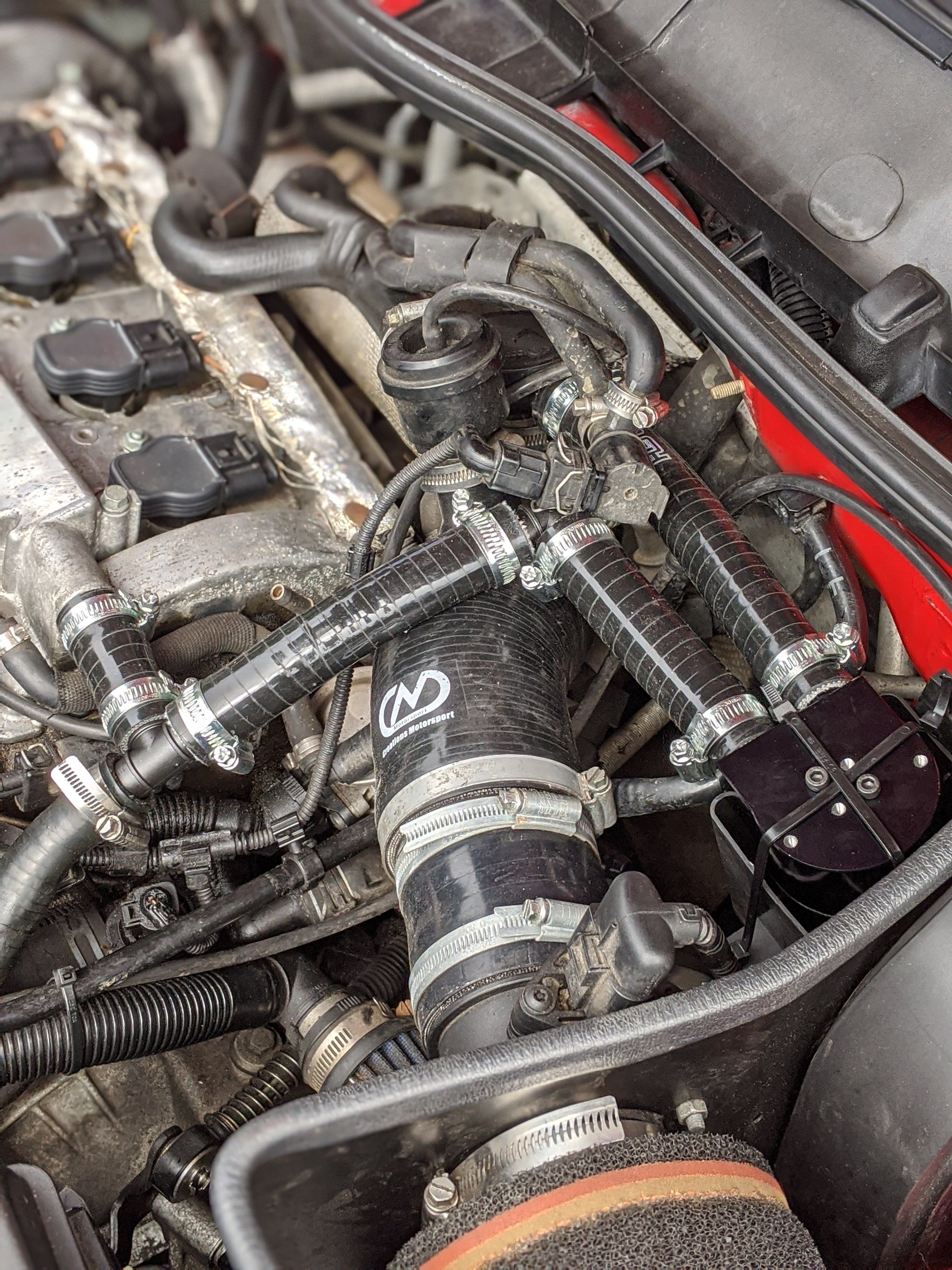

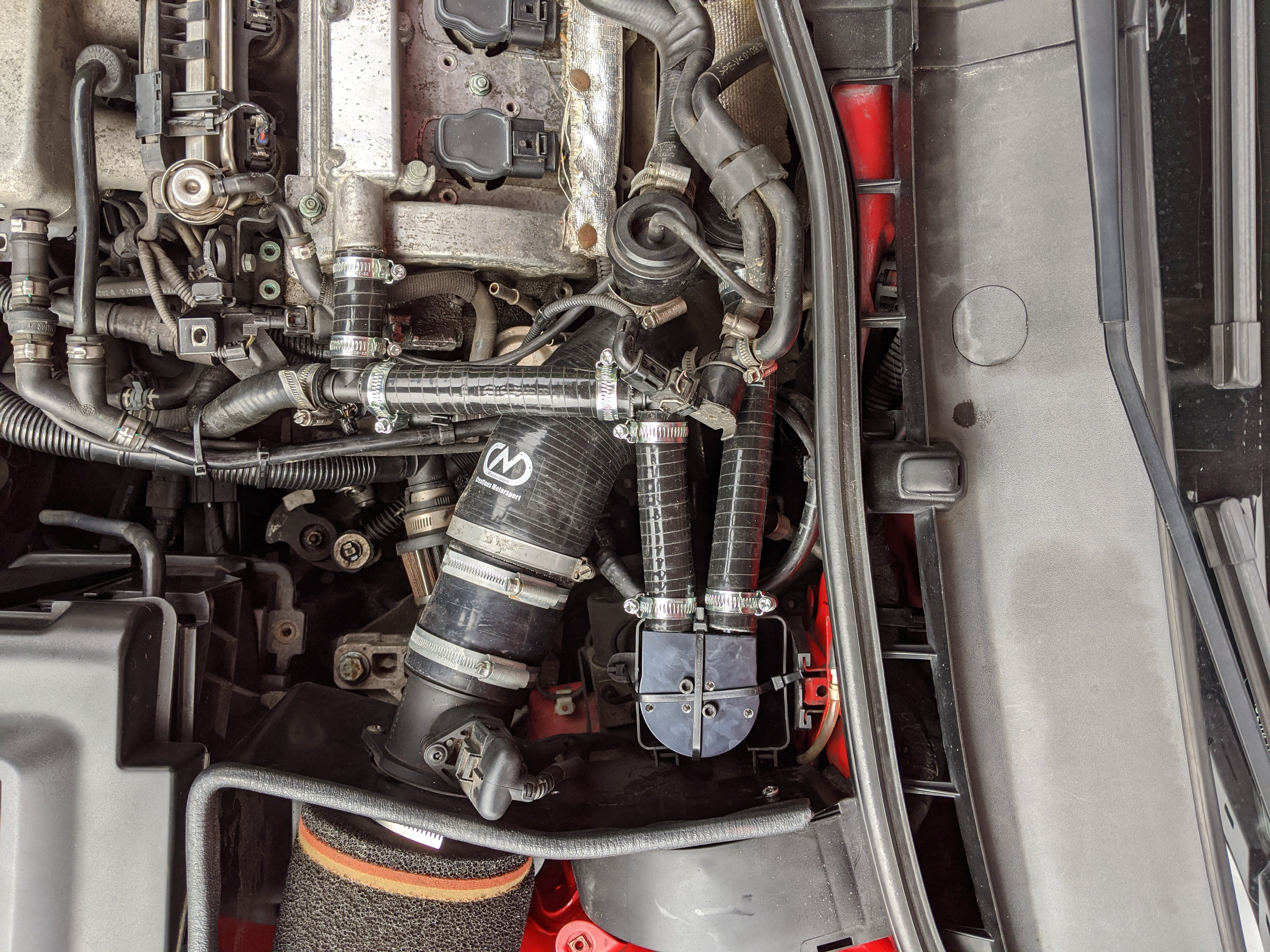

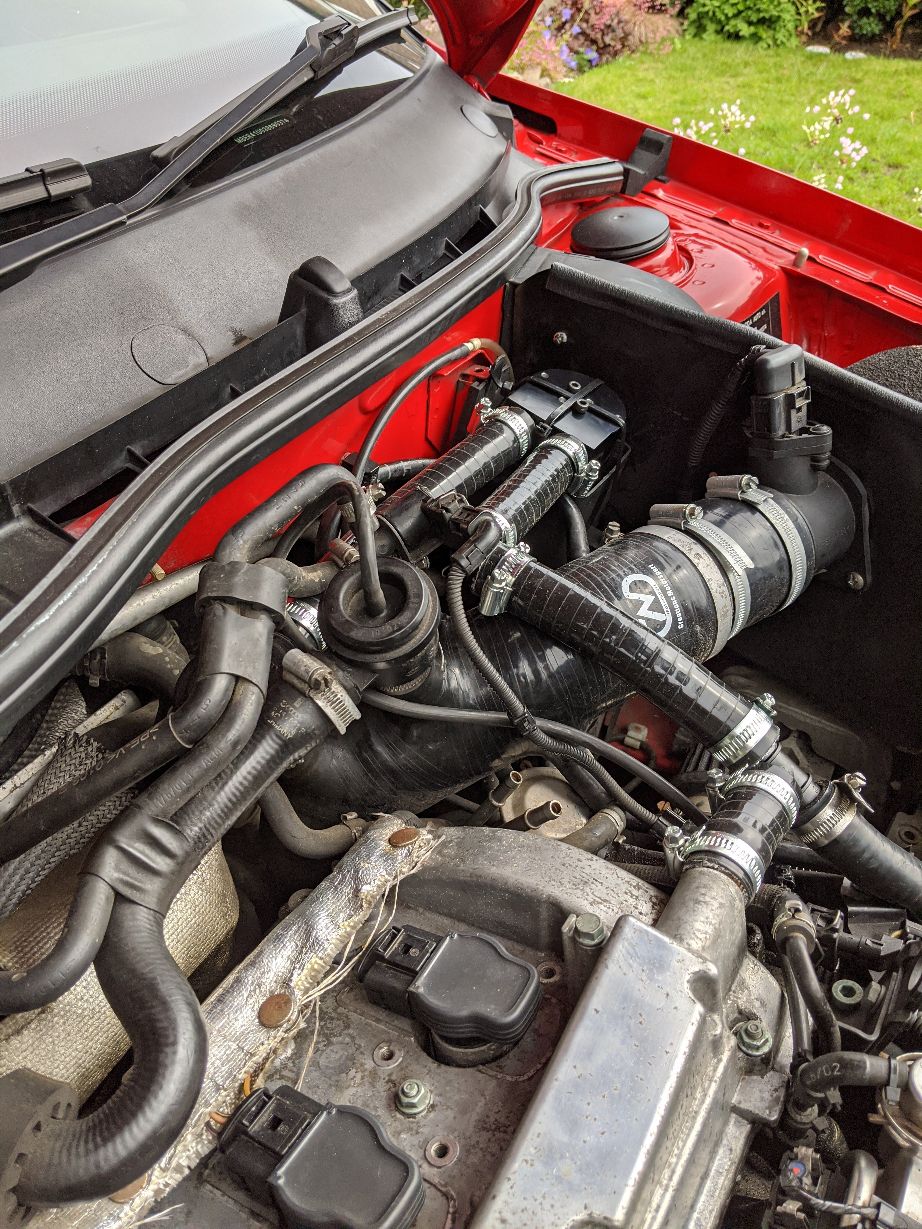

I've finally got round to fitting the catch can.
I got a shopping list of the things I needed from 'niceyellow vrs' which helped a lot, so that was much appreciated.👍

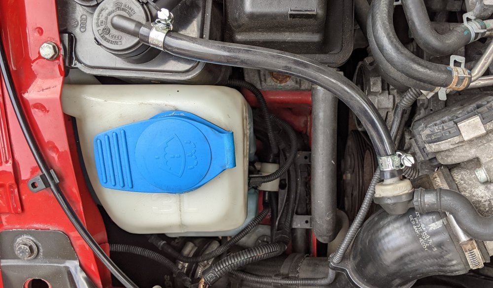

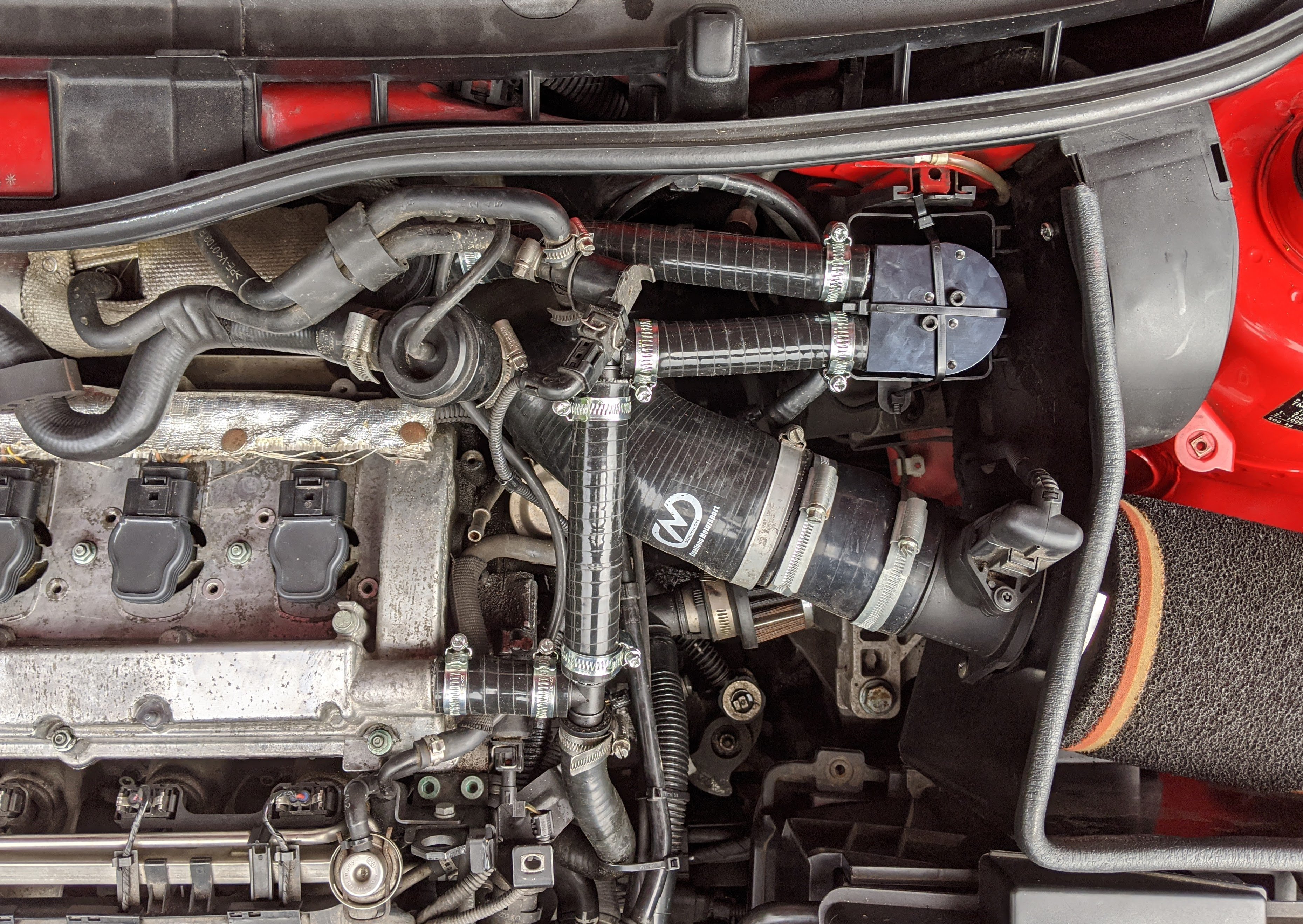

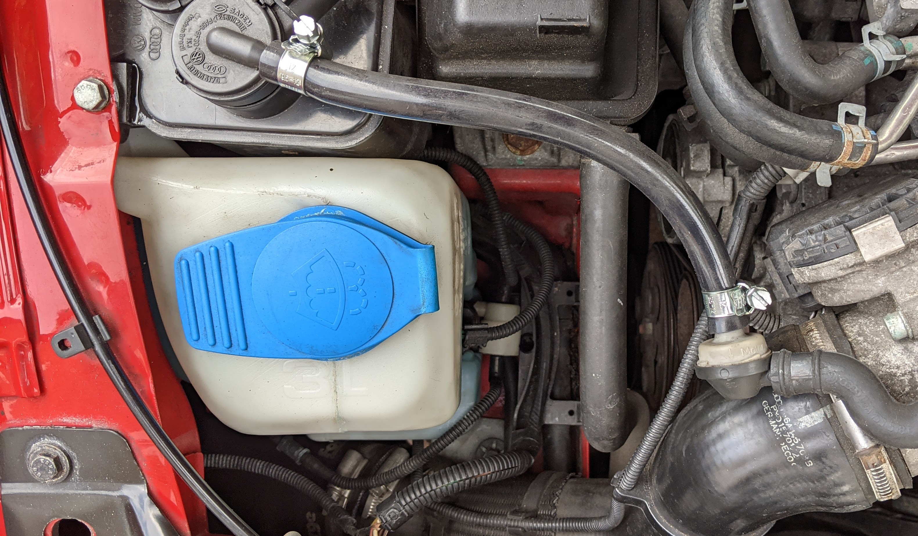

Having mulled over where to put the catch can, I settled on where the two relays sit at the rear of the engine bay.  I watched a YouTube video of a catch can install on a Mk1 Audi TT and they tucked the relays into the housing to the right of the relay unit and it seemed to work well.   Following this method, I did the same and both relays fitted nicely without too much of a struggle.
When faffing around mocking up different brackets to attach the can to the original bodywork & holes, I had the idea of using the original relay box.  The can fits nicely in there so I held it in place with a couple of cable ties just to see what it would look like. It turns out that if I placed the two bolts that came with the can in opposite diagonal holes, the cable ties don't slide off and the can is nice and secure.  For now, I'll leave things as they are as to remove the can all I have to do is undo the two hoses and the whole unit unclips off the original bracket along with the plastic housing. To empty the can it's simply a case of sliding the cable ties over the bolts, take the can out and empty it.
I may redo this at some point but seeing as it's so secure and tucked away, it isn't too much hassle to loosen two jubilee clips to empty the can.
To allow the pipe to connect to the 'hockey puck' I rotated it 90 degrees anticlockwise.  Also, it took just under 60cm of hose to complete the job so if anyone is thinking of doing anything similar it gives you an idea of how much to order.
Anyway, I've put some photos below for folks to look at and to give their opinions on the install.

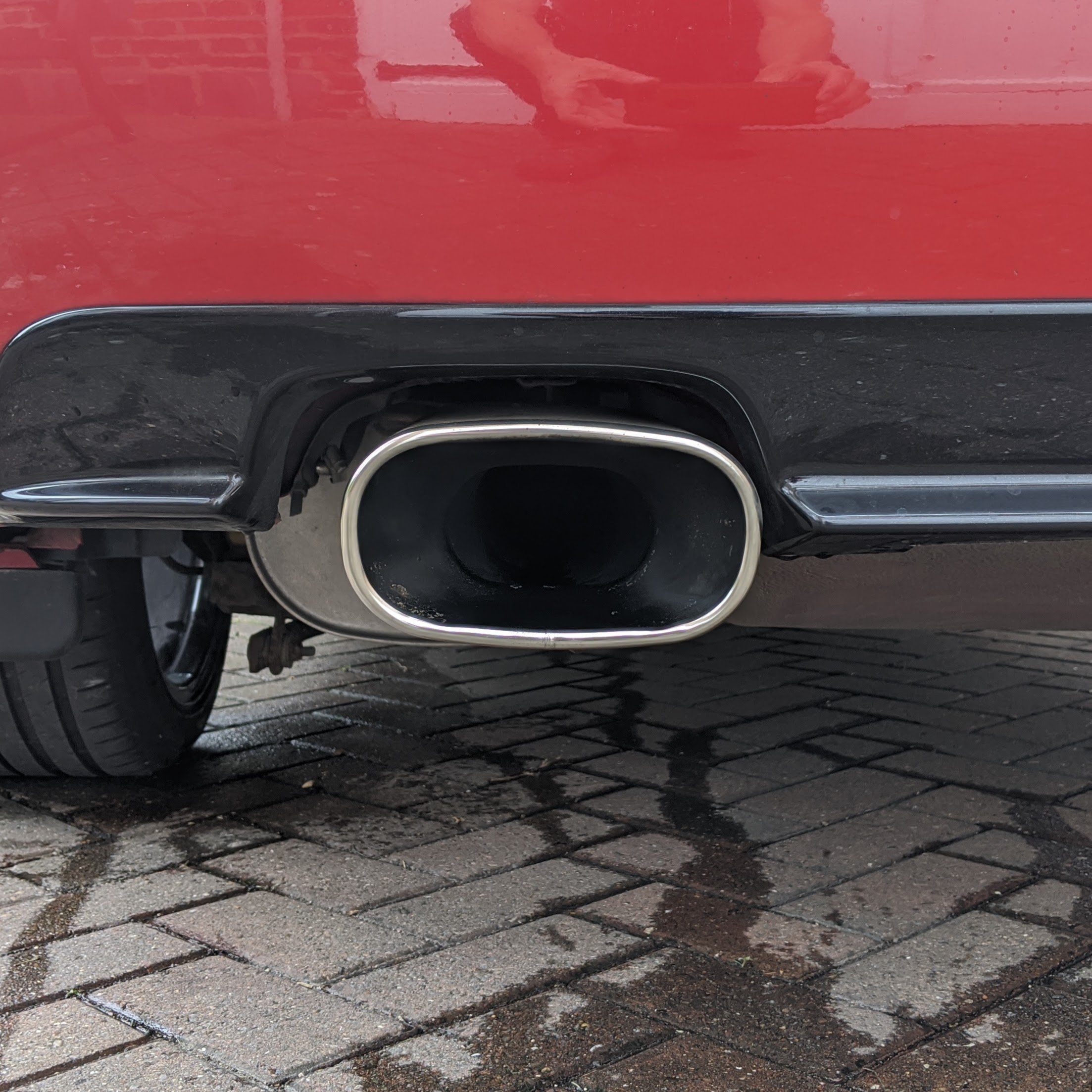

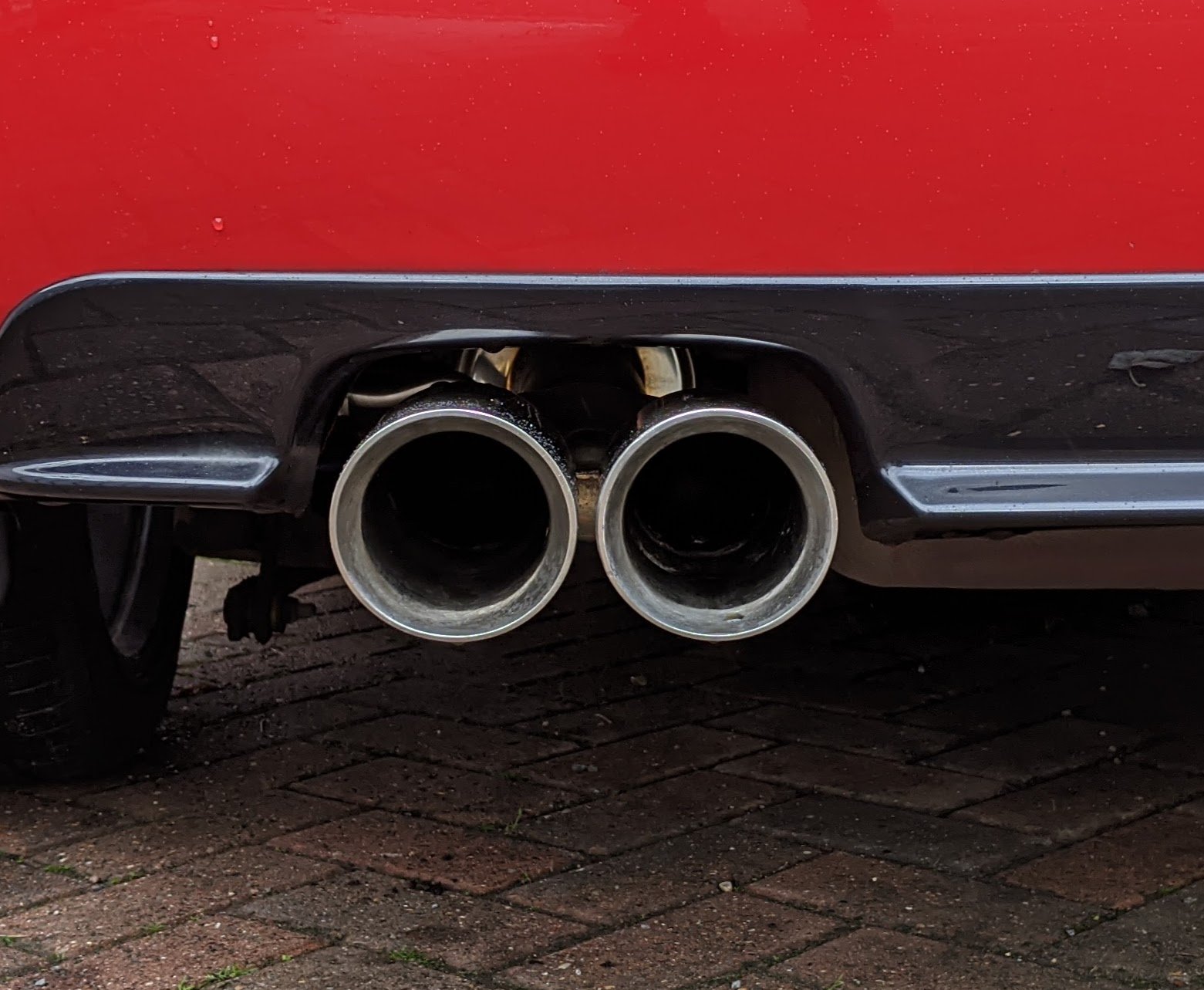

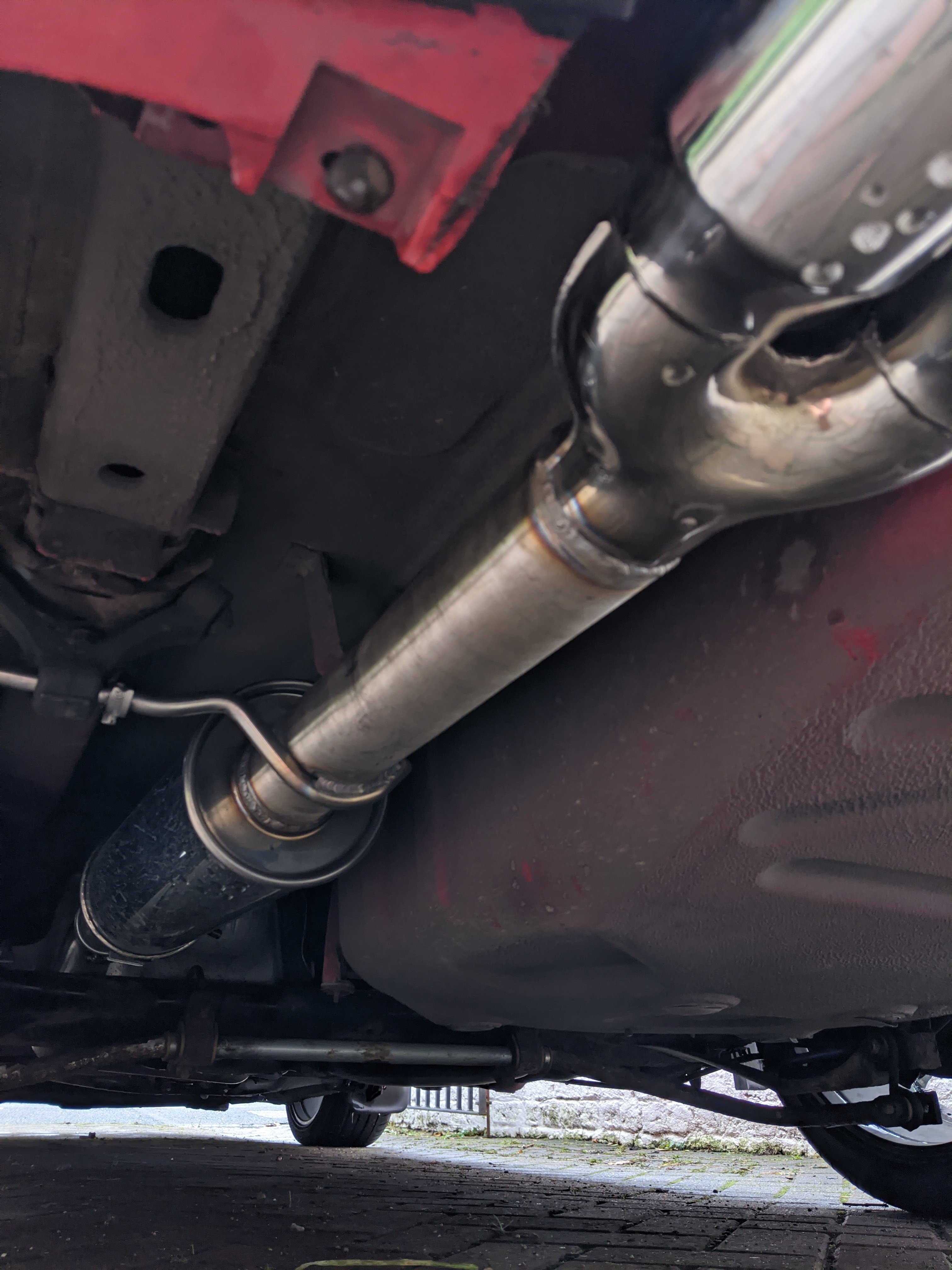

Thanks.  Since posting it's bedded in nicely now and the sound is spot on.  There's a decent burble, a few pops on the overrun, a great sound through the rev range and yet it's quiet enough for everyday use.

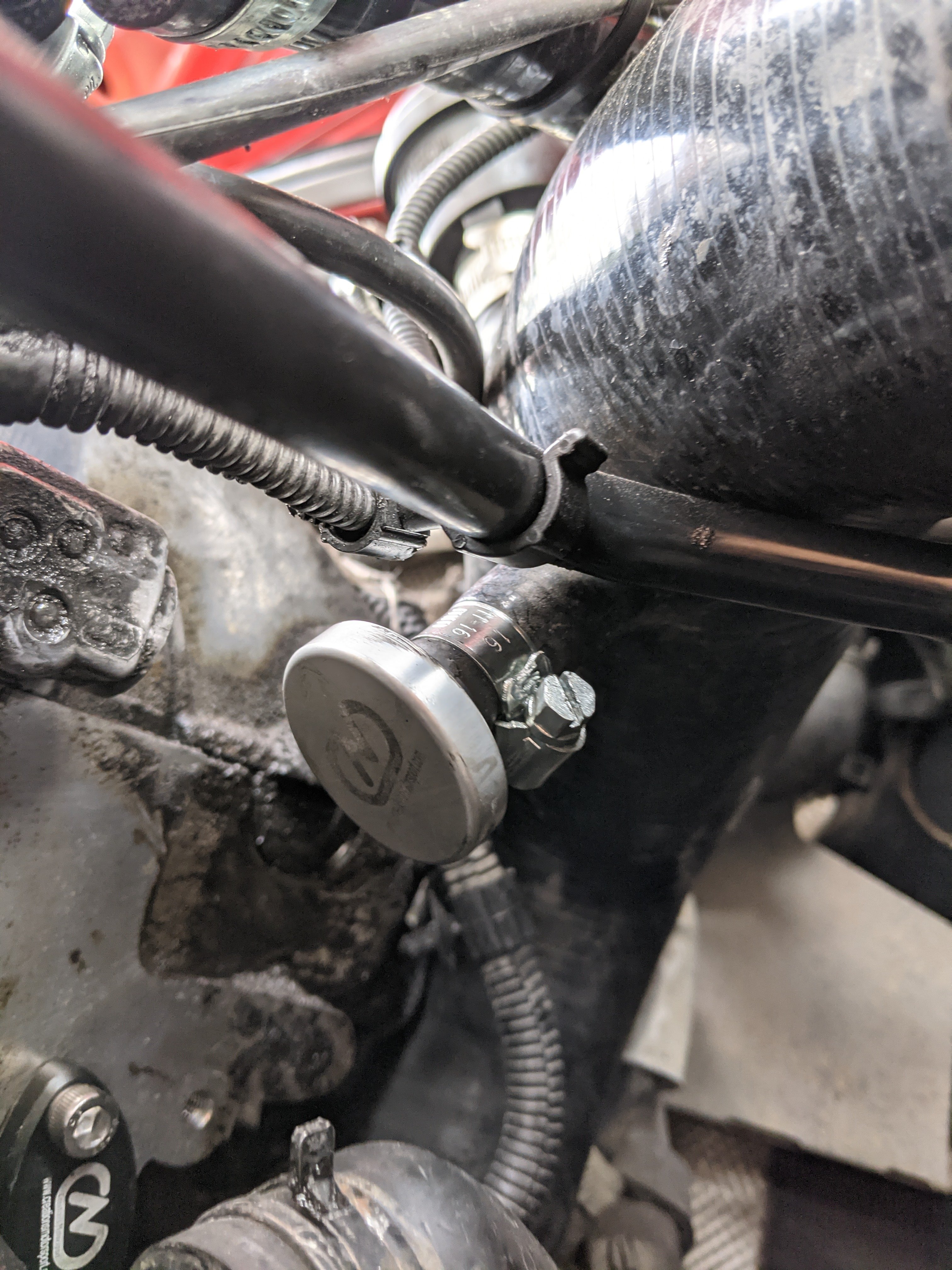

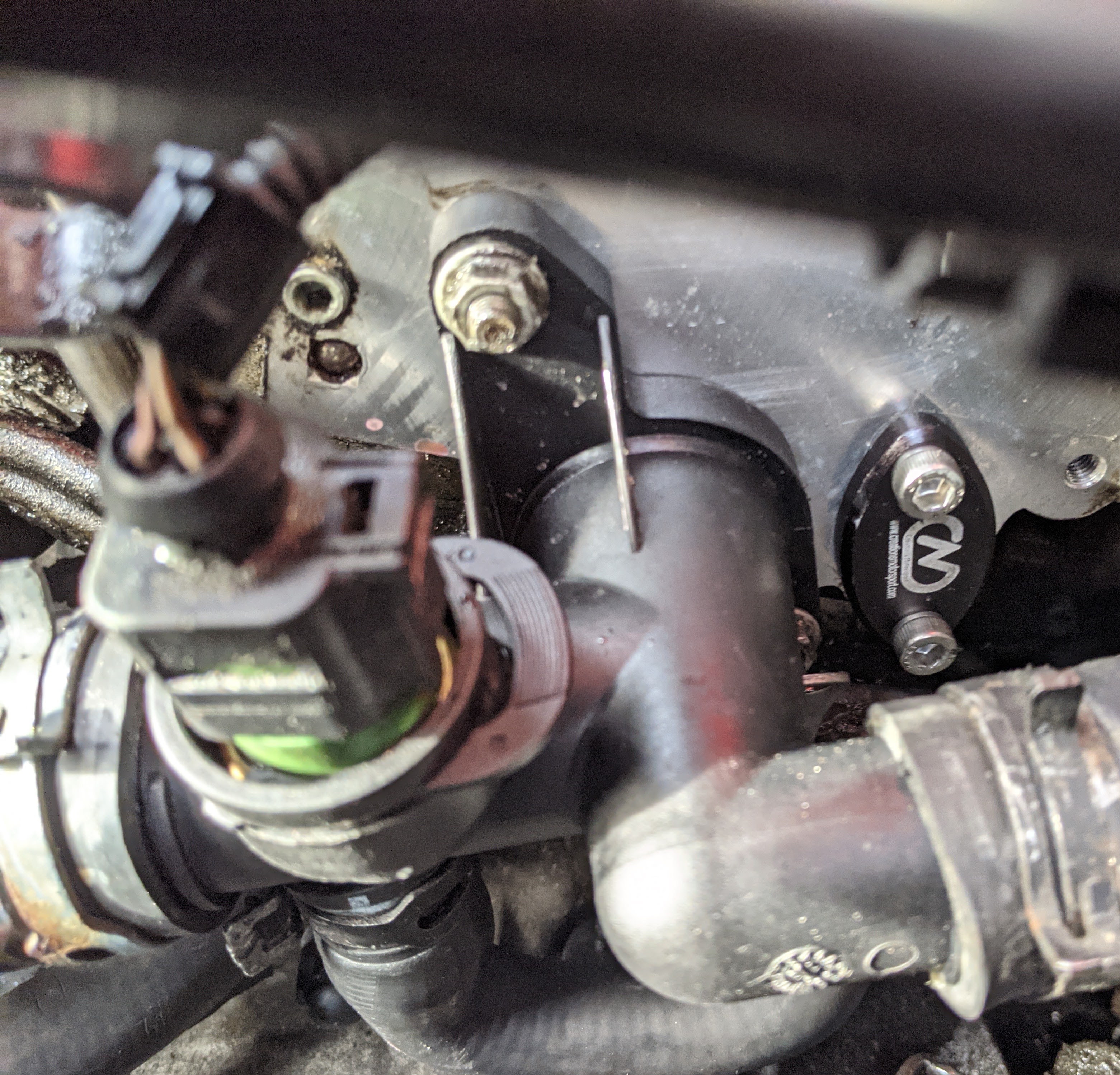

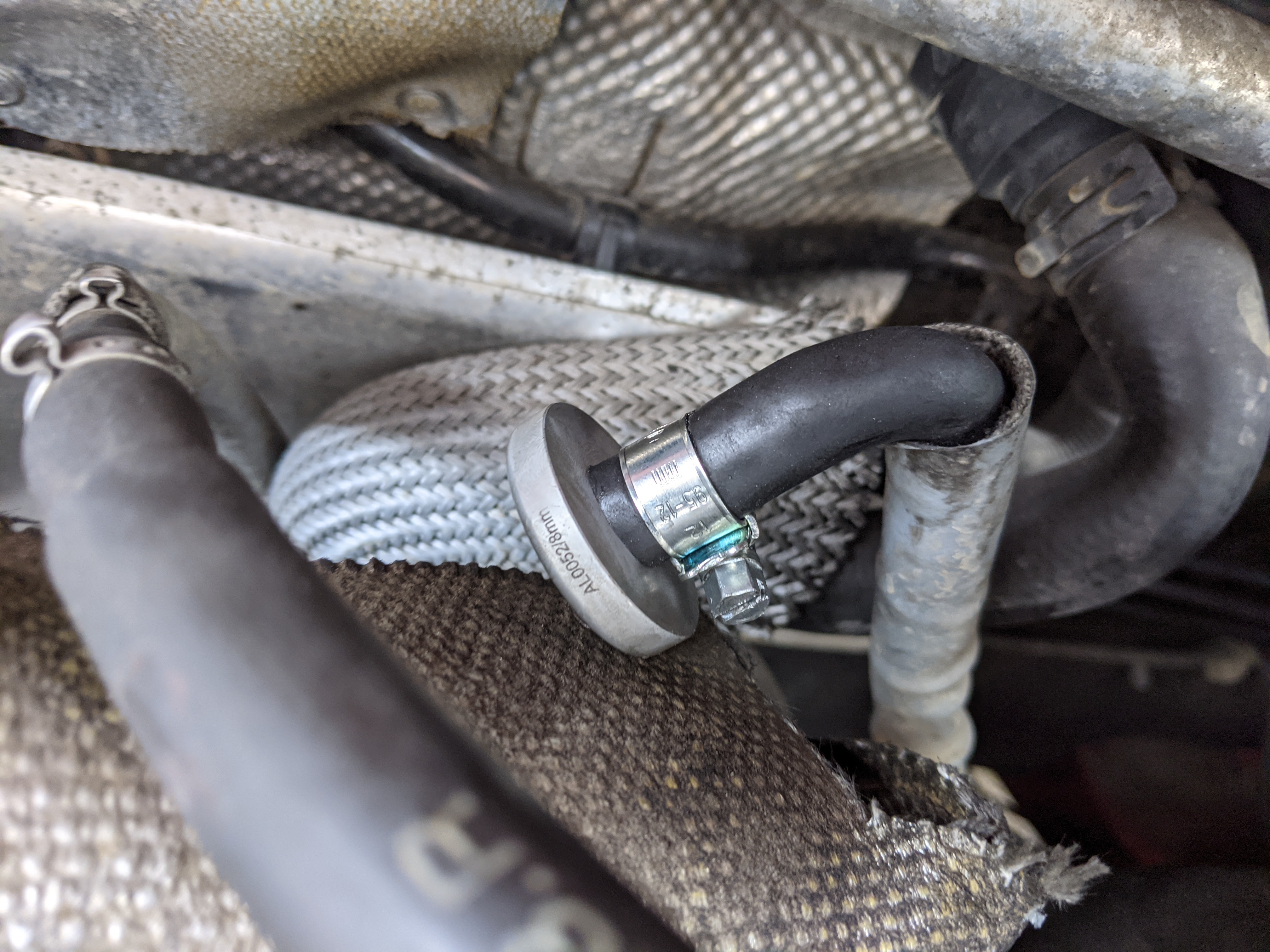

Today was spent deleting the SAI.
It went well for the most part but there were a few stumbling blocks.  I had to dismantle the pump to remove it as there wasn't enough room to wiggle it out in one piece.
The top bolt holding the bracket on was a pain to get to as was removing the SAI combi valve - I hadn't realised there was a second 10mm bolt holding it in place at the back along with the hard pipes.
Apart from that and losing about 2l of coolant it was reasonably straightforward.  I ran out of daylight to take some final pics but did get one of the parts I removed.
Edited by skinnyman
Here's a photo of the Creations Motorsport blanking plate, it wasn't as much as the Forge version but seems to be good quality.
Don't do what I did though and drop the tiny o ring when trying to fit the plate.  There was much swearing at that point but eventually I found the ring and fitted it correctly.
Also, I had to pop to VW this morning for a temp sensor o ring.  The one that came off yesterday must have been squashed out of shape over the last 18 years so didn't seal correctly.  Coolant was weeping out from around the sensor when the car was up to temperature.  A new o ring and clip seem to have sorted it out.

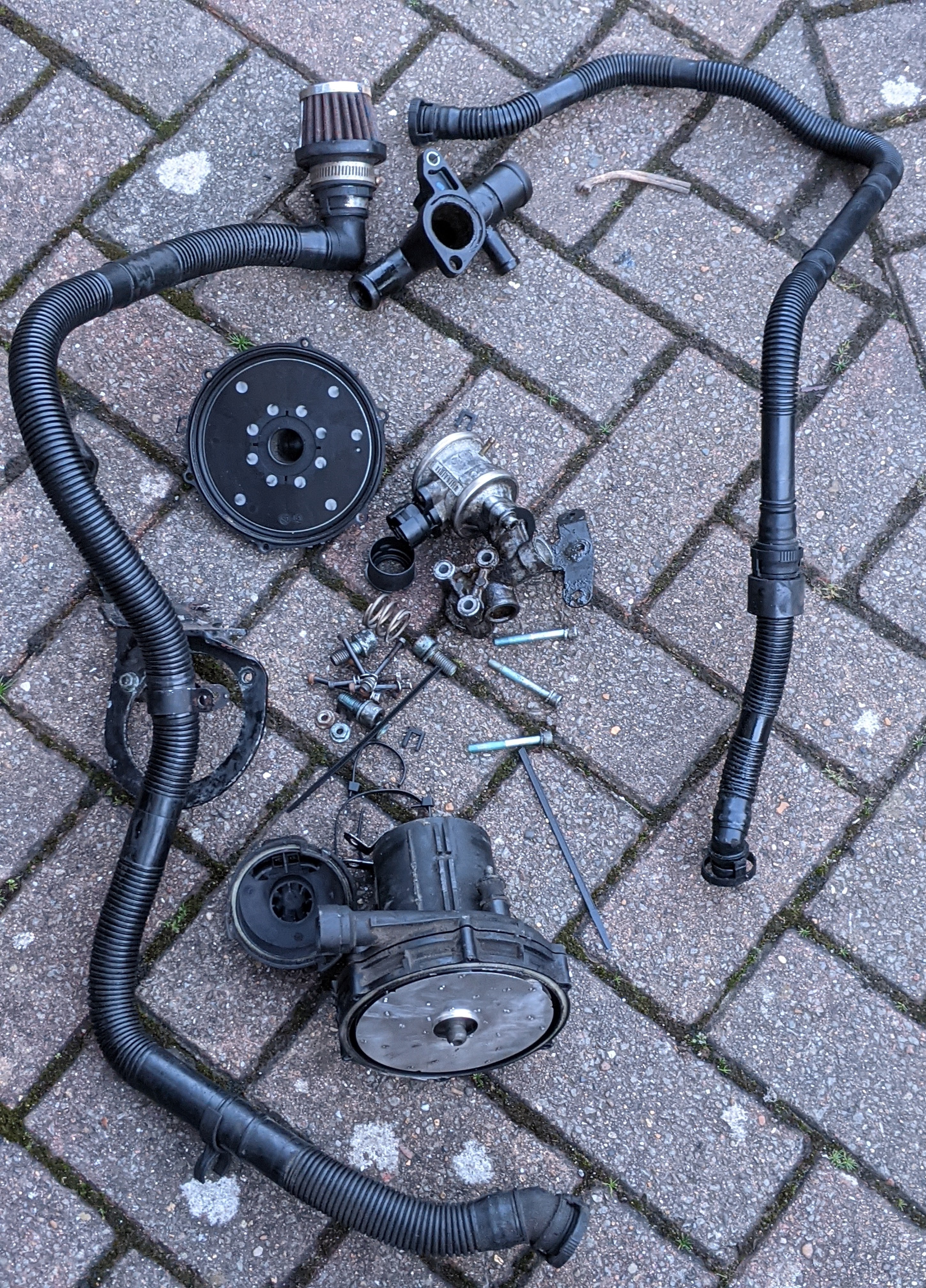

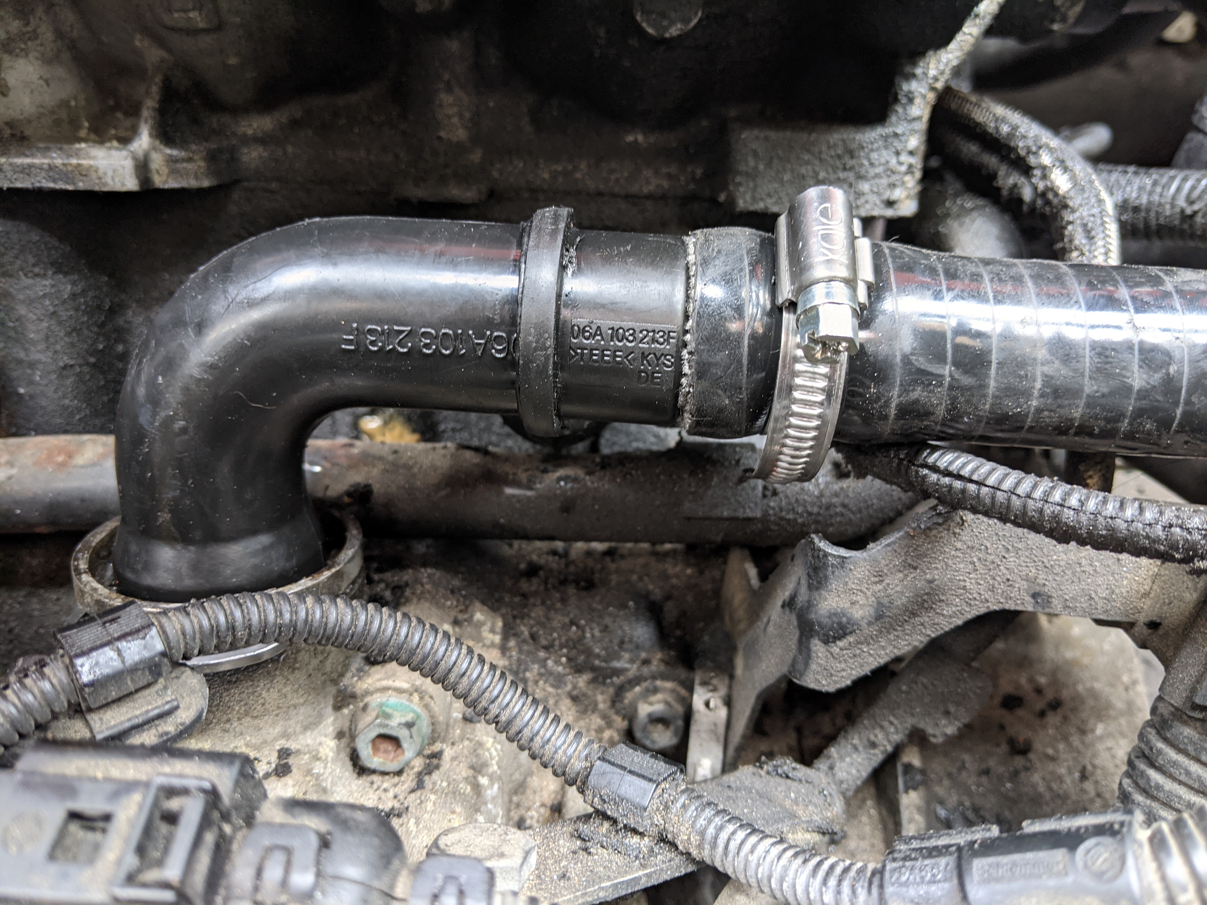

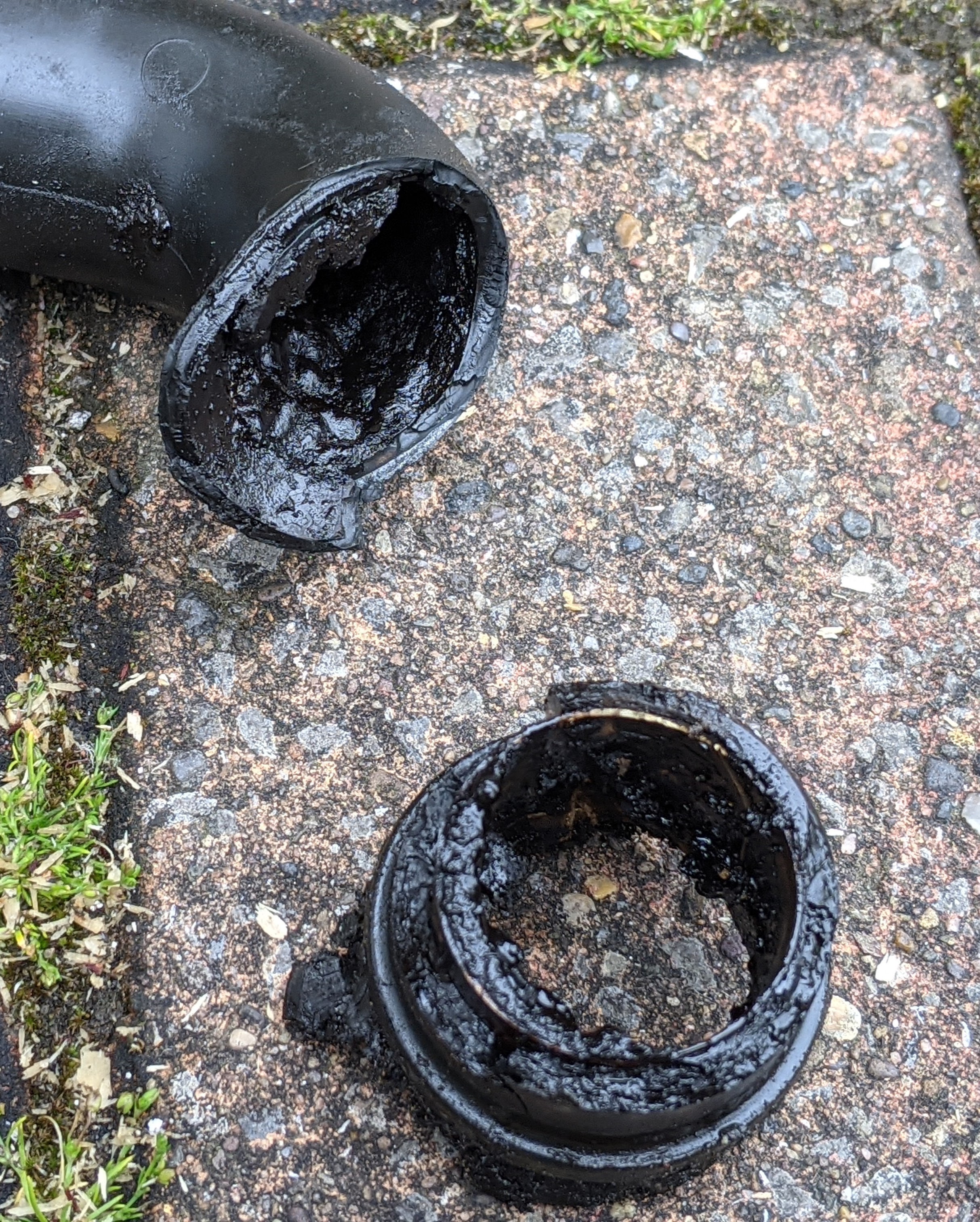

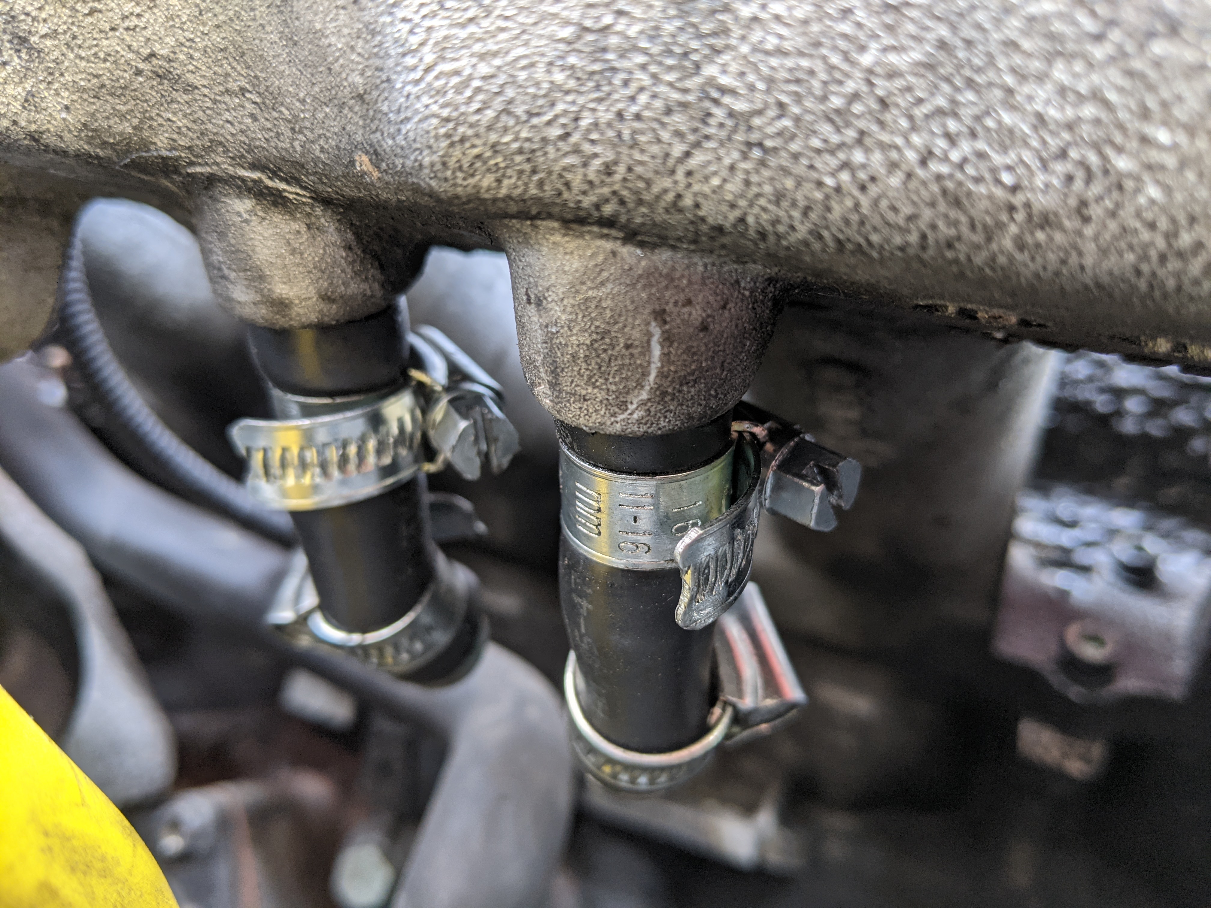

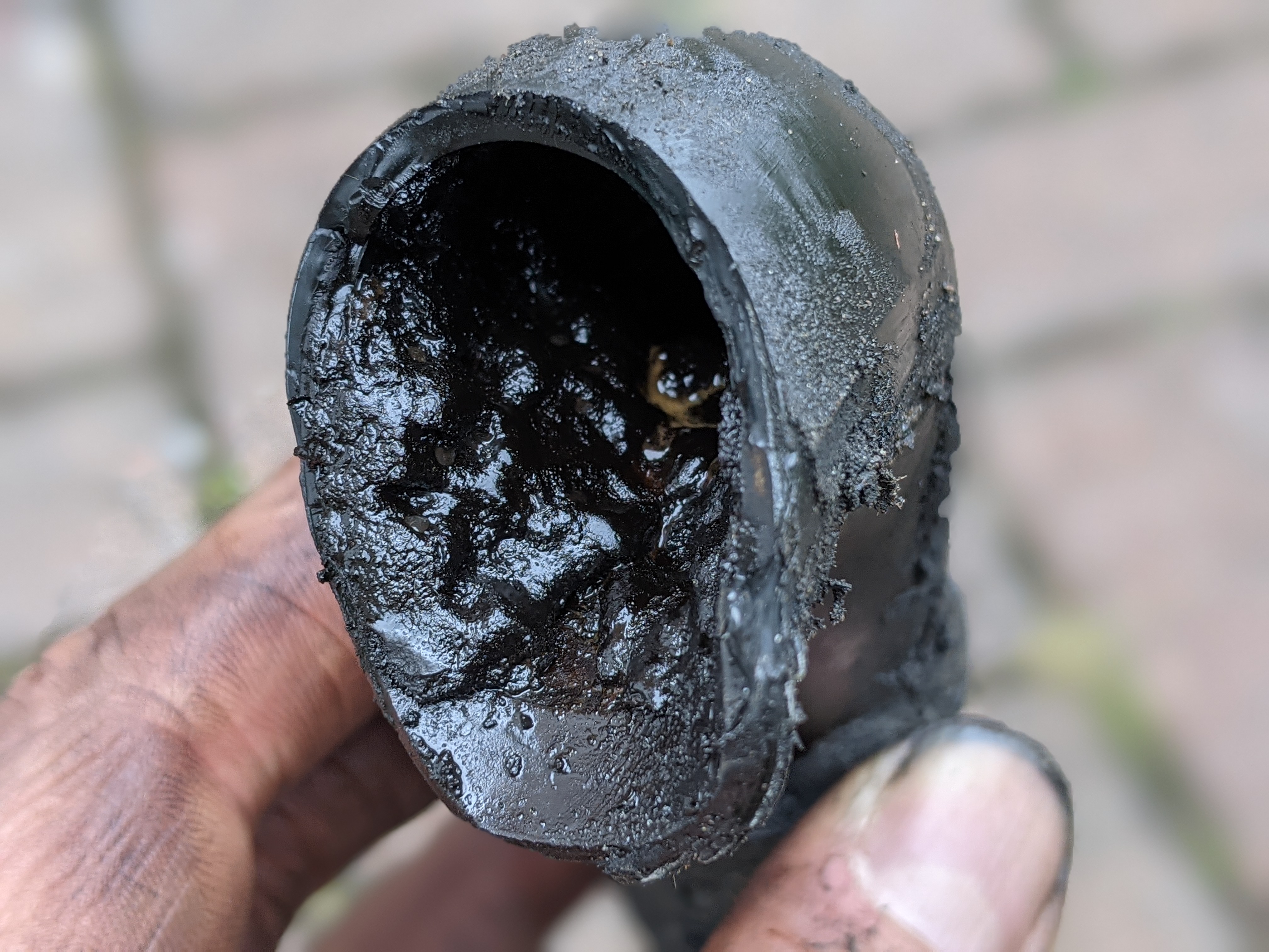

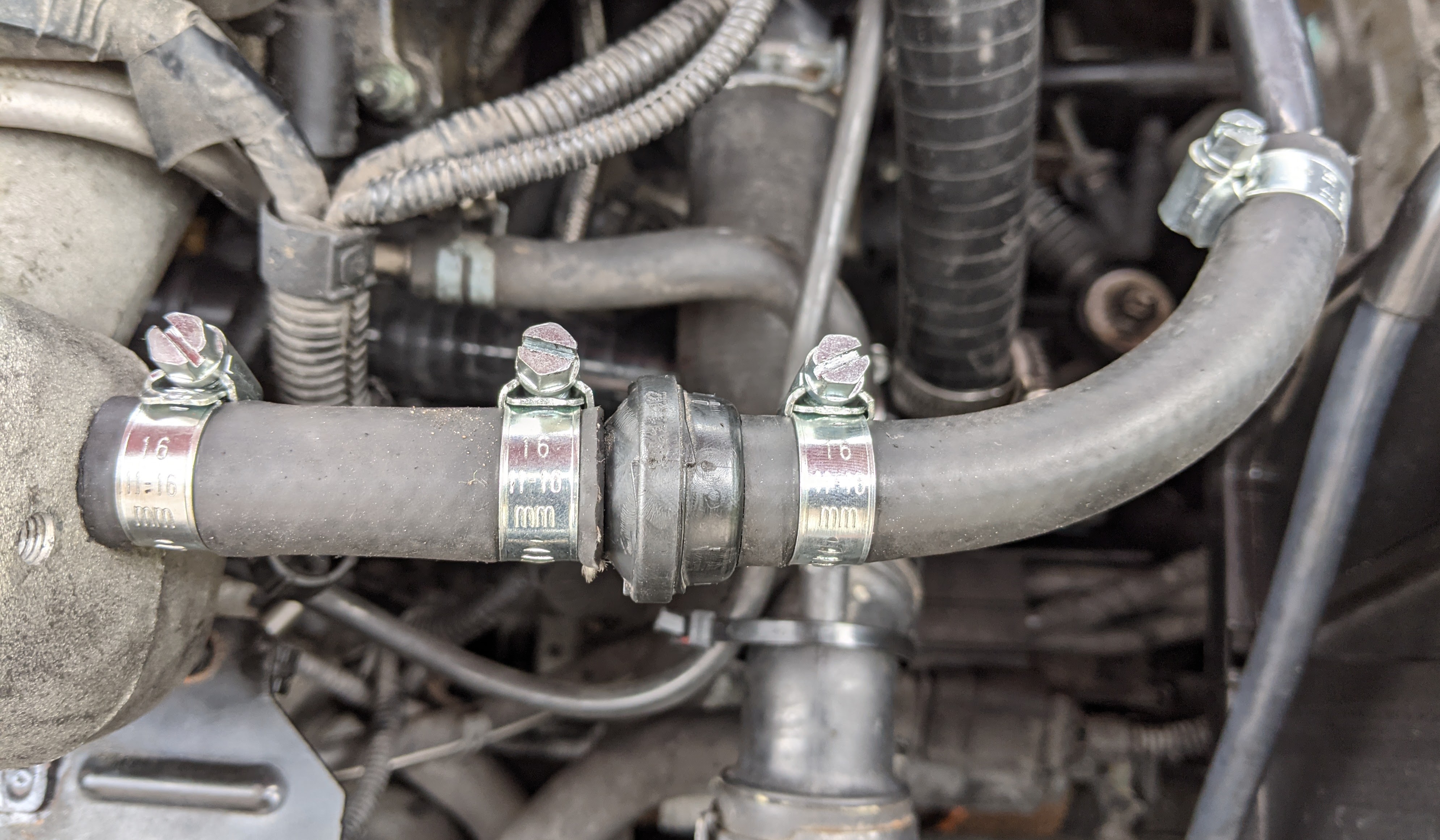

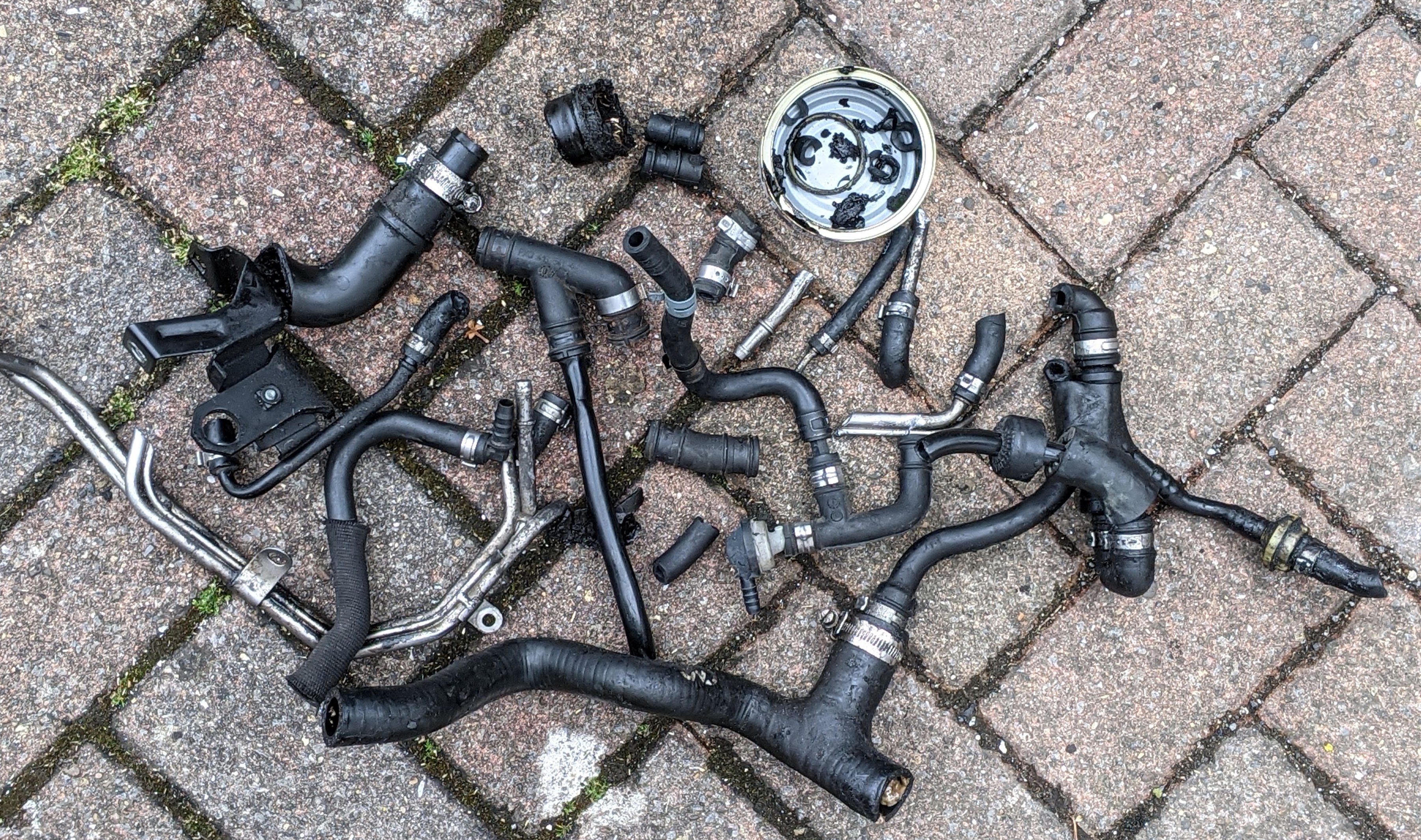

I finally got round to doing the breather system simplification.  I followed Bowders’ guide after reading it many times, studying the engine itself and buying in all the relevant bits.

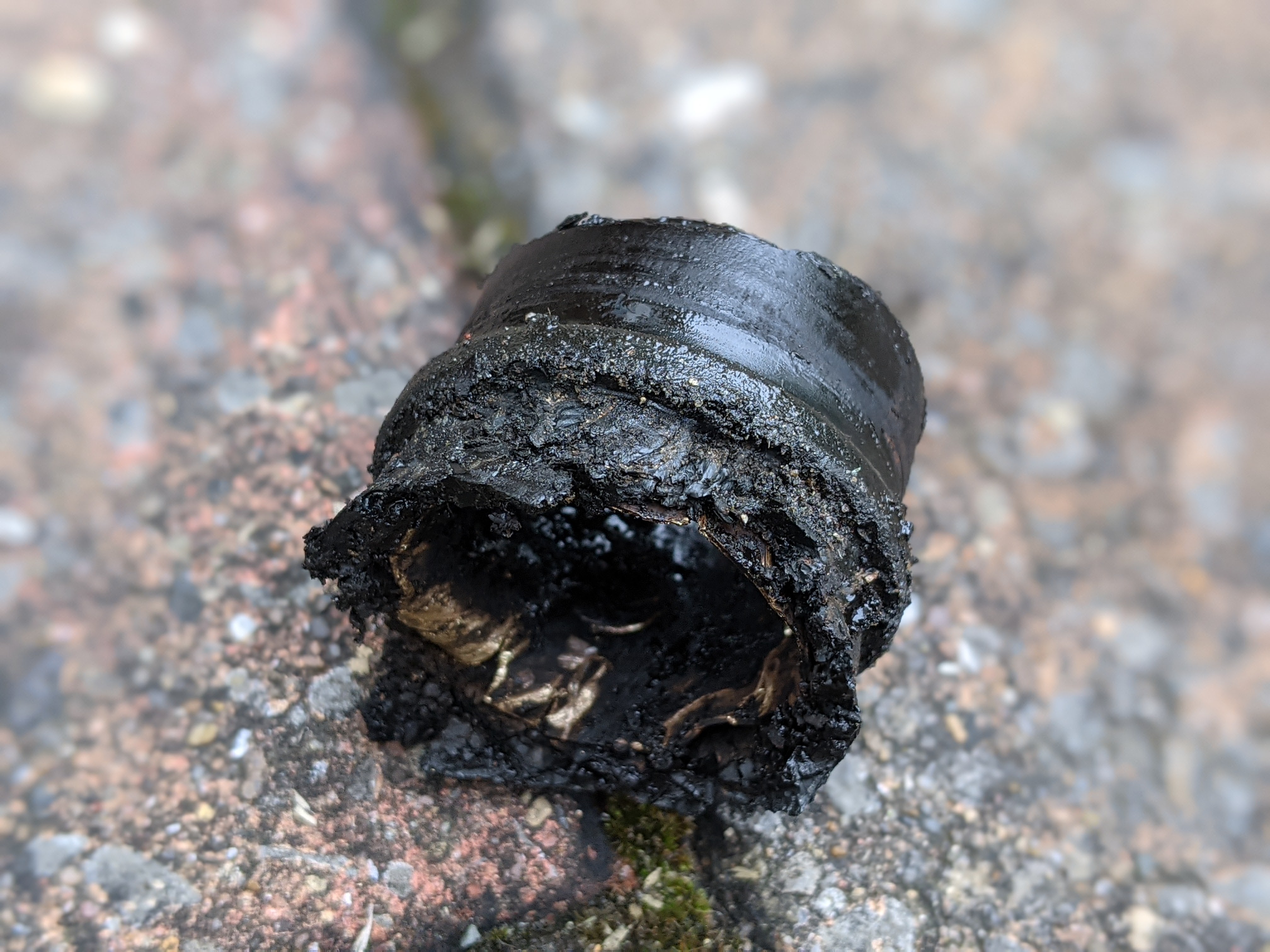

It went reasonably well but there were a few hiccups along the way.  The first was that the 90 degree pipe snapped off at the base, leaving me very little to get hold of to remove it.  I guess after 18 years it had become brittle so it was a good job I had thought ahead and bought a replacement.  I think I got all the pieces and was amazed by how much gunk there was in the pipe.  Things should flow a bit better now just for replacing the pipe for a new one.
The rest of the removal was fine and I simply butchered things to get them out if they were catching on anything.  The next issue I had was removing the hard lines that ran down the coolant sensor side of the engine.  These didn’t need to come out but seeing as they are redundant it seemed to make sense to remove them.  I had already unbolted them when I did the SAI delete and replaced the coolant sensor housing a few months back.  However, they are an awkward shape and wouldn’t come out.  In the end I cut them up using a junior hacksaw and eventually they were freed by pulling them towards the bulkhead.
The two outlets on the inlet manifold were blanked off using some flexible tubing I took off the hardlines.  I inserted a bolt in each one, sealed it with a bit of black silicone sealant to make sure they were airtight and then clamped them in place.  Having looked at the photos I can see one of the clamps is wonky so I'll go back & sort that tomorrow.
As you can see further down, a lot of tubing & pipework came out.  Some of it was split so I’m glad it’s done.  That’s probably the last modification/simplification I’ll do to the engine as everything else has been done.  The N247, N112, SAI, breather system & catch can are all sorted. Amazingly, the engine still works and there aren’t any fault codes at the moment.

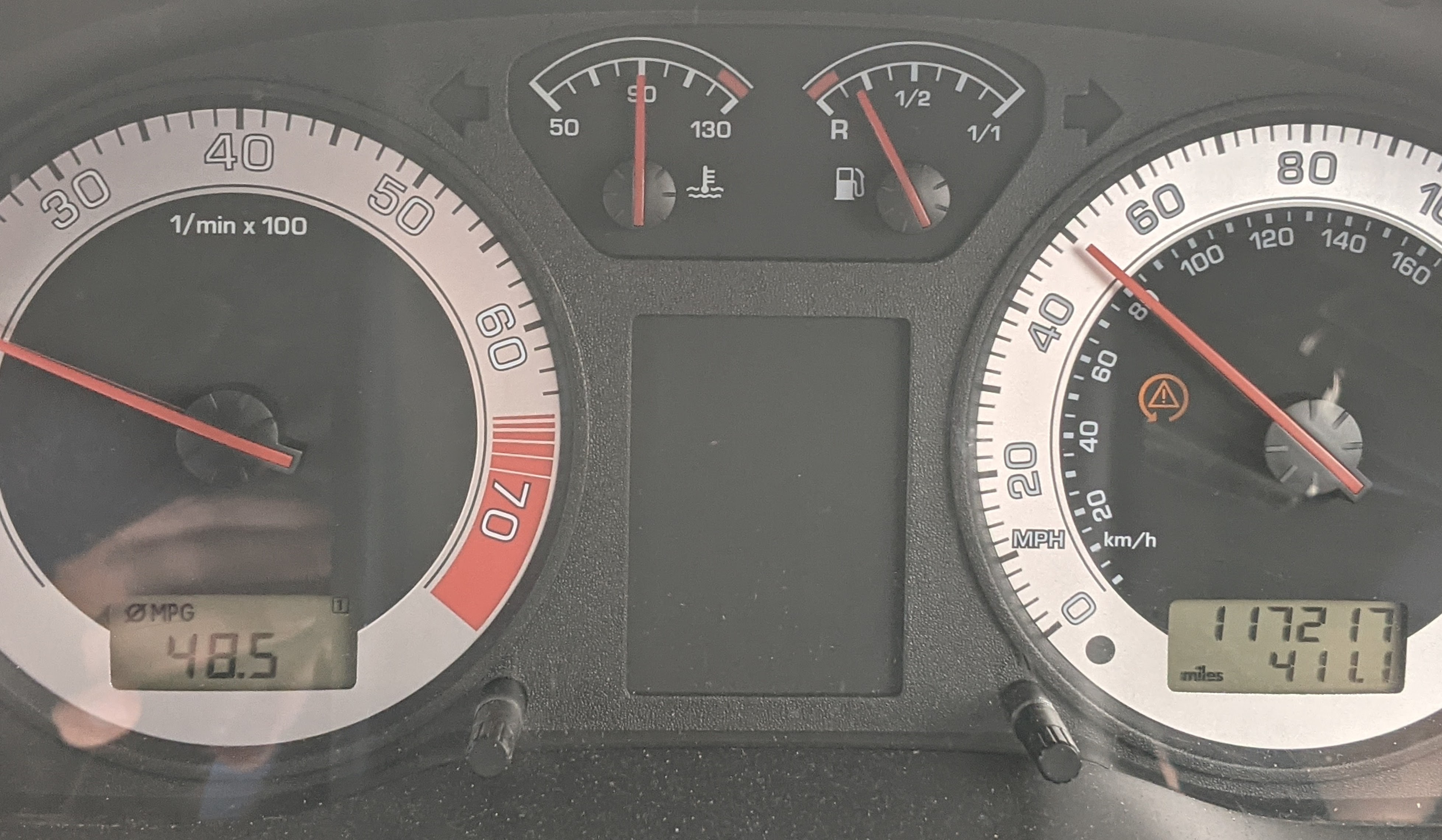

It had a good run over the weekend with a trip up to Knockhill for the BTCC - a round trip of around 460 miles from here in Scarborough.  The car performed really well and the combination of everything that had been done meant it cruised up and back with no issues at all.  The cruise control really came into its own and is well worth it for longer journeys.
I nearly made it there and back on one tank of fuel but admitted defeat as we got into Whitby.  The trip computer said we had another 30 miles in the tank but I didn’t want to risk dredging up any crud from the tank, so we filled up with V Power.  I managed to get 411 miles out of the tank which I was very pleased with.  We sat in race traffic for two hours trying to get into Knockhill so the MPG would have been better had we not sat for so long.  At one point on the way back I had a theoretical 500 miles out of the tank but again, congestion brought that down a bit as there was a lot of traffic after Newcastle heading for the North Yorkshire coast..
The indicated 48.5 mpg was what the car was showing me on the way into Whitby on the way home on the journey from Edinburgh.  The journey into Knockhill showed an indicated 29 mpg so overall that worked out as an average of 41 mpg for the whole weekend.

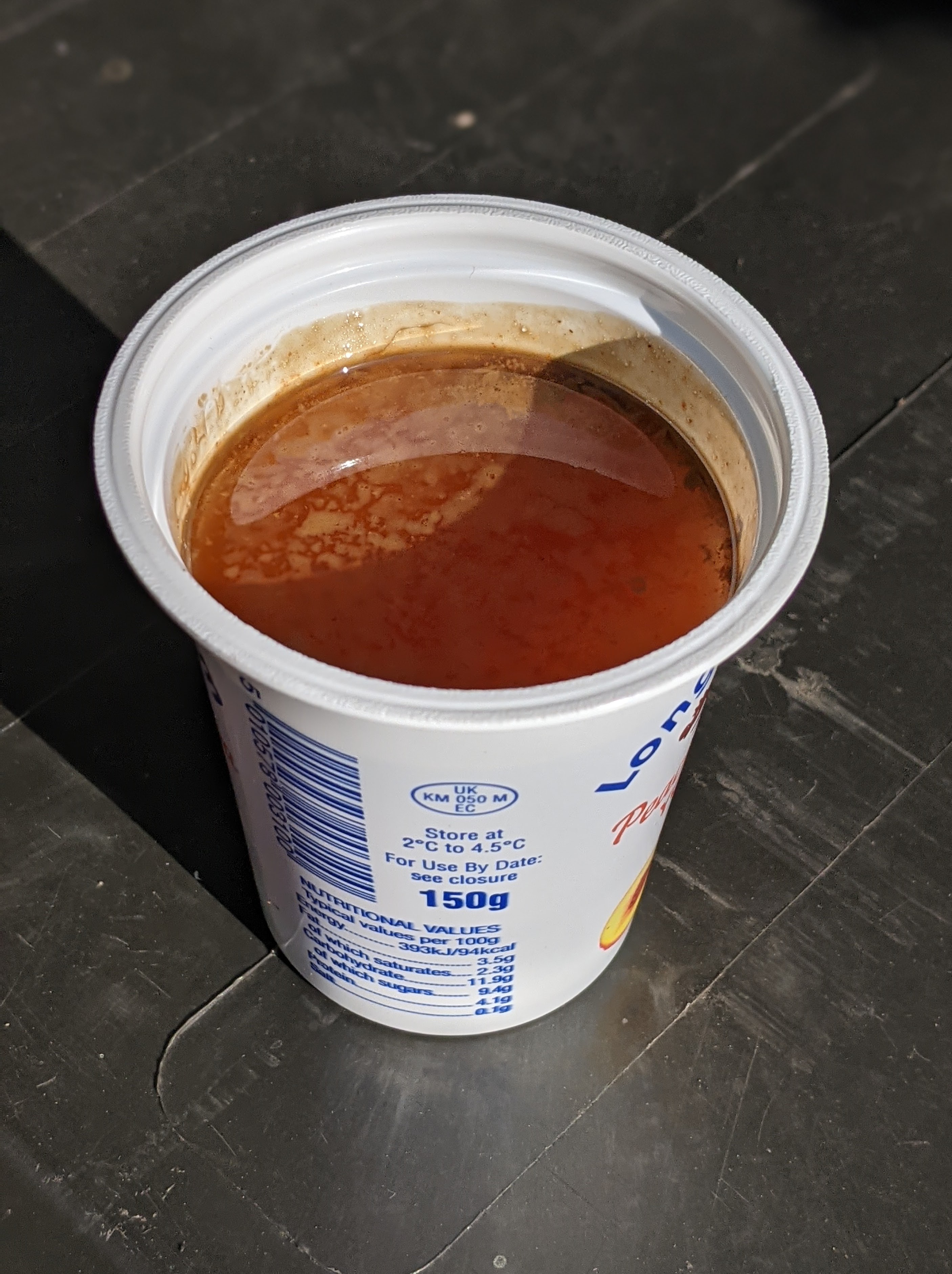

I emptied the catch can when we got back as it’s done about 1200 miles since the last time I checked and it was pretty full.  The orange colour in the liquid is coming from the wire wool in the can and it was less colourful in real life, not quite as Tango as it looks here.
