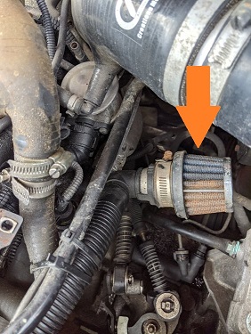

Sorry if this is a daft question.... what's this filter for?
Breather for the SAI pump.

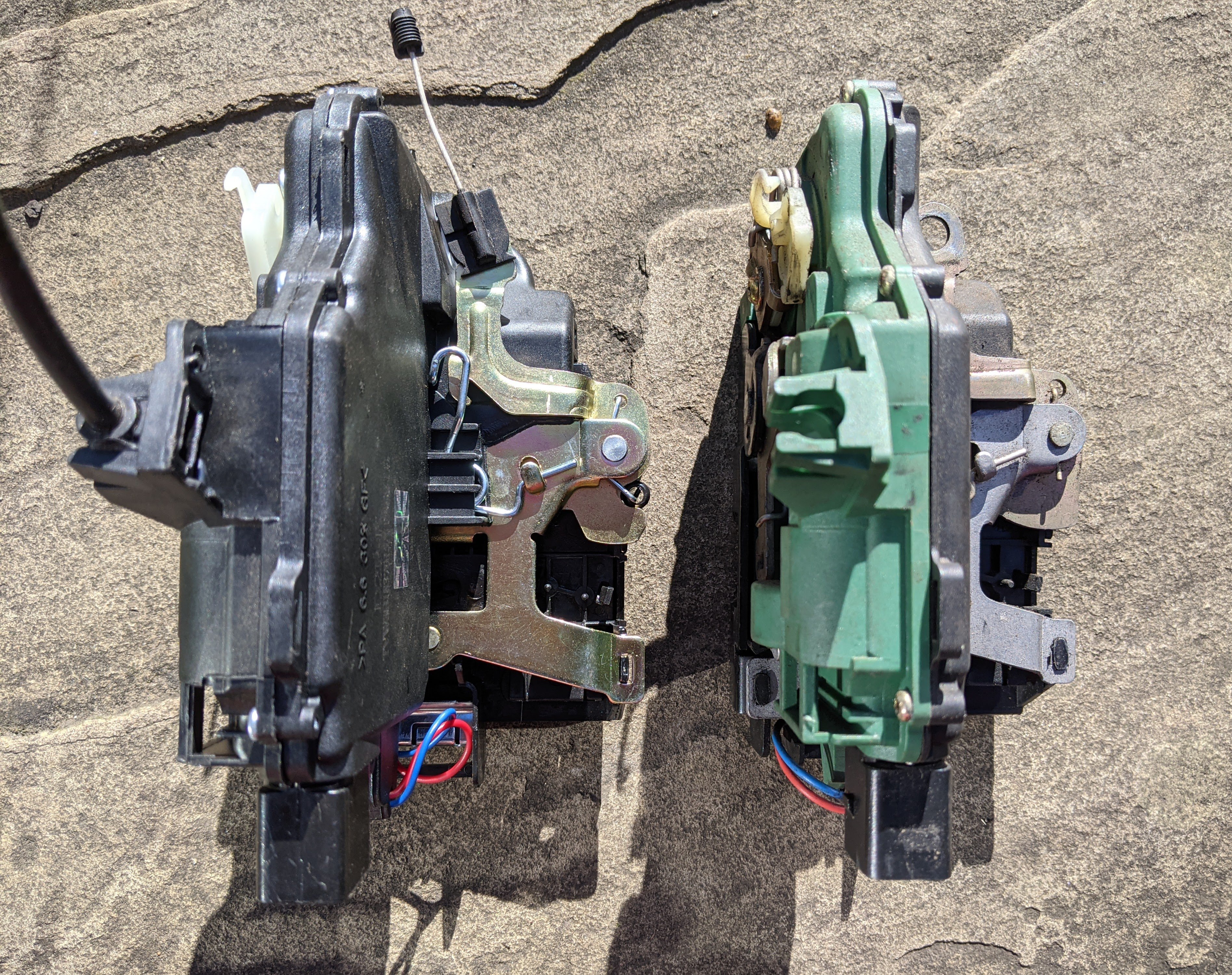

Some days the DIY doesn't go very well.  Some days it all goes better than planned.  Today was a good day in terms of maintenance for a small outlay.
My passenger door lock had been making some strange noises of late.  As some of you might be aware the car needs a new clutch and for various reasons beyond my control, it's been sat for over a month now.  I always say that cars don't like being idle and if they feel neglected they'll cause problems.  This week when checking that the car was okay the passenger door failed to open on the key fob.  Bugger.  I then tried to open it from the inside with no success and had visions of having to butcher the door card to get to the internals.
I remembered a guide that had a hi-tech solution so tried that first before cutting things up.
I hit the door on the handle and luckily it opened.

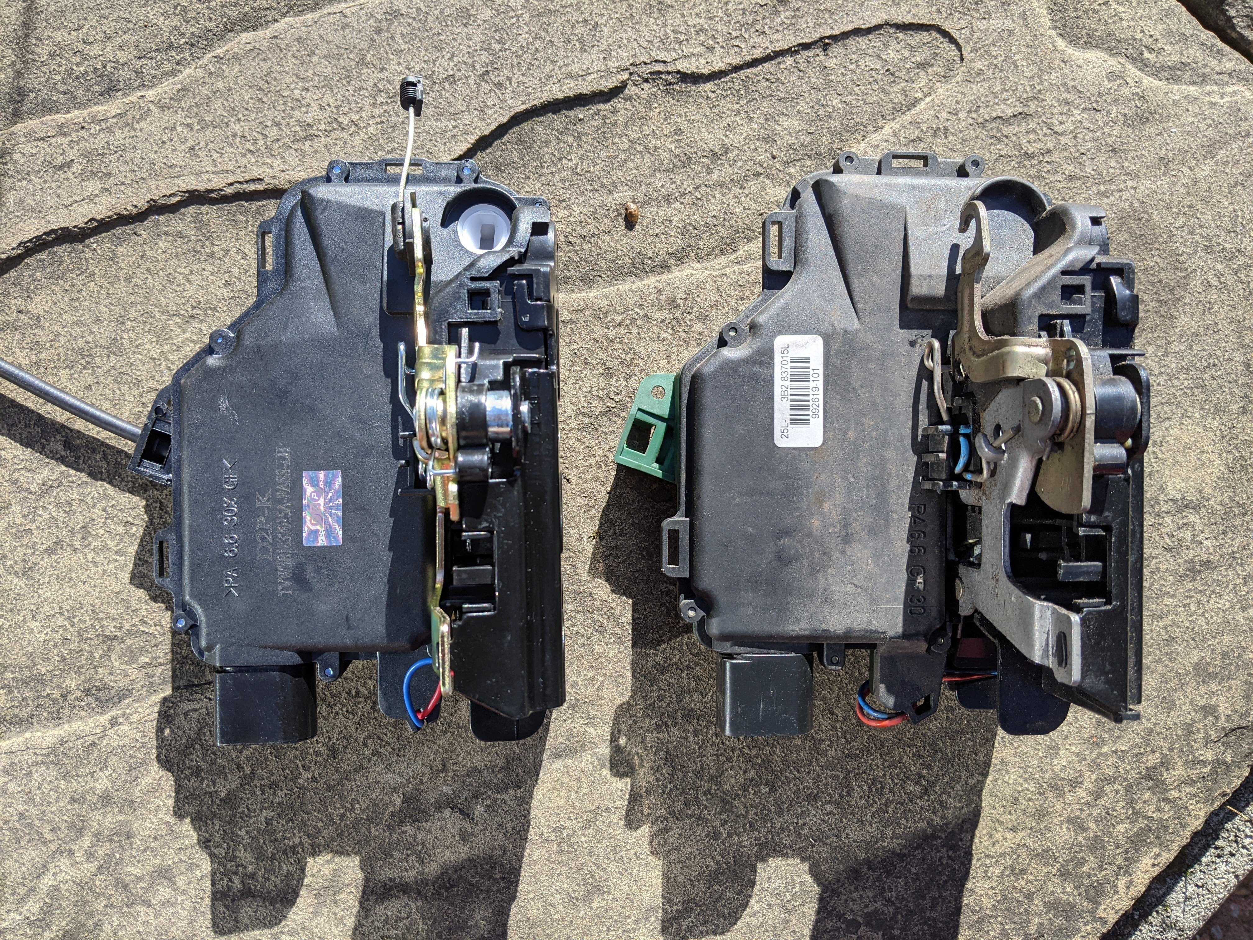

I left the car unlocked for the rest of the week and ordered an ebay special lock mechanism.
https://www.ebay.co.uk/ipp/151173095196?transactionId=2206303453005
I decided to fit the lock this morning and it didn't take too long.  It was fairly straightforward and when connected it worked a treat.  I have no idea how long it will last but there's a year's no quibble guarantee and at least the door works.
Here's a couple of photos with the necessary bits swapped over ready to fit into the door.

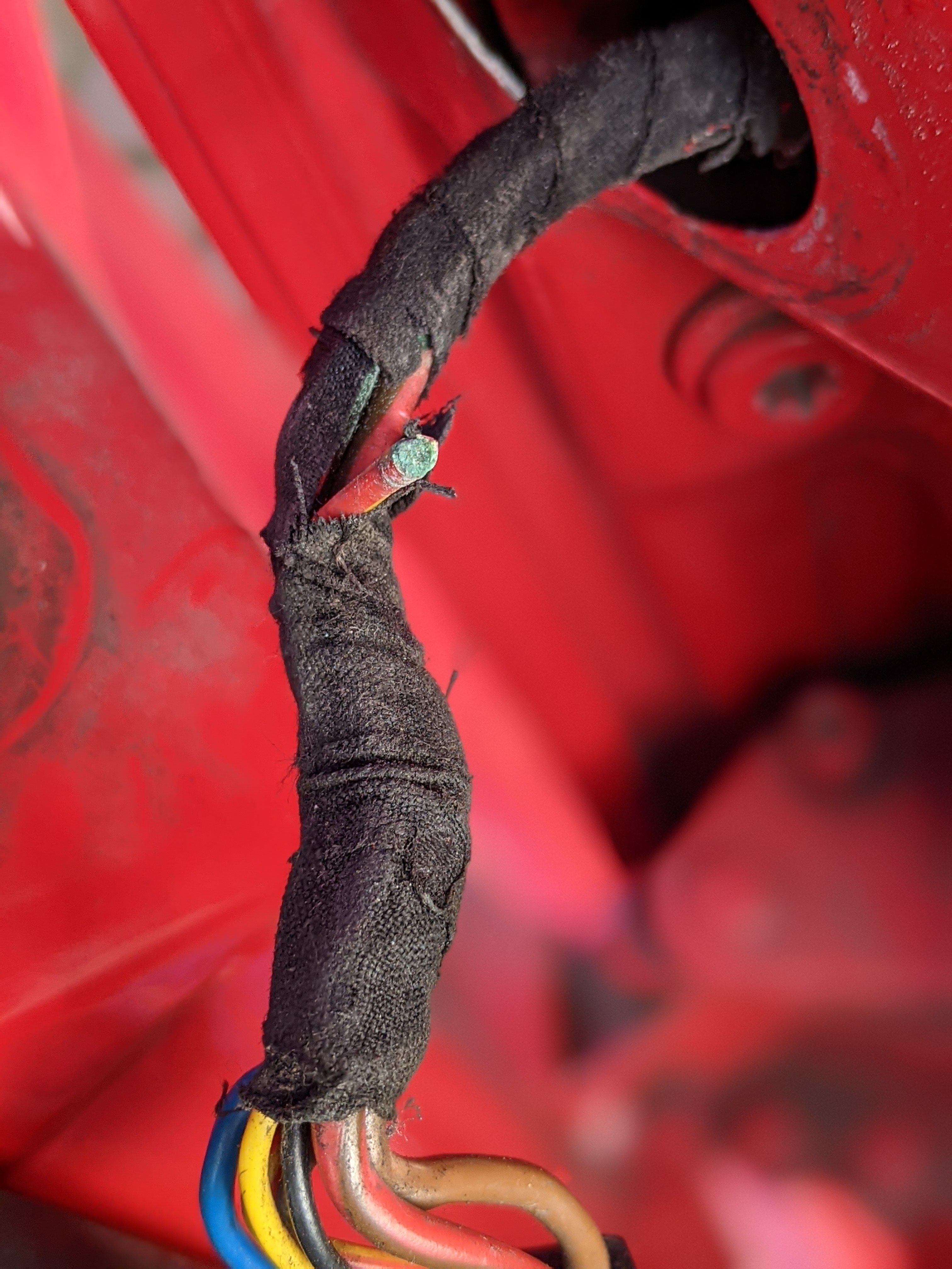

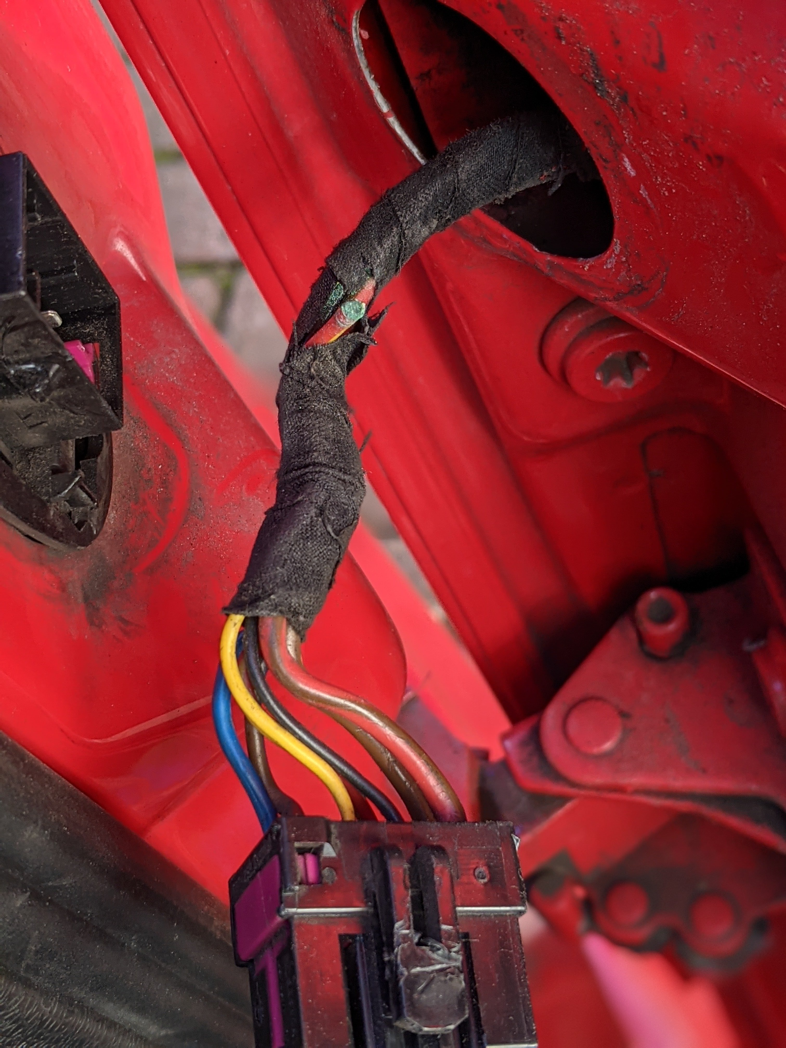

Because I then felt like mechanic of the year I decided to look into something that has been annoying me for some time.  The OSR door hasn't worked off the fob since getting the car.  I changed the lock mechanism last year and it didn't work.  I figured that there must be a break in the wiring somewhere and found this.
So, out came the soldering iron and a repair section of wiring.  It was heat shrinked (is that a word - shrinked?) wrapped up in the correct tape and reconnected.  I did a little happy dance on the drive when the door fired into life and celebrated with a coffee and biscuit.
I now have four doors that open off the fob and a warm feeling inside knowing that it was all solved for £25.00.

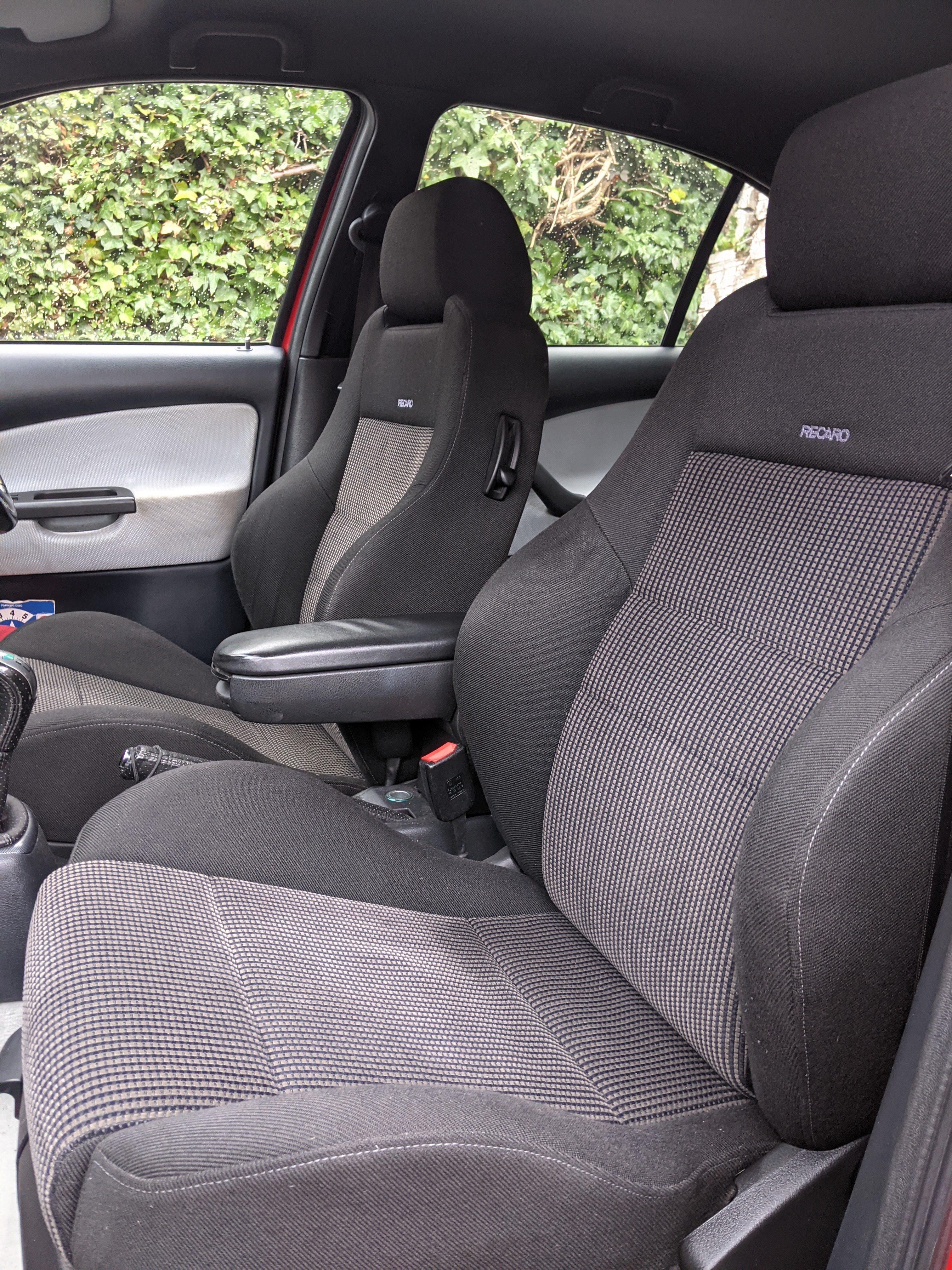

Well, I've gone & spent some more money on the car.

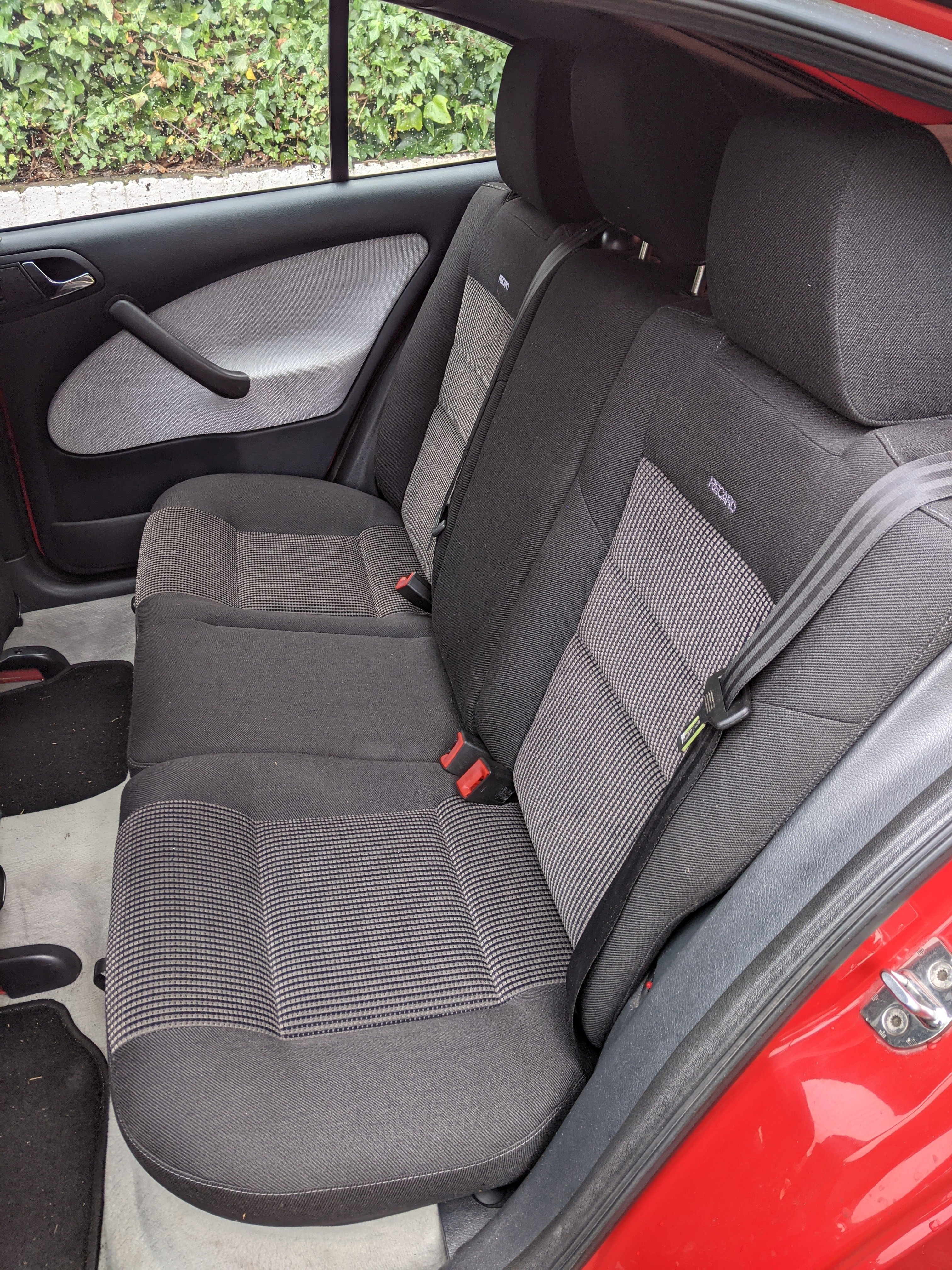

I've just put in a set of Recaros from a Mk4 Golf. They're from a three door but they fit fine & I'm not bothered about the catches on the side of the seats.
They were the best set I could find at the time & for 20 year old seats they are in good condition.  There's minimal wear to the bolsters and I'm looking forward to not having to worry about the white inserts any more.
I got them because the Skoda seats don't give me the support I need on longer journeys.  Hopefully these will be better for my back & I'll not have to hobble across car parks any more after a longer drive.
There's a small issue of a missing plastic part from the sliding mechanism but I've temporarily sorted it for now.
I'll see how I get on with them & will probably sell the originals in the near future.

I needed more lumbar support and these looked pretty good for the money. I've replaced the seats in my previous Octavias as I've never got on with the originals. In my other Mk1 it was Mk4 GTI seats, in my Mk2 it was Leon Cupra seats and I preferred them in both cases.
On this occasion I'd considered S3 Recaros, leather Golf Recaros and Cupra R 225 seats but in the end decided on these. I also chose not to go with leather as I prefer cloth.  These are heated so I'll have to figure out how to wire them in at some point.

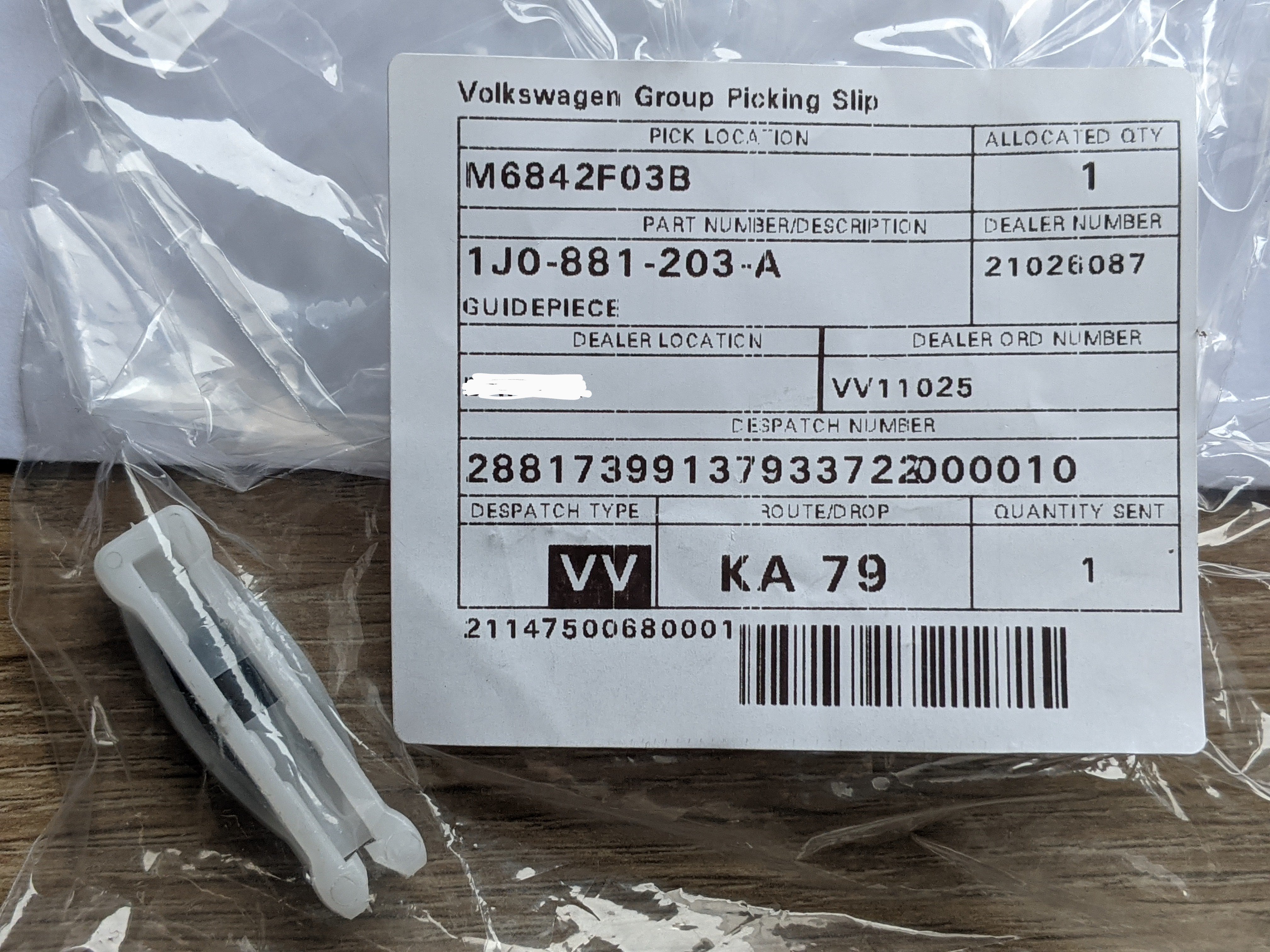

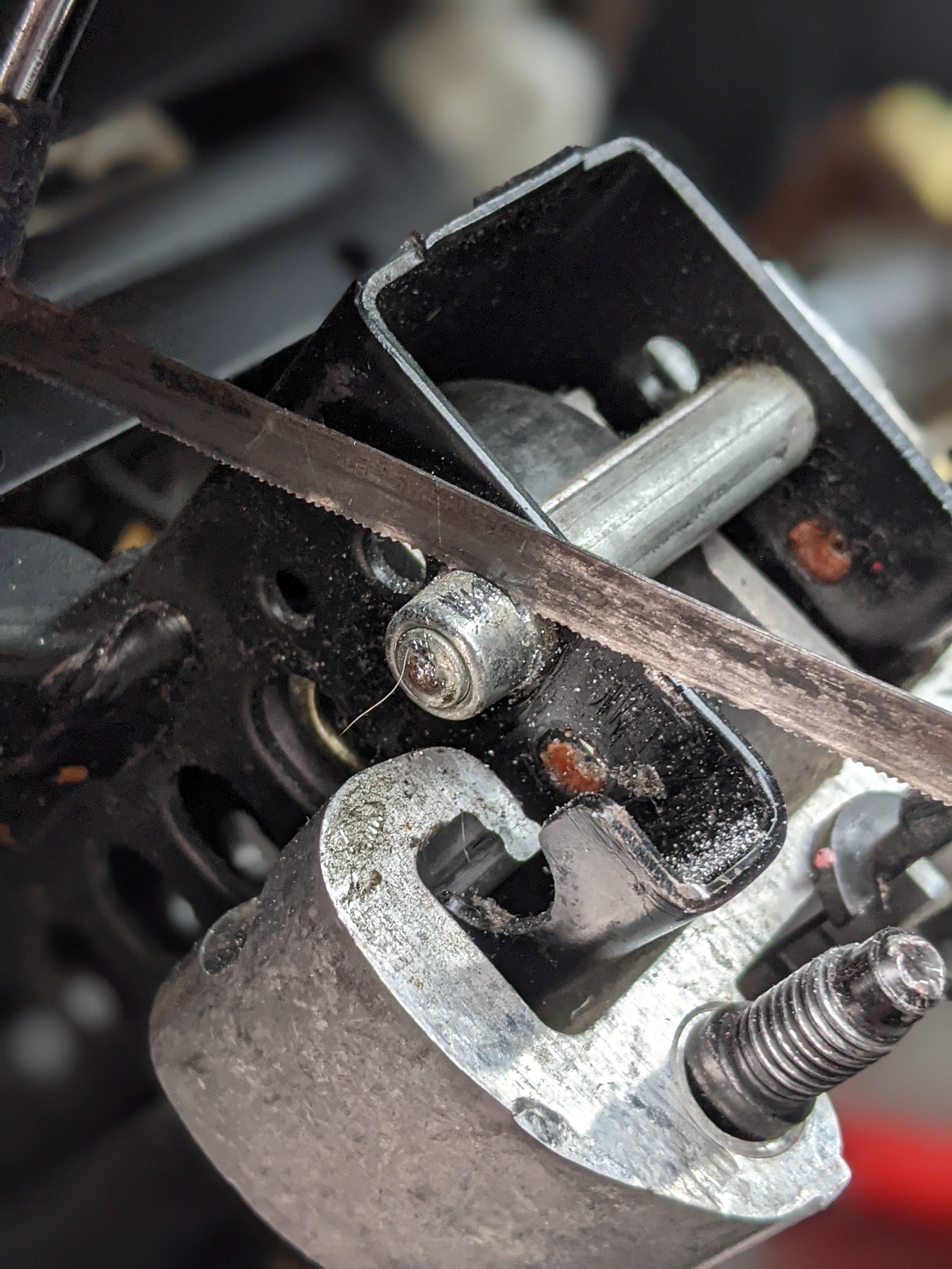

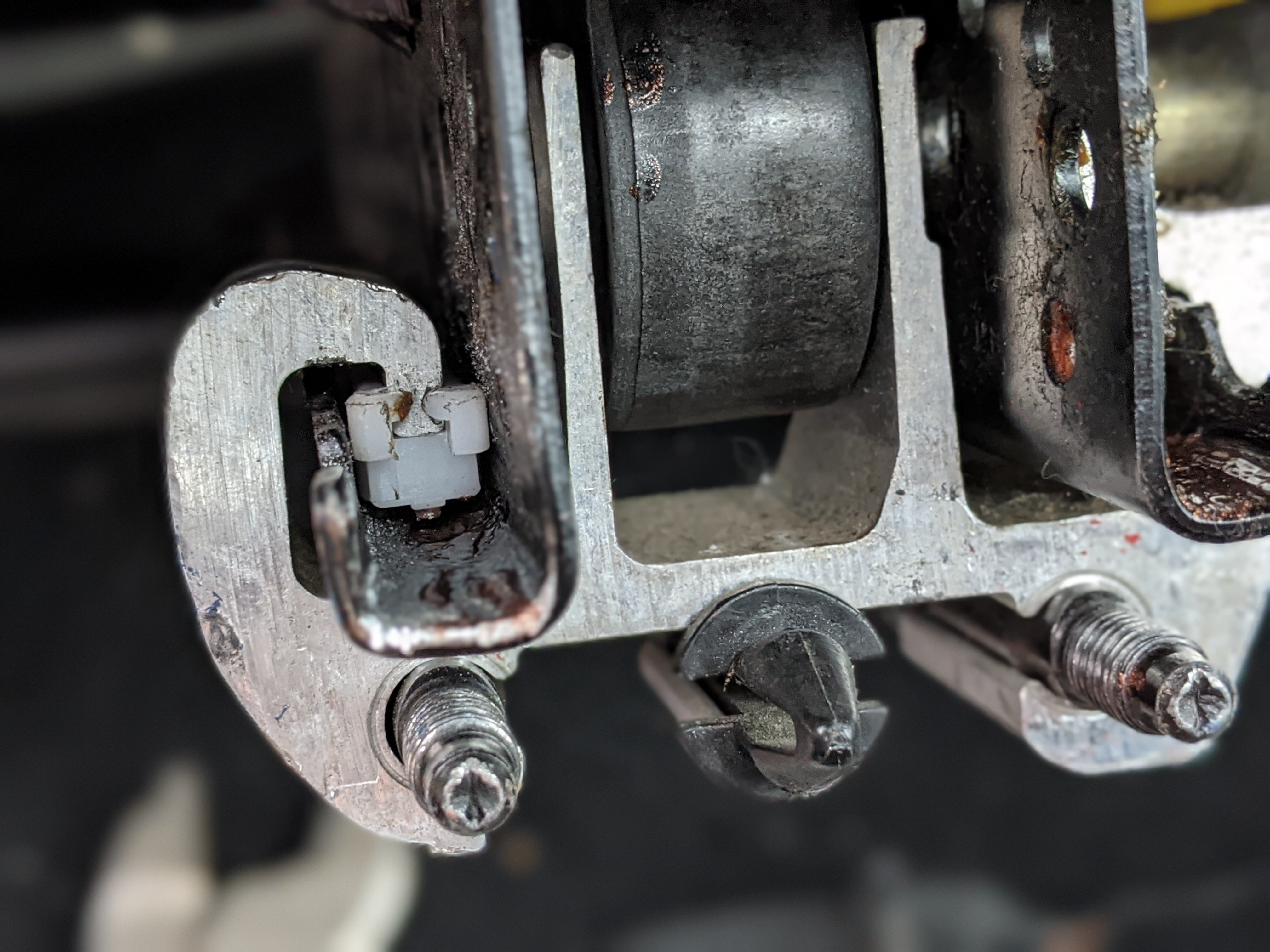

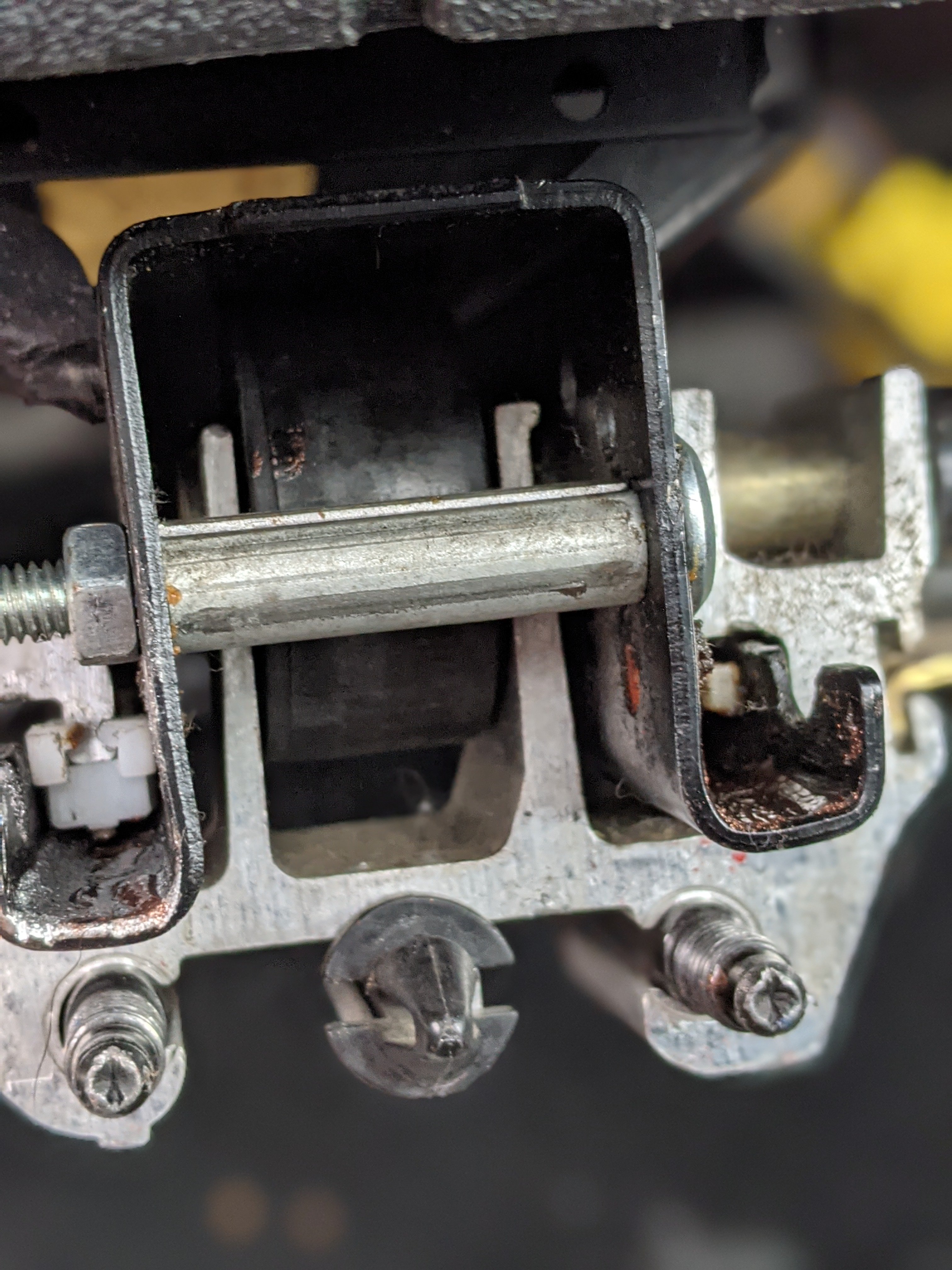

As some of you may have read in another thread, the seats weren't quite right.
The driver's seat had a small plastic part missing that allowed the seat to rock back by about 5mm.  It wasn't apparent until I fitted the seats and seeing as it was a 560 mile round trip to get them I wasn't going to bother the seller about it.  Initially I thought it was missing two pieces, in the end it was just one, the other was hidden behind a lot of grease and muck in the mechanism.
After a bit of help from Mr Evil I tracked down the part number and called our local VW garage.  The chap there is really good at helping me source parts for the Octavia and he managed to get hold of the clip within a day.
I decided to fit the part as I was getting annoyed by the movement in the seat .  First thing was to cut off the bolt that prevents the mechanism from sliding off the front of the guide rails.
I then slid the mechanism off the rails whilst holding the lever out to allow you to slide the seat back and forth.  The clip was installed with a dab of copper grease and then the mechanism went back on quite easily.
Luckily I'd ordered the right part and it went on perfectly.  I then had to replace the bolt I'd had to cut off and used my tin of 'things that might come in handy one day' to find a suitable replacement.  I'll cut it down to length when/if I get round to wiring up the heated seats.
The seat works perfectly, doesn't rock about and I can get on with enjoying the comfort of a nice set or Recaros.  So far they seem a lot nicer than the stock seats and even the kids have said that the rears are way more comfy so all's well.
Also, I'm impressed that it only took £1.92 to fix what was a really annoying fault.

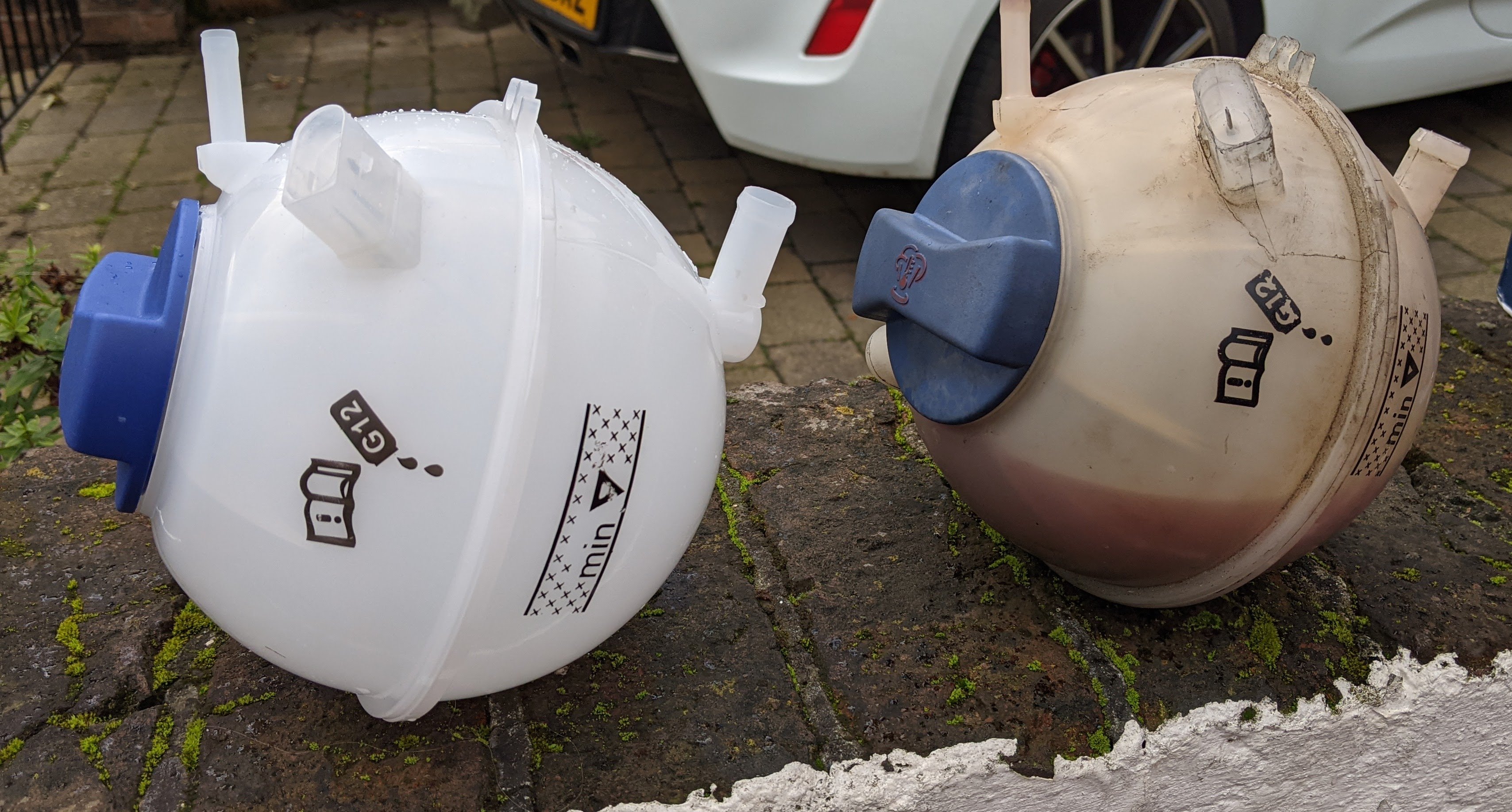

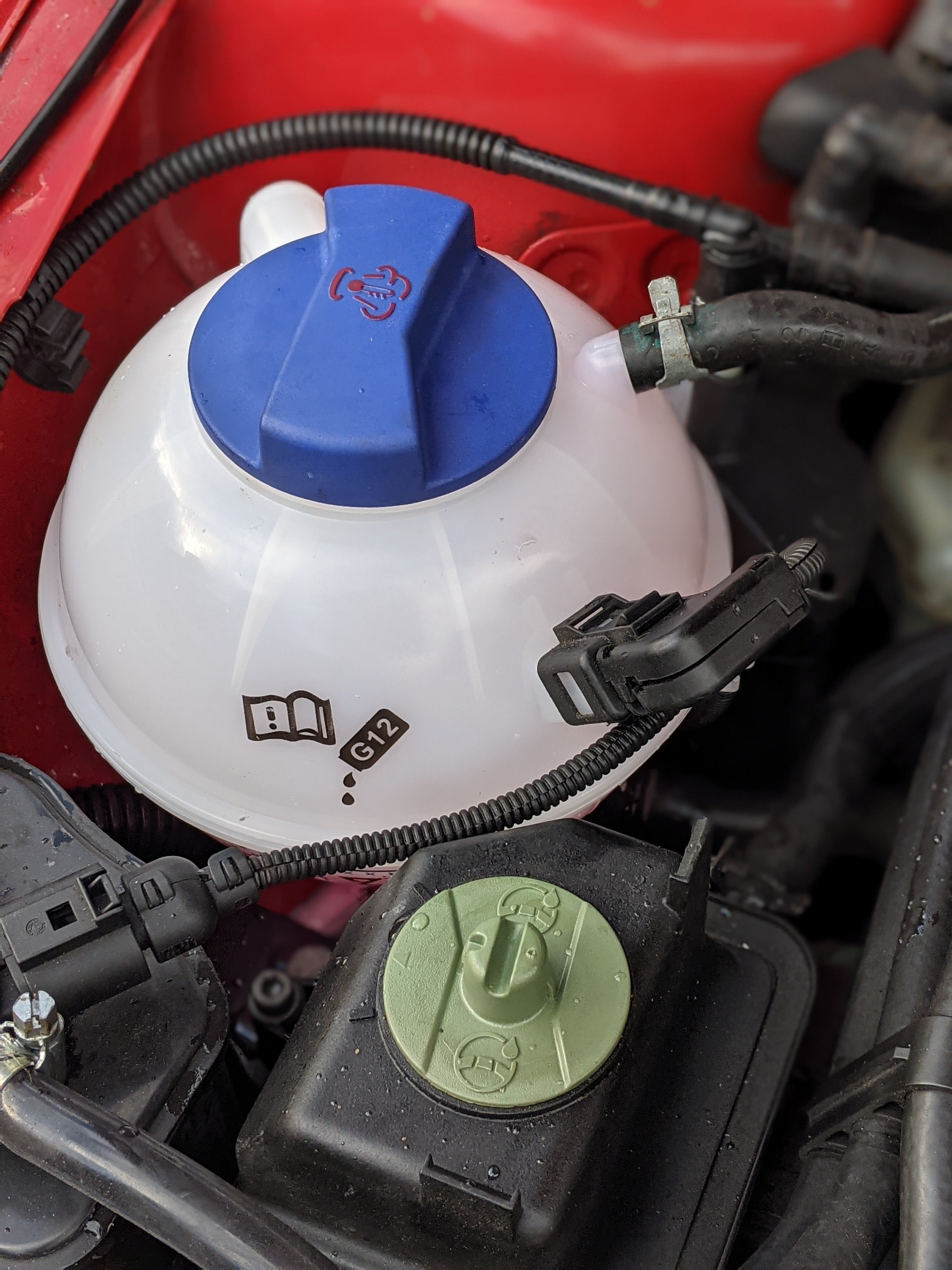

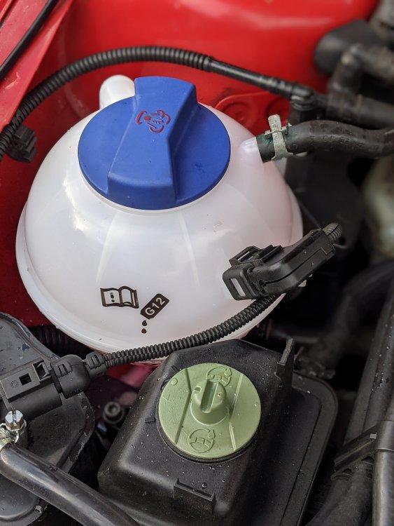

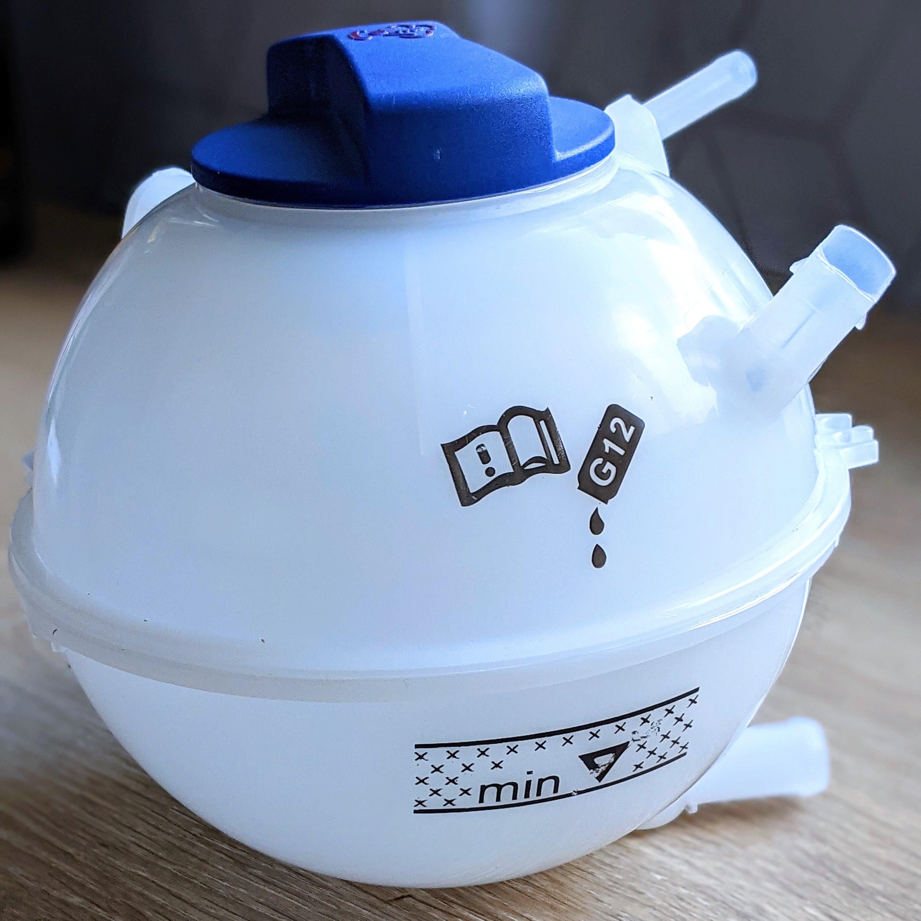

First was to replace the expansion bottle.  The old one was unsightly but also it had a few areas that looked like they were going brittle.  I ordered a Meyle pattern part which arrived today.
It was £15 from Ebay and seems to be just as good as the original in terms of plastics & build quality.
It's a five minute job to swap them over really so for a few pounds and a bit of fresh G12, it was worth it.

As you can see I also replaced the power steering fluid reservoir cap.  Again, small changes but it keeps me happy.

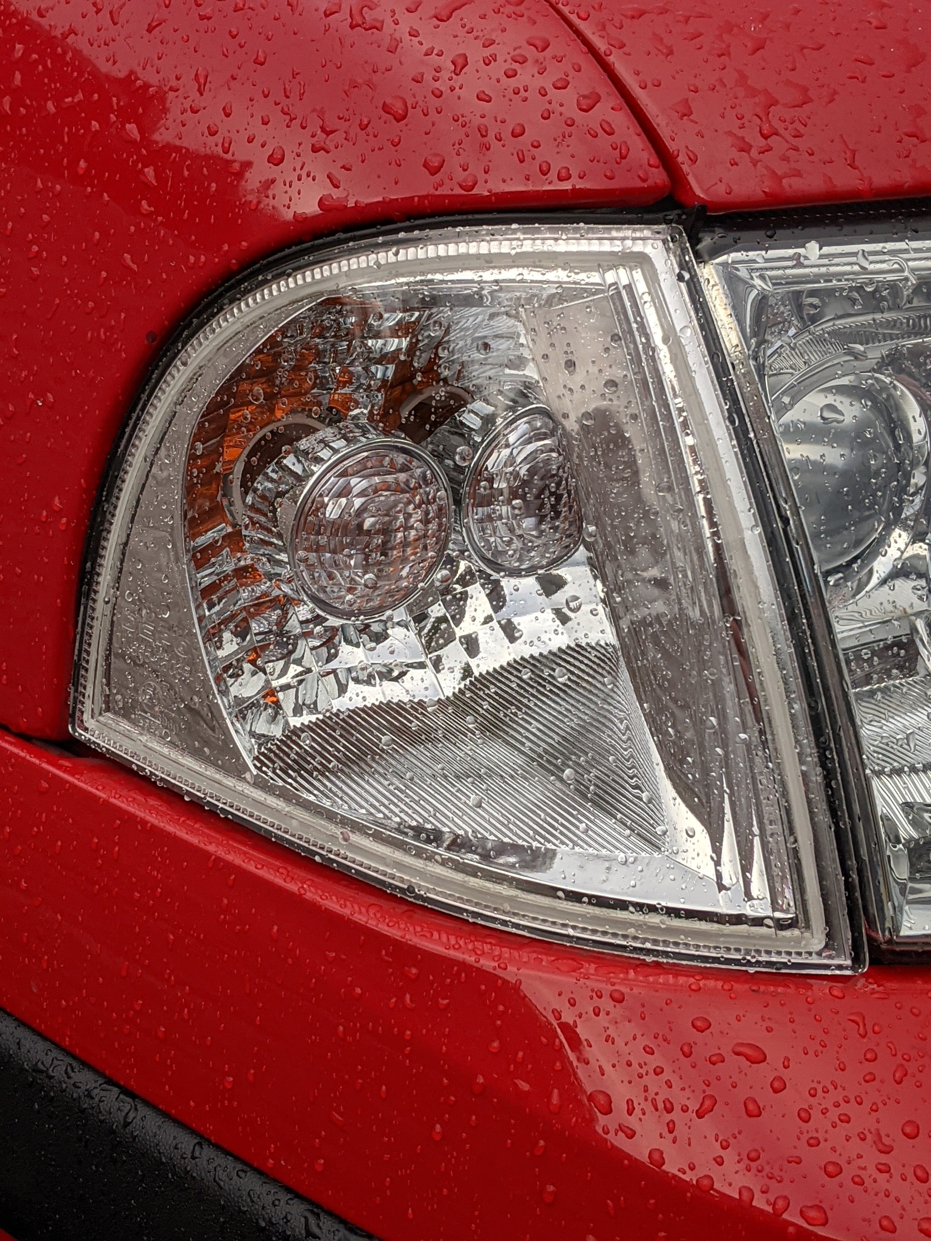

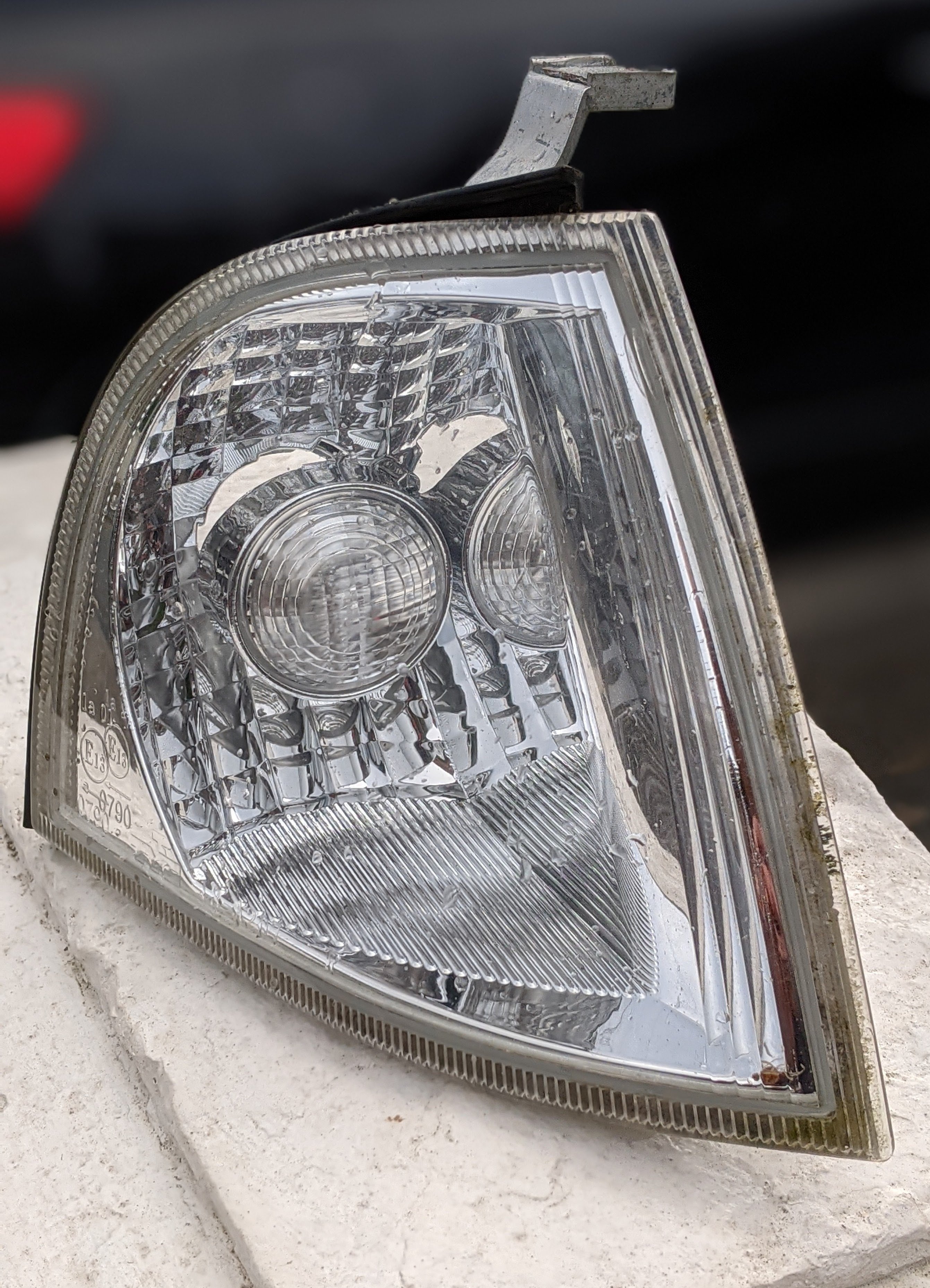

Next was to replace the offside indicator lens as it was going green.
This was a copy by the looks of it so I replaced it with an Ebay special.  I did the other side a year ago and it's been fine so I'm hoping this will be the same.

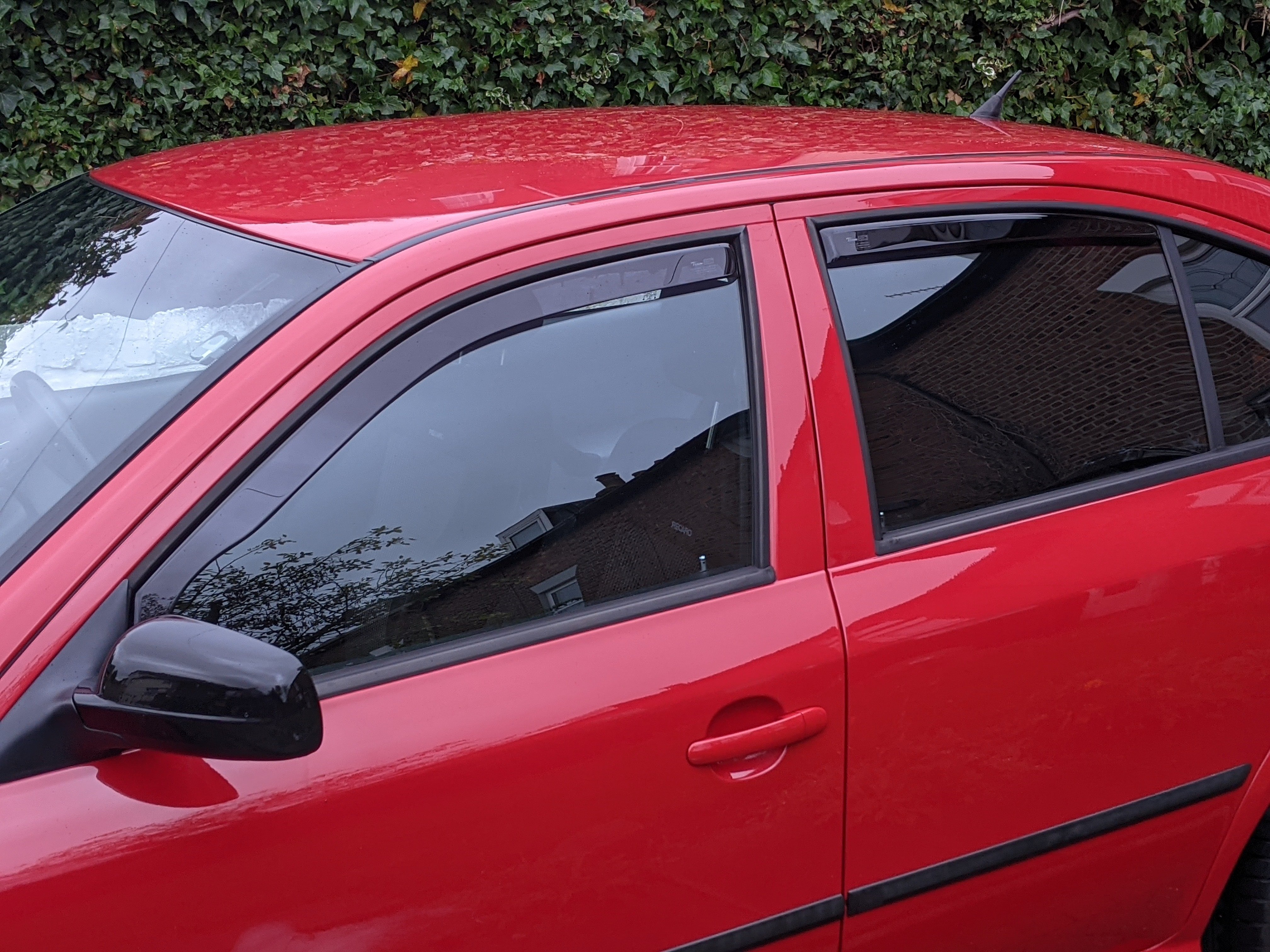

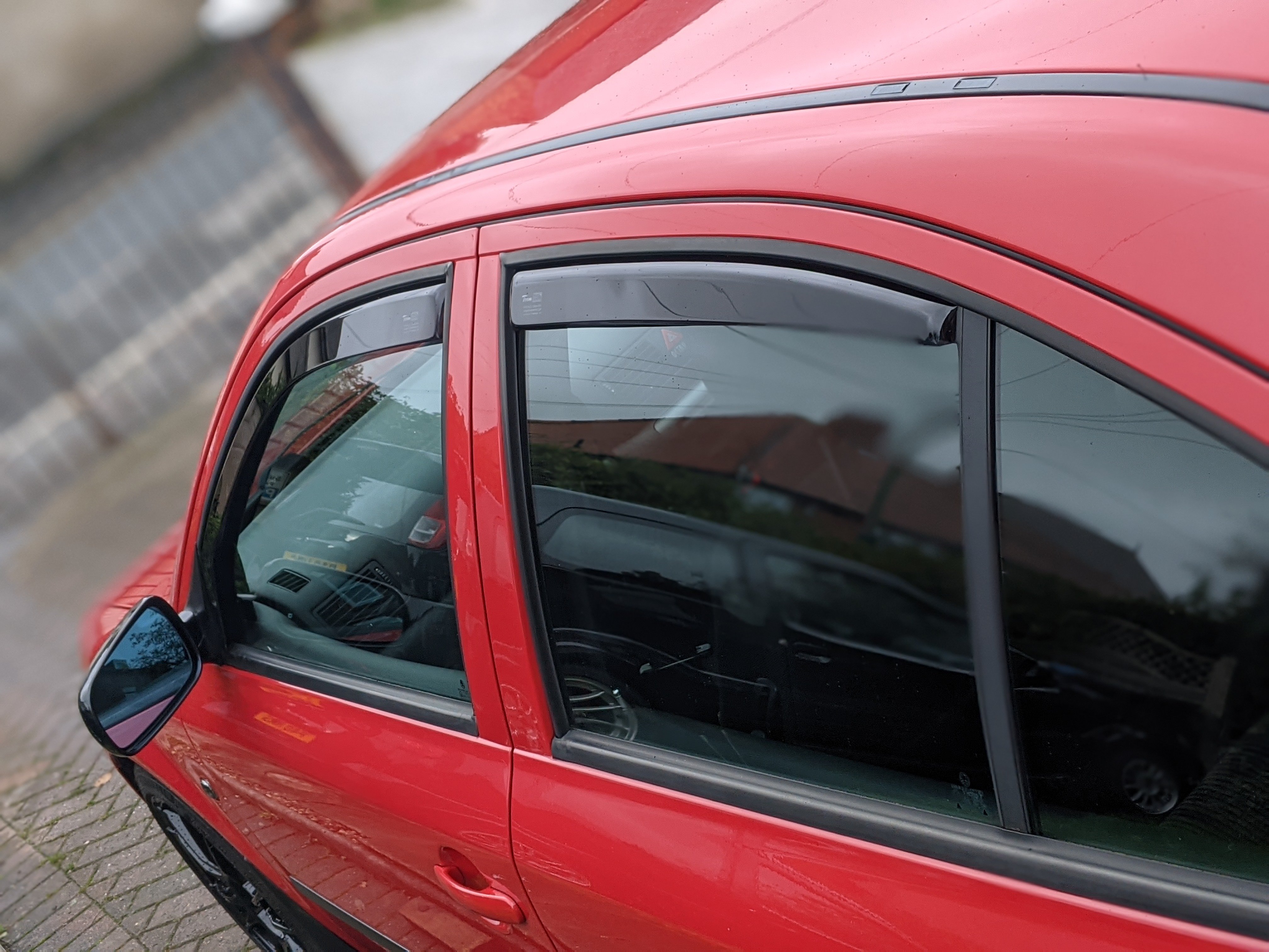

I said I wouldn't spend any more money on the car but it seems I can't help myself.
Occasionally the windows steam up at this time of year, usually when I've picked the kids up and they've been running around at one of their clubs.  It can make it difficult to see when reversing onto the drive in the dark, especially seeing as the rear windows have such a heavy tint.
I decided to get some wind deflectors to allow some air in whilst keeping the rain out to help with the issue.  I went for the Team Heko variant as I've had them before on other cars and they were a good fit.  The rears went in just fine but the fronts were a bit of a pain to wrestle into place.  I managed to not snap them (as I have in the past) and they fitted quite well.  Fingers crossed they'll help with the steaming up issue and are a worthwhile investment.

Looks class with them wind deflectors on them. They can really smarten a motor up. Team Heko's, I presume?
Yep.
I agree with you that they look quite smart once fitted, although I initially bought them to combat the steaming up issue.
Improving the look of the car is a bonus! 😄
