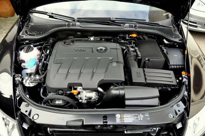

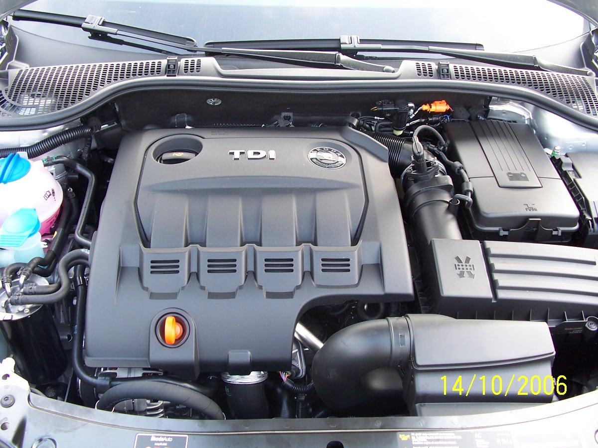

Here is a piccie of the PD cover:
And this is the CR cover

Added pictures of the covers, see above.
