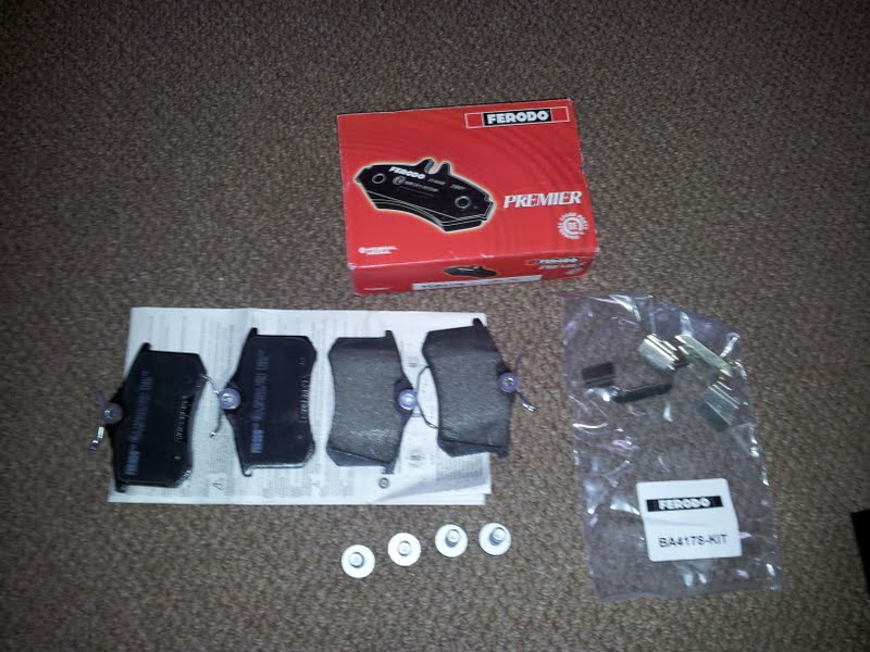

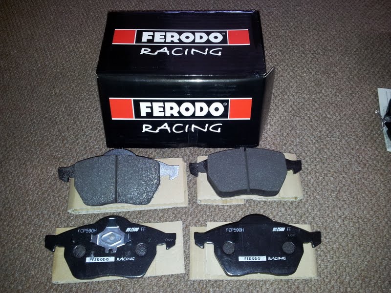

I have ordered brand new ones ehhhheeeeee :) Front EBC Ultimax with Ferodo DS2500 pads and back EBC basic dics with Ferodo pads. I hope I made the right choice this time.....

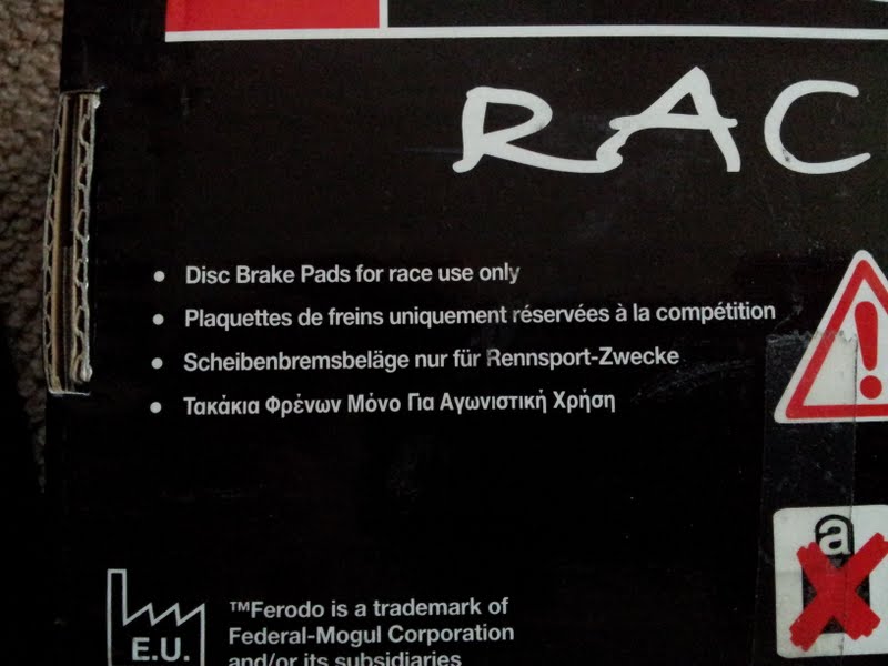

I received pads today :thumbup: .just waiting now for discs....
it says on box for race use only lol :bandit:
i put those up as well when i receive them

It was discussed a while ago weather the DS2500 are legal for road use and someone mentioned a regulation (reg 90). http://www.briskoda.net/forums/topic/155594-ds2500-track-day-only-pads/ Before that thread a lot of people used them with good results.
I'm guessing you have different callipers to standard as the fronts pads don't look like mine at all.
If they r good for racing they will `perform` on the road as well :)
I have the 312 front and 256 rear
is it okay and safe to use them??
Loads of people have used DS2500 pads on the road with good results.
It safe (safer) to use them, but they are not road legal.
The problem is that the EU introduced a rule that stated that the friction coefficient must be within 15% of the OE pads. This was to stop poor quality pads being sold. Unfortunately, better pads with a friction coefficient of OEM+15% also fall foul of reg 90 so are not road legal.
