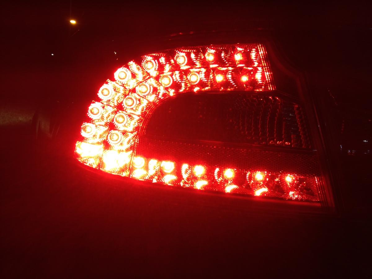

Hey all,
My LED rear lights (from new L&K Hatch) finally came in to the dealers on thursday, (after ordering them in mid Feb).
Dropped car in to have them fitted, and I think they look GREAT. (if maybe a bit overly bright, am waiting to see if the police will have any issues with them down the road).
The problem is that the dealer has no idea how to get rid of the fault warning on the dash. I have read elsewhere on here that the computer setting (code) should be changed to that of the Mk 5 Golf GTi, and informed the dealer of this. However, they told me that means nothing to them. They say when they plug the car in, they get a list of setting listed as Octavia vRS - Superb Elegance - etc, or a list of code numbers, they have no way of knowing what the setting or code for the Golf should be.
So I am hoping that some one of you guys or girls might be able to let me know what should be changed and what it should be change 2?
Cheers in advance for any help
Bryan
Lights LHS.MOV
Lights RHS.MOV

The problem you have is that the central electric ecu must have a code changed. When your dealer log on to your car and entering 09 central electric they can change to rear led lamps installed. If their VAS is up to date. Or if you know anyone with a vagcom it's done in 5 min. The blinking of your taillights is because the car is sending out the power to the bulbs in pulses.
Regards Sverre

Many thanks for your reply, unfortunately I dont know anybody with a vagcom, So I will print out your information and bring it to the Dealers and hope that they will understand what your are explaining above.
The lights are not actually blinking, this is just the way they have shown up in the videos. This seems to happen when video most LED's.
Cheers again
Bryan
