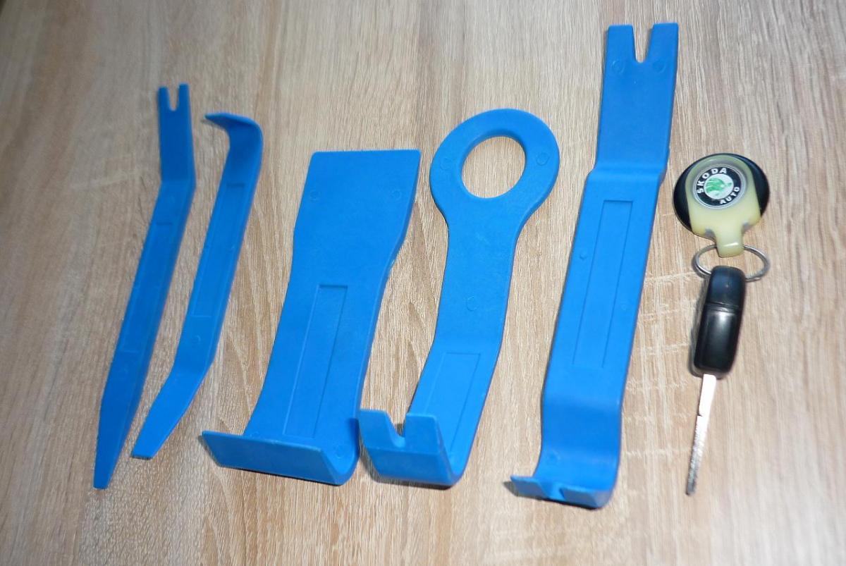

Have had opportunity to use removal tool set from Biltema (borrowed from my friend)- was quite (but not more than quite) useful:

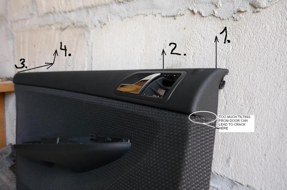

Door card removal:
Don't tilt card too far from door- just clip it out from window handle's shaft (if have this old-school option) and lift card vertically.
Here's sequence: lifting-up from front side > to midddle > then pull it a bit forward > a bit up again > card off.
Trick is in point "3"; in another way card's seal stucks against window seal in corner.
So, do it in correct and quick way- and don't try to save time with placing just lower part of card on rear seat... with risk of damaging something + very bad access (aha- a lot of videos where guys are drinking tea and doing job mega-quickly, and are very proud of it ;-)

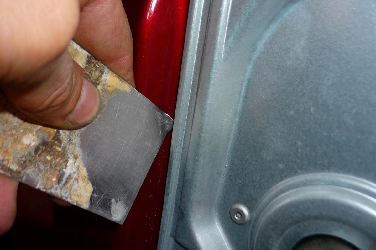

Re-sealing:

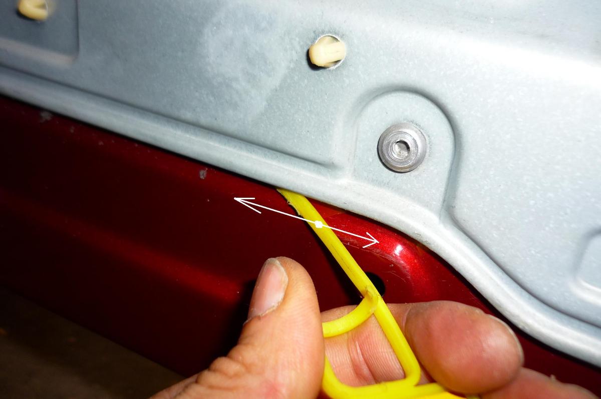

Before job promised myself to not search for problems and made re-sealing without taking-off of carrier.
Think, here's start of some posted problems when after re-sealing carrier is leaking again (in next day or after few years...think, that's too much too fast anyway):
 old guy Sponge Bob (=foam seal) wasn't perfectly cleaned-out from gap...

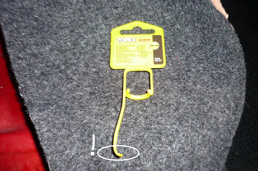

Oh, man... it took me 90% of time to clean those damn gaps (bad access, foam with old glue and it stucks in gap all the time).
I used metal sheet to cut-out most of foam (be careful with paint! ok, a bit of carrier's zinc was damaged, in gap...);
then with plastic hook forth-and-back > some compressed air > some whitespirit...

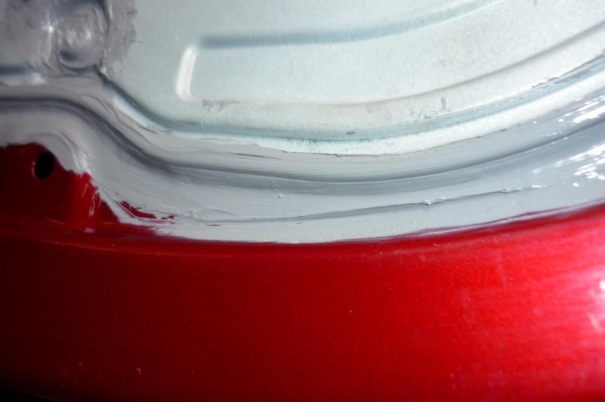

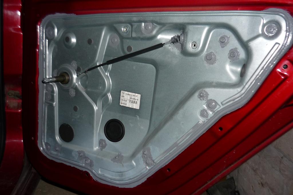

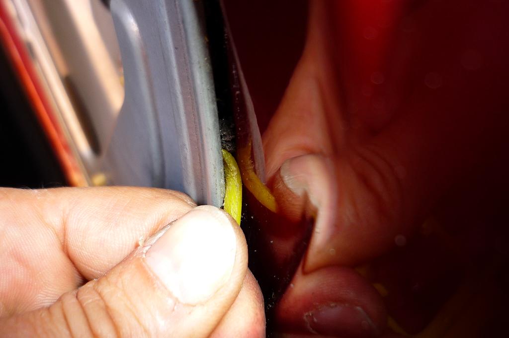

...and only then- applying of sealant (I used Soudal Fix-All Classic):
And no matter how many sealant is outside of gap...it just looks funny on posted photos later- but how many sealant is in gap?
Re-sealed rivets and end of plastic clips in carrier, too- there were traces of dried water on almost all of them.
