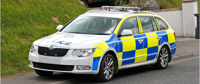

Best answer - put blue and yellow overlay on it - but sometimes other people in similar cars take exception.
OK, Dingo: "put headlights on." Then everyone thinks "aggressive b***d I'll stay in front of him he's not passing me"

BTW, the blue and yellow battenburg makes no difference. If someone isn't looking, they do not see you...
