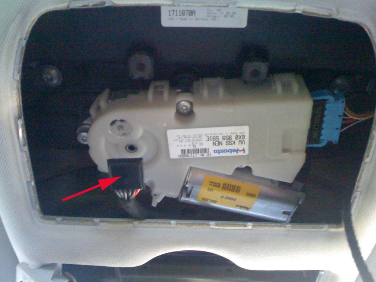

Hi there,
I've got an update, the garage i bought the car from have been great. Sent me a new VAG motor and bolts.-cant say fairer than that Now for another very basic question!
The blue plug connects straight into the motor. Then there is a black cable that comes attached to the motor. Anyone know what this connects to? Thanks

Is there nothing on the control unit itself that that fits into??
I too would have thought it connected back to the switch as it seems to be a short cable
i cant see anywhere on the sunroof switch panel or the alarm panel. Although this thread is asking for incredibly simple advice, i'm not too bad at car stuff would you believe.
I haven't got a sunroof so can't help much more, sorry.
If you take out the interior light / sunroof switch panel is there nothing obvious to connect it to?
Found it, second plug goes into the back of the round position switch. obvious when its there! cheers
