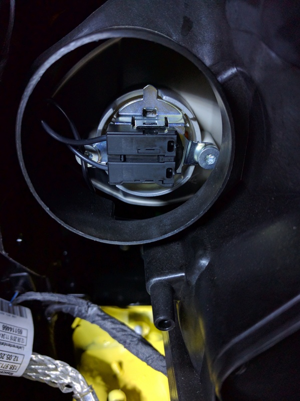

Just picked up our brand new Citigo - all new set up, with a string of LED lights at the bottom of the headlamp unit forming the sidelights and daylight running lights.
The sad news is that I thought I'd upgrade the standard headlamp bulbs to some better Philips Extreme or Osram Nightbreaker BUT - the low beam and the high beam are now separate units so I do not believe use H4 twin filament bulbs, and even worse, popping the rubber cover off the back to try and see what was fitted I discovered that it looks like whatever they are, are screwed in, with 'star' screws so god knows what they are - no wonder the new printed manual does not give any bulb references and suggest going to a specialist garage to change them!!
How many "star" screws in each lamp unit? The H4 bulb holders in the "early" Citigo have a T10 Torx screw to hold the bulb retaining spring in place.
For the main beam units there look like two, the low beam I can't see properly as it is set back and tight for space, I can see one but there may be more. Makes what would be tight job of unclipping an H4 fitting and replacing the bulb into something else!!
When I get a chance I will get out there with a mirror and try and take some pictures!
Edited by kaydee
They won't be screwed in I guarantee. The low beam is likely a h7 and the high beam a h1
This is the back of the main beam bulbpost-89242-0-60571700-1476105453_thumb.jpg
Sorry about the quality - not easy getting the phone in there to take them -!
Edited by kaydee
