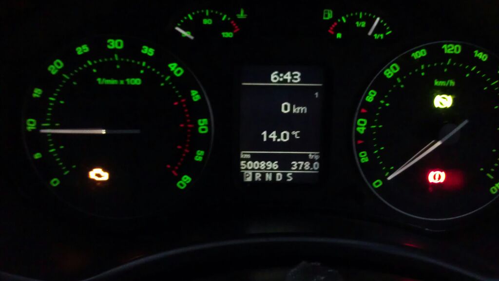

And just to shed some light on the topic, this morning my trusted BKD engine tipped over the 500,000km mark !!

Re the oil pump issues on 2L cars, Car Mechanics magazine had a feature about that very problem, can't remember if it was last month or the current issue.
They mentioned a VAG specialist who had run out of storage space for disabled taxis waiting on new pumps which were on back order. I think, from memory, the pumps were costing over £1000, perhaps that price included fitting.
The specialist was now fitting repaired, modified pumps as a much cheaper price.
Apparently the Trade are fully aware of the problems but continue to deal in these cars as they sell well!
Will post one up when I figure out how to do it using Tapatalk.
Do you doubt me, Mike :-) :-)
HTC Sensation XE using Tapatalk.

As requested!!
