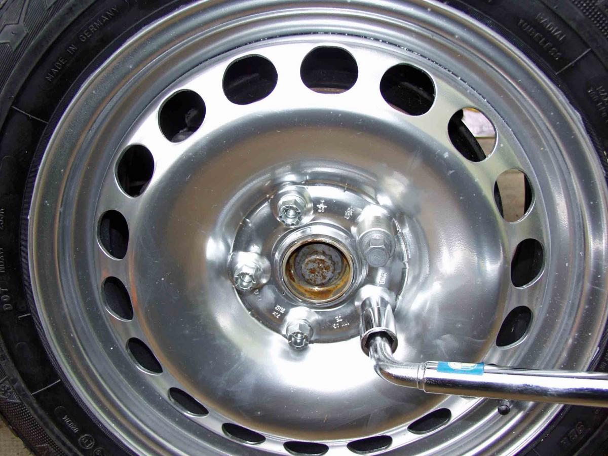

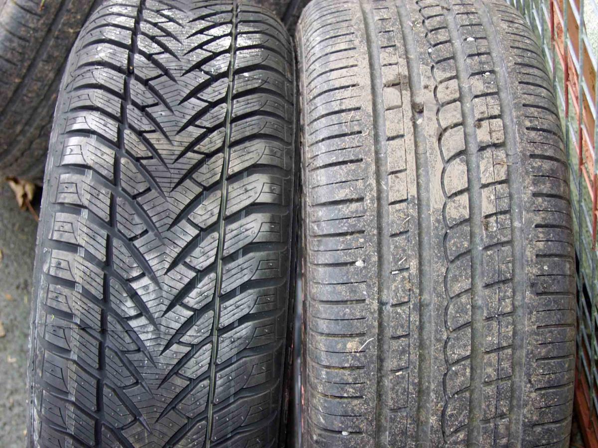

I have today just changed my standard wheels and tyres (they have only done 1,100 miles from new!) to my winter 16" steel wheels (now painted silver!) and Goodyear Eagle Ultra Grip 205/60/R16 - which are directional - I did remember to check when they arrived that I had two left and two right combination! I had wanted to buy the "puck" but did not get round to it so looked in my wood shed and found an oak off cut to some part of a stepped window frame. It fitted perfectly, the lower part under the sill and the inner part on the flat part underneath. On jacking up the load was equally shared by sill and inner floor. I did find that on the front jacking points it did just catch the RRP (mentioned by The Hood). I have no spare wheel, but you do get the nifty plastic tweezers for pulling the plastic wheel bolt covers off with! I have read the thread about the alignment screw-in headless bolts, but they really aren't necessary, if you are putting steel wheels on. The inner hub supports the wheel and you can slide it round to align for the wheel bolts. I used an extending wrench bought from a car parts shop. I keep it stowed on the two shopping bag hooks in the boot, with a couple of small bungees to hold it in place. tightened all wheel nuts an then torqued to 120Nm and lastly pumped tyres to 2.4bars. Job done.
Points to note: The jacking points are hard to find - have to lie on back and peer up to find the slightly raised black triangles.
The plastic wheel bolt covers can't be used on the steel wheels - have put in a plastic bag and put in under the floor with repair kit.
The centre of the wheels do look a bit bare, so may try and find a cover.
