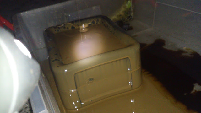

I found this at a small second-hand car garage and bought it 95,000 miles fresh. I suspected the headgasket had gone or was on its way out, since coolant was disappearing somehwere. Amusingly I can get the wing mirrors to vibrate along to death metal blast beats, without blowing the standard speakers.
After just over a month of ignoring most of the warning lights I finally decided to stop driving it after finding mayo on the dipstick and a more alarming shudder than usual at startup.
Going to fix it all this weekend, so I started after work yesterday by opening the sump and leaving it to drizzle out.

It did have a Temac HG, but for the oil it isn't immediately obvious where it had failed...
I could have got it cleaner, but I didn't want to risk scratching the head and didn't really have anything to get it spotless.
Did it up as per the Haynes manual, for better or worse. 200 miles and some, er, 'assertive' city gear changes and all the fluids remain nominal. Still got the oil warning light on but I didn't have time to clean the sensor or flush anything. It had sat for a few days with the sump plug out so the worst of it is definitely gone. It sounds and pulls much better now.
Still have the timing chain to do this weekend, so I will run some engine flush through it, re-seal the sump and fill with some 5W-40 fully synth. Ought to flush the coolant too, I'll use a dishwasher tablet. Never spend money when you don't have to!
