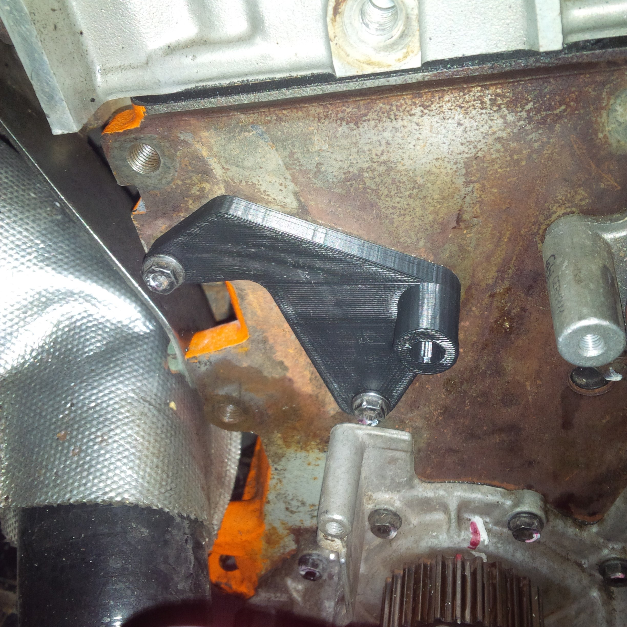

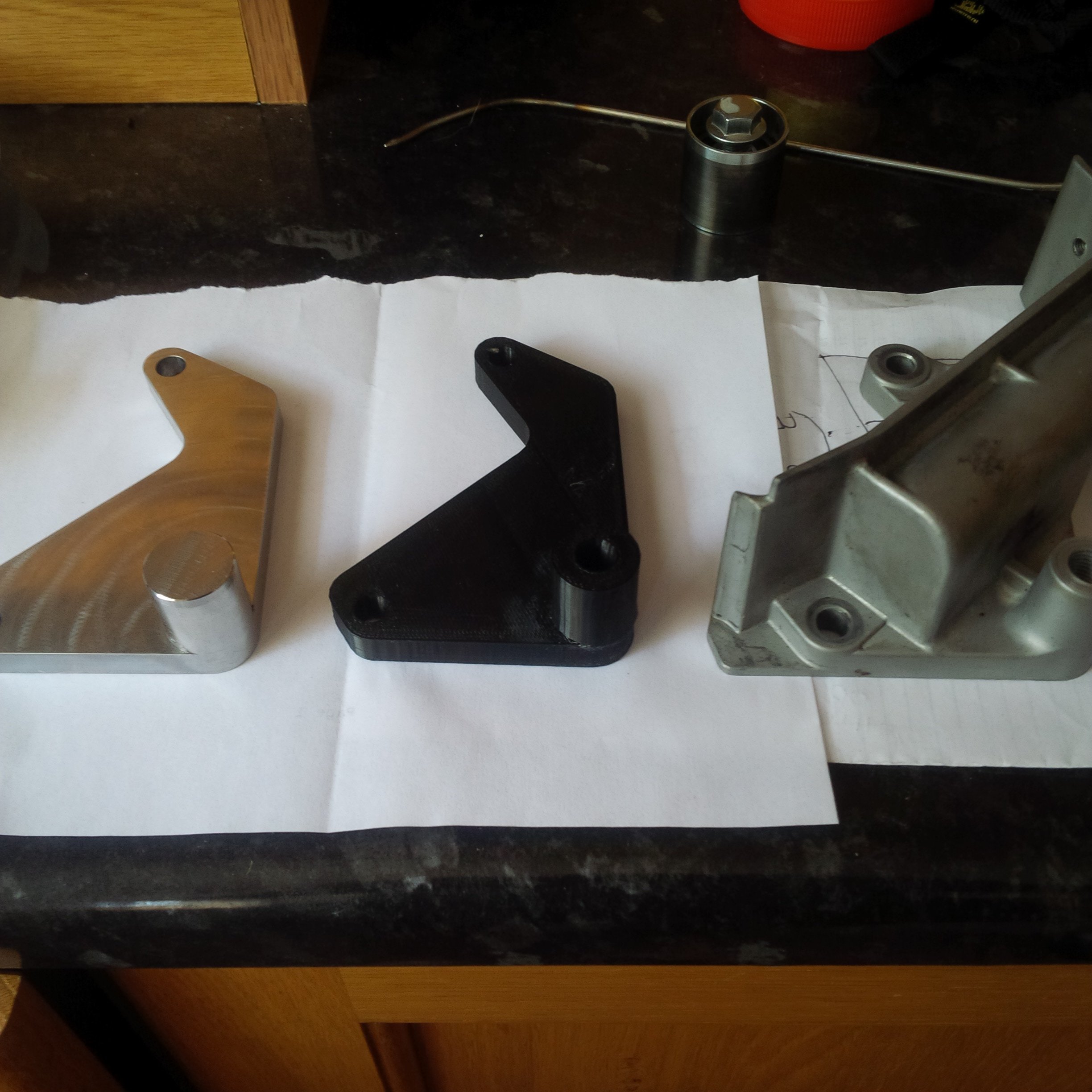

Anyway I'm making my own manual tensioner now. This is my idler 3d printed prototype

Comparison

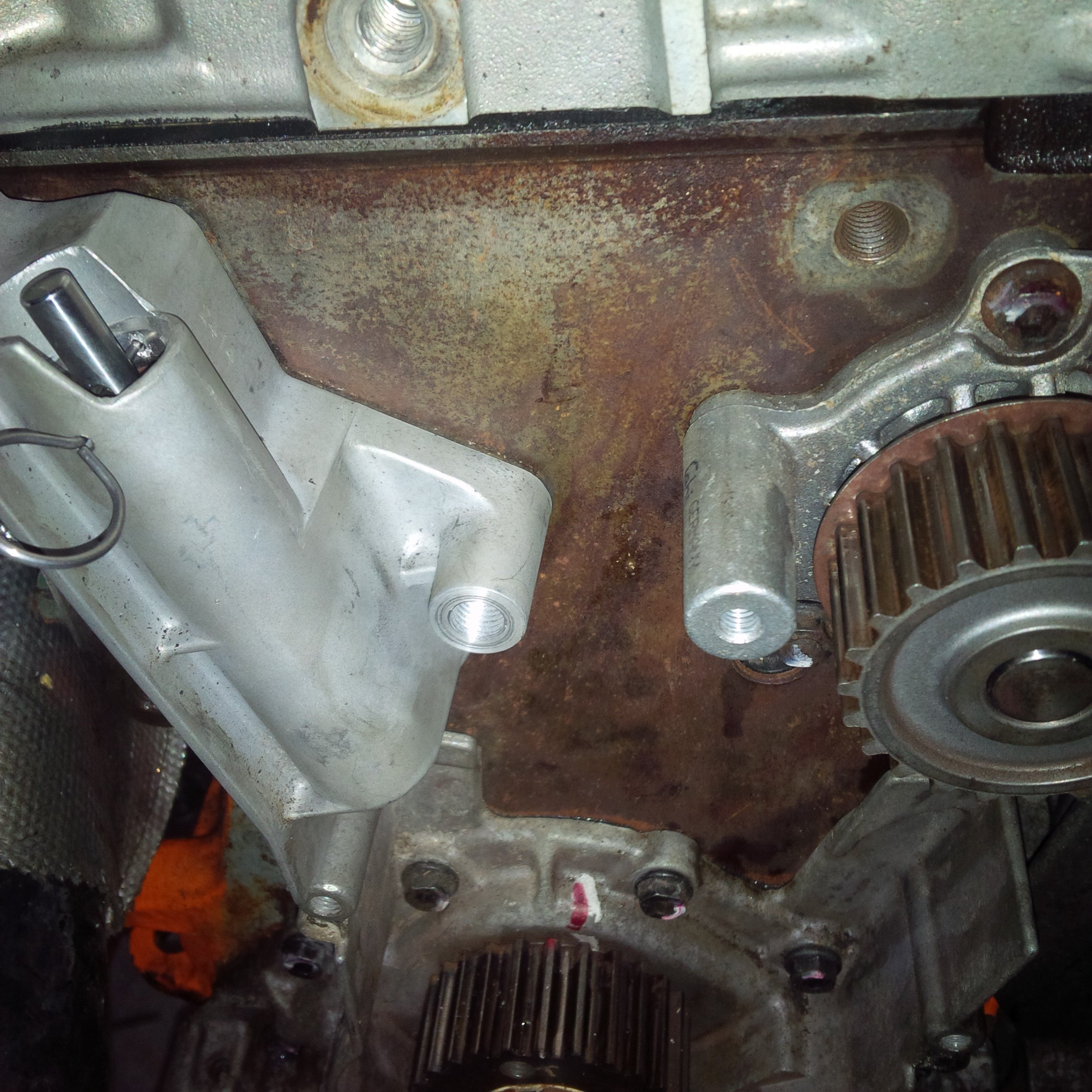

Cant you take material off the end of the tensioner ram, or does the arm that come off the pulley foul on the body around the tensioning ram.

Loads of people for the 1.8t have had issues with belt noise with the ina kit. I suggest an oem belt or better quality belt like dayco. Who cheaps out on something critical. Anyway it's to lower the compression to 8-1 as it was running way to hot with my hybrid and cocked valve guides on big boost. some design picture 3d print then ss

It won't allow any more slack as the tensioner cam lever hits the hydraulic tensioner body
