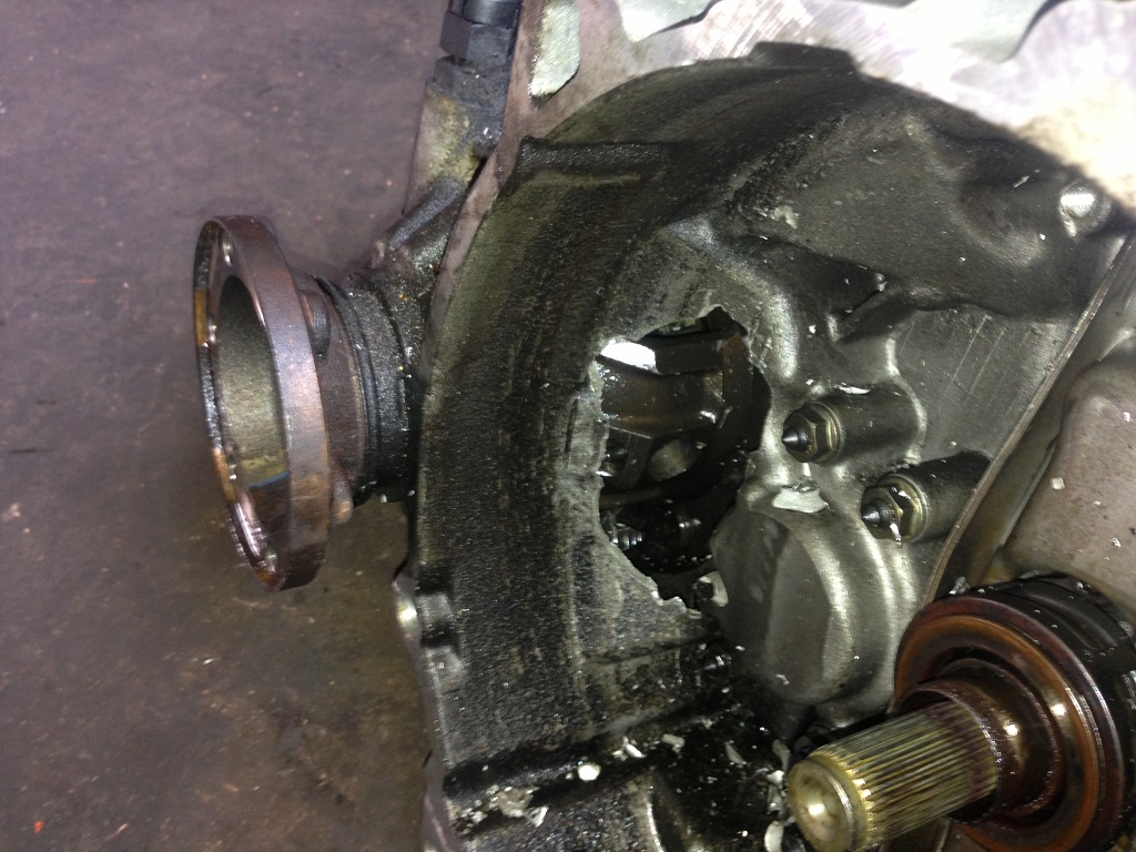

Was a little worried at first, as when started on the ramp and put into first gear there was some clunking.
It only seemed to do it in first gear and around 1200rpm and again around 2200rpm.
Anyway after letting the oil circulate around the box and checking I could get all gears, I took it for a test drive.

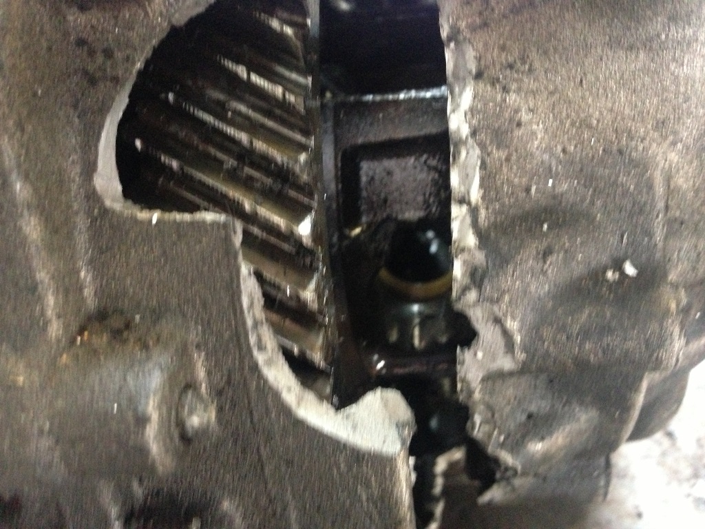

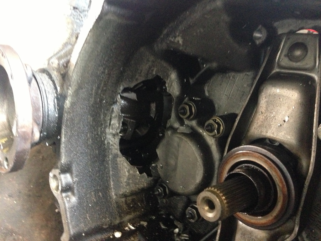

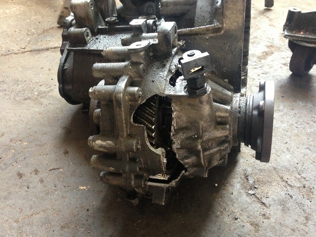

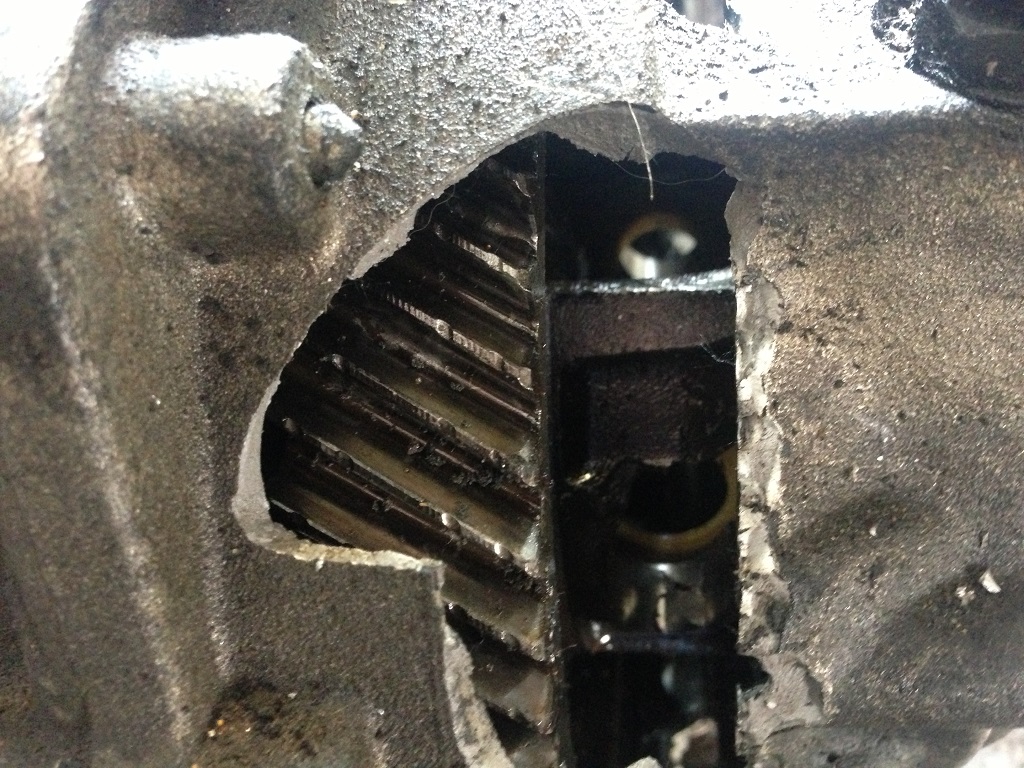

As soon as I got to about 40mph in 3rd, I heard a clunk and then something hitting the bottom of the car a few times, and then noticed something fly out the back.
I turned around and picked up a large chunk of gearbox.
The clunking in 1st gear seems to have gone now :D
I've only done 2 miles in the car, need to get an MOT on it tomorrow, and then do about another 28 miles (30 in total) and I will then dump the gearoil and fill up with new, to get rid of the assembly lube thats in there,
Then I just need to bed in the new clutch, adjust the gear linkages and maybe get the tracking done again as it doesn't seem to drive straight now that it's all been apart.
I think I had the most of out the old box lol.

It's late and I'm a little confused, how do you plan to do 28 miles in that gearbox lol? Is this the one with the new diff fitted or have I missed a post and that was a replacement!
The pics are of the old one, now it has been removed from the car.
Not alot of point taking pictures of the new gearbox with the wavetrac inside it, as it looks just like any other gearbox.
Well yeah of course I just got confused, thought this had happened to your new box, sorry!
If it had of happened to the new box, I would be posting pictures of my burned out car, not the broken gearbox lol
