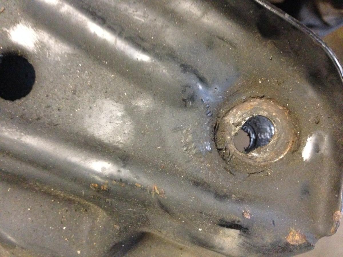

Basically one of the wishbone bolts came loose on track, which was causing the clonking that I could feel and hear.
After it was tightened up the noise went away, but the car remained pretty much un-driveable, as it was trying to drag me off the road (to the left) every time I put my foot down.
I replaced the front wishbone bush (the one that the bolt came loose on) with another new Powerflex Black Series bush, along with a new bolt and also new subframe bolts, but nothing changed, the car was still the same.
I then fitted the Silver Project top mounts and had the wheel alignment done, -1.5° per side, equal caster and toe set to 0.00 but the car still drove the same.
I then was told that 1 of the bolt holes for the rear bush on the subframe was slightly ovaled, and that might be causing a problem.
So I replaced the subframe, and fitted some 034 Motorsport solid bushes at the same time, but still nothing changed, when you drove it hard the car would pull hard left, and on changing gear it would dive right, and under braking, well I couldn't tell if the front and rear of the car were attached, it was THAT bad :@, it was also wheel spinning on cold / damp days but only the n/s wheel was loosing traction (even on the motorway, I thought the clutch was slipping at first until I loaded it up in 5th gear at 3500rpm and the rev's didn't shoot round even at 1.5bar boost).
Anyhow I spoke to a few people and everyone agreed that the Wavetrac had to be faulty, so I emailed Wavetrac to see if they could give me any idea's of what to check, they suggested I check the stub axles were tight in the gearbox and also said to pop them out and check for any obvous signs of damage inside. I did this, but found nothing wrong, even the pressure springs on the stub axles seemed to be in good condition.
I emailed Wavetrac back again and they suggested that I contacted Regal Autosport as they are there uk distributor and all warranty claims should go via them.
So I fired an email over to Regal at the beginning of December (I bought the diff from them anyway at Inters in July), explaining the problem, and that pretty much everything had been removed, checked and / or replaced.
They said they would like me to take the car to them, so they could check it over, I replied saying no problem, but as they are over 100 miles away, i'd like to know if there was a charge, they replied very quickly to tell me it would normally cost £380 but in this instance they would check the car over for just £72.
So I then asked what they would be checking for my £72, the reply was that they would check over my suspension for me, I replied back to them and said thats fine, but as it has been done by 2 garages and also myself and most items replaced already I wasn't happy to pay them £72 to do the same thing again.
I then asked them that if I paid the £72 and they agreed that the diff was at fault, would they be covering the labour charges or is that down to me, they very quickly replied with a link to the Wavetrac warranty info which states that only the diff is covered, and no labour, and therefore they would charge there normal labour rates.
I explained that in that case i'd rather put the £72 towards the labour costs of removing the gearbox, and stripping it down to remove the diff, and with the petrol money i'd save, I would send them the diff in the post.
They wanted to know how soon this would happen, so I explained it would be next year now.
Anyhow I sold my daily runabout a few days later, and as I was down to just 1 car again, and with xmas coming, I felt that it made sense to get the wheel alignment done again, as I didn't want to ruin a set of tyres for no reason as I was going to have to drive the car for now.
So I took it in to get the alignment done again, however this time, the camber was all over the place, the top mounts were still set as before (max camber), but I had pushed both ball joints fully in (min camber) after the subframe was swapped over as I felt this would be best to keep everything equal.
Anyway everything was way out, but the car still drove in a straight line on light throttle for some reason.
The camber on the n/s was -2° but only -0.5° on the o/s, the toe was way out also but the caster was still pretty equal.
Anyhow after lots of messing about, including moving the subframe over, the best that could be achieved was -1° 18 minutes per side, with the toe set to 0.00, to get this the n/s ball joint was fully in (min camber) and the n/s top mount set to fully out (min camber), and the o/s ball joint fully out (max camber) and o/s top mount fully in (max camber).
Needless to say I was very confused, and a little annoyed that I can't get -1.5° of camber again.
BUT....
On the way home the car was FAR more stable, it was still drifting left under throttle, but it was very gentle and wasn't trying to drag me off the road anymore, it also wasn't diving right when changing gear and the rear is now connected to the car even under heavy braking again.
Very very odd and bizarre as the wheel alignment has always been done at the same place, with the same equipment but with very different results.
Still today I got a chance to take the car on a drive and i've managed over 100 miles today without it trying to kill me once :whew::rofl::rock:
So now I'm feeling much happier with the car, and over the next couple of months I now plan to finally get the rear arb's swapped over, remove the sound deadening from the floor, and also findout where it's letting water in as a few days ago the passenger footwell in the rear was full of water but it was against the transmission tunnel where the water had collected, the area by the doors was dry lol.
This is how bad the old subframe hole was ovaled.
