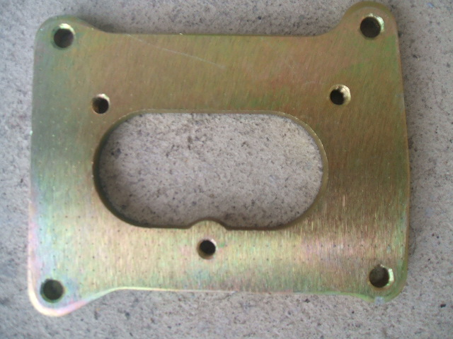

I have finally bought the "carburetor support metal" for $13.00 and it looks exactly like the photo.
The metalic gasket has two sides one with the inscription VIKA and a code number, this part looks to me absolutely flat and the other side is dented with tiny holes, this part is completely flat too, and my question at this point is:
<do I still have to sand both sides or which side?> <What number of sandpaper do you recommend?>

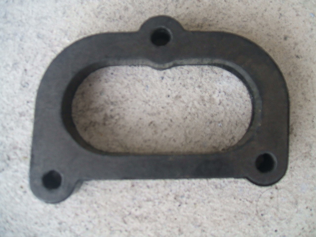

Regarding the other black gasket which looks to me made of mica and with a kind of paper-like sides, it looks flat too, and if I sand it, I'm afraid I could damage the very thin paper-like layer. Do I have to sand it too?
What is the secuence of assembling? What comes first?
There is a paper gasket, where should it be placed? Should I use a gasket sealer?

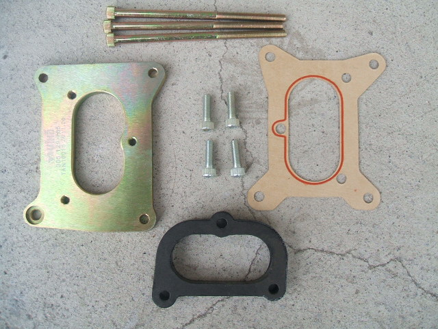

Don't sand anything yet.
Installation order is: cardboard gasket, metal plate with 4 Allen screws, black plastic spacer, carburettor with 3 long Allen screws.
Degrease metallic mating surfaces with carburettor cleaner.
Torque all Allen screws at 8 Nm, not more.

1) Before installing anything: clean very well the threads of bolts and holes. I used carburettor cleaner. Apply a very thin film of grease on bolt threads. Tighten bolts by hand all the way. We do that to verify threads are good. Do that for the 4 short bolts and 4 holes in manifold and also for the 3 long bolts and 3 holes in metal plate.
2) Clean manifold surface with carburettor cleaner. Wipe with a clean rag.
3) Put cardboard gasket. Align holes.
4) Clean metal plate both sides (see point 2)
5) Put metal plate over cardboard gasket. Align holes.
6) Insert and tighten 4 bolts by hand all the way in a cross pattern (see photo below) Check that metal plate is seated properly all around..
7) Using an Allen key, tighten the bolts 1 turn at a time in a cross pattern. You'll feel when to stop if you think "I don't want to break a bolt in the manifold hole."
8) Put plastic spacer over metallic plate. Align holes.
9) Clean carburettor base (see point 2)
10) Insert 3 long bolts through carburettor and install carburettor over plastic gasket. Screw by hand the 3 bolts all the way. Check that carburettor is seated properly all around.
11) Using an Allen key, tighten the bolts half turn at a time in order (see photo below). You'll feel when to stop if you think "I don't want to strip the thread of the bolts."
12) Job done. Enjoy. Beer brake.
