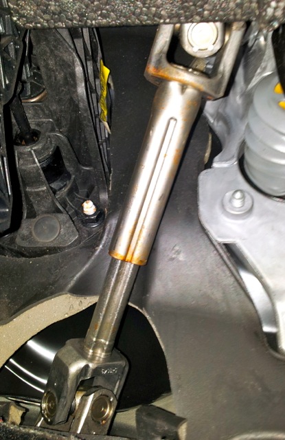

The forward/back position of the adjustment is implemented as two tubes with an interlocking indent in them. One tube slides inside the other.
The official fix is to replace the column, but it is possible to put a rod in the indent and use a vice/press to tighten up the interlock.

It's not too difficult to get the column out.
Get down into the foot well and see what part of the column has play in it. Start from the bottom and work up.

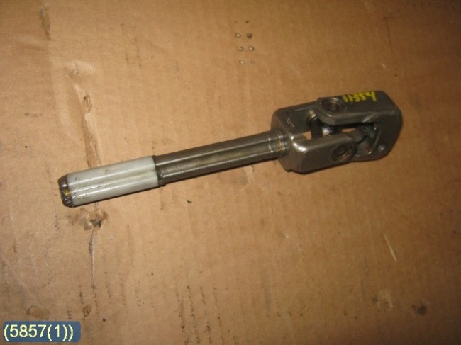

You might have what I have. About 10mm play in the steering wheel. This is caused by the sliding joint at the bottom of the steering column. Inside it there's some plastic or epoxy kinda stuff that must have been damaged or for some other reason is no longer there.
Stupid thing is you can't but just that joint - you have to buy the whole column ($960 here).
