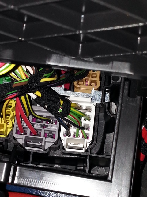

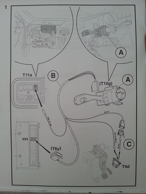

 I wan't able to use connector T11a because it simply didn't exist on my car. The instructions supplied with the kit stated this was the only option to use. See image:
All my car had was the 7 connectors to the right of the connectors shown in the instrcutions. Picture below showing most of the connectors. Red one just visable:
So i used the other set of instructiones (image below) that seem to be supplied with some kits that use the red plug (t11b and pin6 on this plug was vacant.) and put the white wire into it.
Does any one know why I didn't have the plug set up to the left? IE: The one with the T11A.
