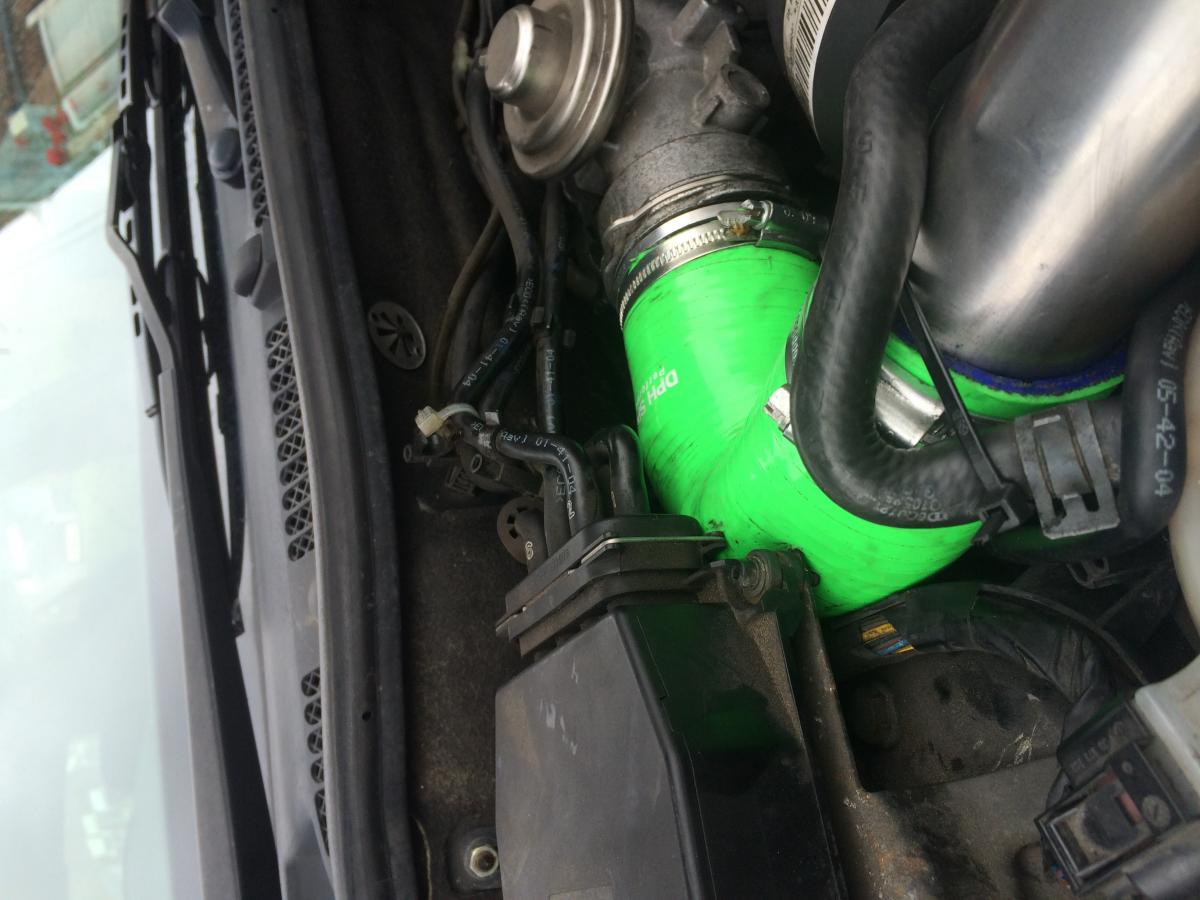

I've made the boost pipe kit following the original post and also some of the most recent posts
Only difference from the first post is that I've used a 70degree bend other than that I've used all the bits mentioned in the first post
The only issue I've got is the little black box which is on the left hand side is squashing the 90 degree bend pipe
I've seen some pics on here and the little black box is no where near the silicone piping
Just wondering if anyone know whats the crack with mine
Cut down the green bend if you can to make clearance. Otherwise you're looking at wearing away the bend and making a hole.
AS above cut pipe down,do it sooner rather than later,as these engines have quite a bit of movement in use and it will soon knacker that pipe :)
That will wear away quite quickly. I had to take a fair bit off mine to get it to clear it.
If I remember correctly the standard 90degree bend which was on before I removed it, never touched the black box
Isit worth getting a pipe similar size the to standard one
Thats because the standard one had a shorter straight piece after bend.
Just get a nice new blade in your stanley knife and cut down your silicone one :)

No, it it needs cut. I took loads of my ASH hoses to get it to fit.
Use a jubilee/mikalor cip as a guide on the silicone and knife it
