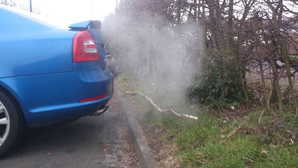

You could try seafoam, heres a DIY of someone doing it on their golf
Ive tried seafoam and I didn't get as much smoke as anybody on YouTube, this is as good as it gets and only lasted 10 seconds ish. It was quite dangerous though at one point it was back firing up the tube out of the funnel and into my face.
