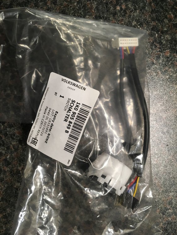

Good morning folks. Got correct diagnosis, and new ignition switch in hand.

Got the part referred to as VAG ignition switch 1K0905849B, disconnected battery, removed covers by unclicking the upper part of the steering column cover from the lower to reveal two torx screws (think they were T25) either side of steering wheel (turn wheel to access - noting key needs to be in to release steering lock). Removed the one recessed torx (T25) on underside of cover next to adjustment lever & removed the two torx (T30) on steering column adjustment handle to get it out of the way. Pulled off cover.
Located the back of the ignition switch, removed sticker & black plastic cover from switch to reveal the tags you need to put a screw driver in to release (you can work out what needs to be done by studying the locking tabs on the new switch). I used a couple of small panel pin nails as there wasn't much room. Switch was a bit fiddly to remove & unplug, but it came off in the end.
New switch in, all back together & 1 week later still running sweet.
In total, about 15 or 20 minute job & £12 for the switch.
